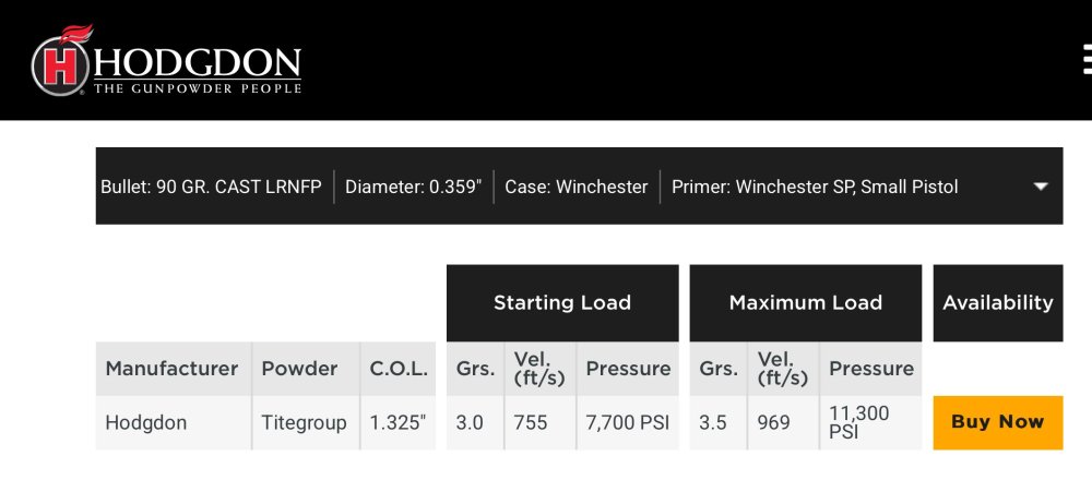

Tall John Posted February 6, 2025 Posted February 6, 2025 Capt. Baylor’s article in the chronicle about these 97 grain hollow based bullets intrigued me enough to order some as i want to learn how to shoot in the gunfighter class at some point. Figured a lighter bullet might be worth trying. I usually shoot 125grn or 147grn bullets over 3.2grn of TiteGroup at 1.47-1.150 OAL. Capt’s tests were with 3.6grn of Shooters world Cleanshot. I’ve not used cleanshot nor have I loaded really lightweight bullets. The article references that 2.0grns reach the “60 Power Factor”but the reference seemed to be somewhat anectdotal. Mike at Procast mentioned 2.3 grains but wasn’t totally sure. Hogdon recommends 3.0-3.6grn for a 90gr LRNFP Bullet. So wondering if 3.2gr of TiteGroup would be too hot as a starting point?

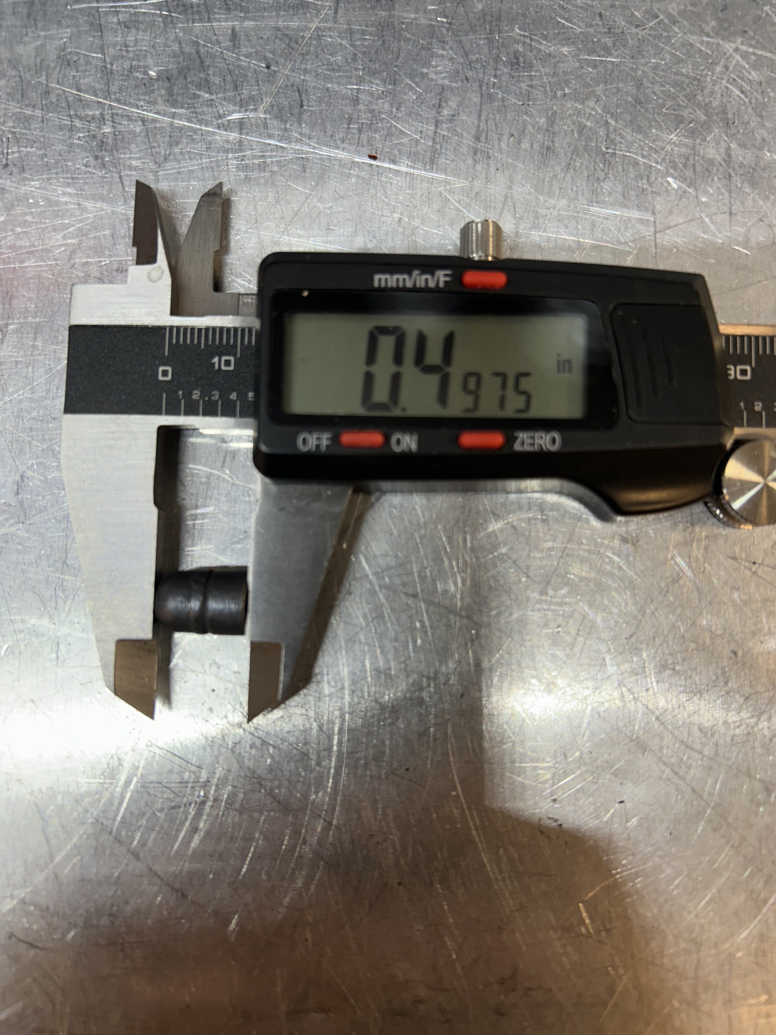

bobbyblackbear Posted March 28, 2025 Posted March 28, 2025 Hello. OK, so I’m loading some of these bullets and I ran into a little problem I think. My overall length winds up being 1.4195 to 1.4620 has anyone else run into this issue? Case lengths are all the same length. Not sure if maybe my seating plug isn’t fitting this bullet or maybe variation in the bullet meplat. Any ideas? Thanks Bob
