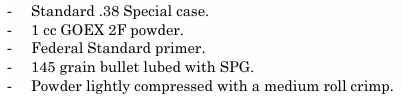

Edward R S Canby, SASS#59971 Posted February 5, 2025 Posted February 5, 2025 This is the black powder test standard: Load with 1 cc of real black powder. However, I load as OLG stated with either real black powder, Triple Seven or APP. My ammo has not been challenged for failing to meet the smoke standard.

El Chapo Posted February 8, 2025 Posted February 8, 2025 Just so you guys can get an idea of what 1.3cc looks like in a .38 case, I found a picture from the last time I loaded BP .38s. I use the 125 grain lee round/flat profile bullet in these. This is 3f Graf's black.
