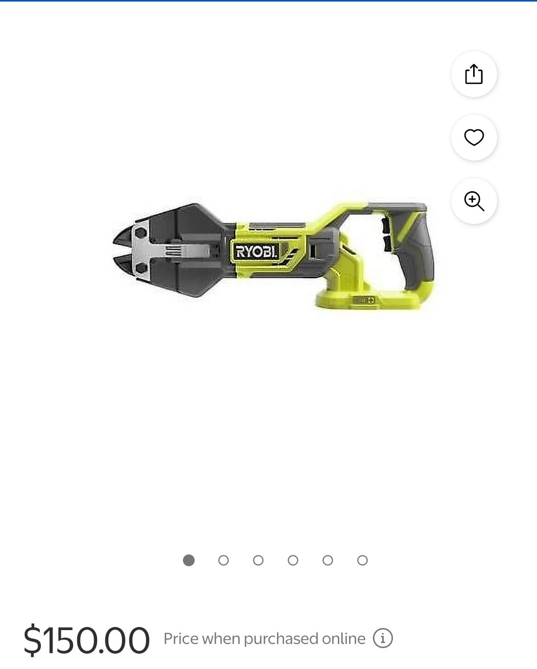

Texas Joker Posted February 2 Posted February 2 I see drivers at the guard shack using these to take bolt seals off conex and a smaller set of hydraulic manual bolt cutters sometimes 2 1 Quote

Pat Riot Posted February 2 Posted February 2 7 minutes ago, Texas Joker said: I see drivers at the guard shack using these to take bolt seals off conex and a smaller set of hydraulic manual bolt cutters sometimes This ^^^^^ Bolt cutters are a PITA to deal with in awkward conditions including being too small for the job. 24” is a joke of a length for doing actual work. 1 Quote

Texas Joker Posted February 2 Posted February 2 (edited) Our shack has a 3 foot red manual bolt cutter. You gotta see some of these guys try to use em. It's a challenge to line em up and then work the handles from 3 feet away Edited February 2 by Texas Joker 3 Quote

Chief Rick Posted February 2 Author Posted February 2 7 hours ago, Texas Joker said: I see drivers at the guard shack using these to take bolt seals off conex and a smaller set of hydraulic manual bolt cutters sometimes I looked at these and the price is on par with a quality set of 36" bolt cutters. I need to see if the cutting jaws are replaceable. Of course, she/we have no Ryobi batteries/chargers so that's another $99+. Quote
