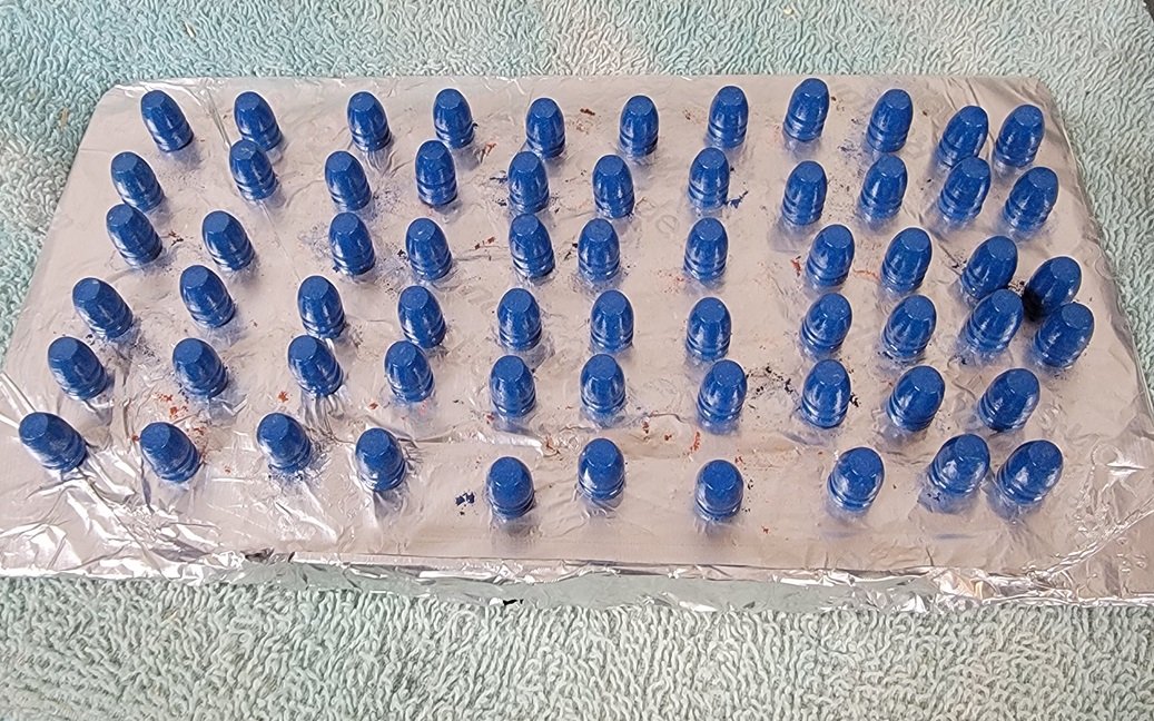

Dapper Dave Posted February 1, 2025 Posted February 1, 2025 (edited) Powder coating is the way to go. It is so easy and cheap - these were baked in a $5 Goodwill toaster oven. Smokes over at castboolits has a really nice selection of powder pretty cheap, just ordered some Signal Blue from him for me and my gunsmith buddy. I still have an unopened bottle of Lee Liquid Alox around here somewhere, if it hasn't congealed into a solid block. I have never water quenched, always towel dropped. Probably because it is the easiest way to cast. Casting to me is another hobby that help feeds my two other hobbies, reloading and shooting. Of course, now that I JUST got into shotgun reloading, I'm gonna need some various buckshot molds. Edit to add, you are very right - I've had shooting sessions with nothing but powder coated bullets and the barrel looks almost as nice at the end than when I started! They tend to scour the bore somewhat. Edited February 1, 2025 by Dapper Dave 2 Quote

Dapper Dave Posted February 1, 2025 Posted February 1, 2025 2 hours ago, Eyesa Horg said: Be careful that the powder coat you choose doesn't have silica in it. I read on this wire a while ago, that some colors do. Never heard that in all the time I've spent at castboolits. I'll ask. Do you know why someone put out that particular warning? 1 Quote
