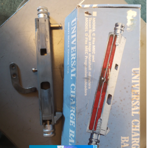

Totes Magoats Posted January 31 Posted January 31 (edited) I just rummaged through my bucket of 'stuff' and seen this. Is this what you are looking for? I don't load on a MEC, so no idea if this is complete, but it's never been used and I'll never use it. Edited January 31 by Totes Magoats 1 Quote

Totes Magoats Posted January 31 Posted January 31 (edited) Here is a view of all the bits in the package. Again, not sure if it's complete, but other than a bushing, it appears all there. @Yul Lose, If the OP found one, I'll send this out to you. Totes Edited January 31 by Totes Magoats Quote

OK Dirty Dan Posted January 31 Posted January 31 The product @Totes Magoats shows is what that company called a Shuttle Bar, as opposed to the Universal Charge Bar. The difference being that in the Universal Charge Bar, both the shot and powder side are dial adjustable, while in the Shuttle Bar, powder is still handled via MEC bushings. Also, being a Model C, that one is designed for MEC single stage presses. @Cpl. Henry B. Tolate, this charge bar wouldn't work for you if you're using a MEC progressive. I also own Ballistic Products' version of the Universal Charge Bar. They call it the Adjusta-Drop Charge Bar, and it too is only for single stage presses. If you're in the market for a single stage fully adjustable bar I would absolutely recommend it: Adjusta-Drop Charge Bar (single-stage) 1 Quote
Totes Magoats Posted January 31 Posted January 31 2 minutes ago, OK Dirty Dan said: The product @Totes Magoats shows is what that company called a Shuttle Bar Thanks for the info, I didn't know what press it was for other than being for a MEC. @Yul Lose Is this still something you want given the info on what it is? Totes Quote
Yul Lose Posted January 31 Posted January 31 1 minute ago, Totes Magoats said: Thanks for the info, I didn't know what press it was for other than being for a MEC. @Yul Lose Is this still something you want given the info on what it is? Totes No, I should have looked at it closer. Sorry about that, thank you for your considerate offer. Quote
Eyesa Horg Posted January 31 Posted January 31 (edited) 2 hours ago, Totes Magoats said: I just rummaged through my bucket of 'stuff' and seen this. Is this what you are looking for? I don't load on a MEC, so no idea if this is complete, but it's never been used and I'll never use it. Not positive, but I believe that one is for a single stage like a 600jr. My progressive Grabber has adjustments on both ends and doesn't use bushings. Edited January 31 by Eyesa Horg Added text Quote
Sedalia Dave Posted January 31 Posted January 31 4 hours ago, Totes Magoats said: Here is a view of all the bits in the package. Again, not sure if it's complete, but other than a bushing, it appears all there. @Yul Lose, If the OP found one, I'll send this out to you. Totes That version is for the Mec 600jr, Sizemaster and the other non-progressive MEC reloaders. It is the Multi-Scale CS version. The C version doesn't have the rubber inserts to allow use with Steel Shot. It will not work in the Progressive MEC presses like the Grabber and 9000 The Multi-Scale D / DS is made for the progressive MEC presses. Looks like the one pictured below. For it to work in a progressive press you need to replace the straight factory actuator lever with one that has an offset built into it. It is the L shaped piece in the picture below. Quote
Sedalia Dave Posted January 31 Posted January 31 4 hours ago, Totes Magoats said: Here is a view of all the bits in the package. Again, not sure if it's complete, but other than a bushing, it appears all there. @Yul Lose, If the OP found one, I'll send this out to you. Totes 2 hours ago, Eyesa Horg said: Not positive, but I believe that one is for a single stage like a 600jr. My progressive Grabber has adjustments on both ends and doesn't use bushings. Good catch. I've never seen one with an adjustment on only one end. 1 Quote
Sedalia Dave Posted January 31 Posted January 31 Ballistic Products makes one for the 600 jr, Sizemaster and other MEC single Stage Presses. https://www.ballisticproducts.com/Adjusta-Drop-Charge-Bar-single-stage/productinfo/ADCSS/ AFAIK no one currently makes one for the Progressive MEC presses. Quote
Cpl. Henry B. Tolate Posted January 31 Author Posted January 31 Thanks everyone for your replies. And yes most charge bars out there are for single stage units. Sedalia Dave’s info is correct. For the 9000 MEC requires the straight actuating arm and bracket that it engages as well as a screw or stud on other end to hook the spring. Also powder is on the left. Shot to the right side of bar. 1 Quote
