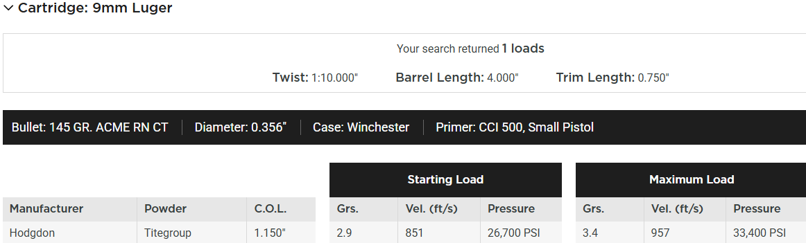

4 hours ago, Edward R S Canby, SASS#59971 said:
Here is an example of a SASS legal load using a lead bullet in a 9 mm Luger case.  (Data from Hodgdon's website)

120 - 140 power factor!!
Yes, published loads for 9 mm Luger run hot - way hotter than I shoot in 38 Specials.  The posted data was just to show that there is published data for lead bullets with less than 1,000 fps.  I would develop lighter loads if I were loading for CAS.  Like Abilene said, published loads are meant for semi-auto firearms.
