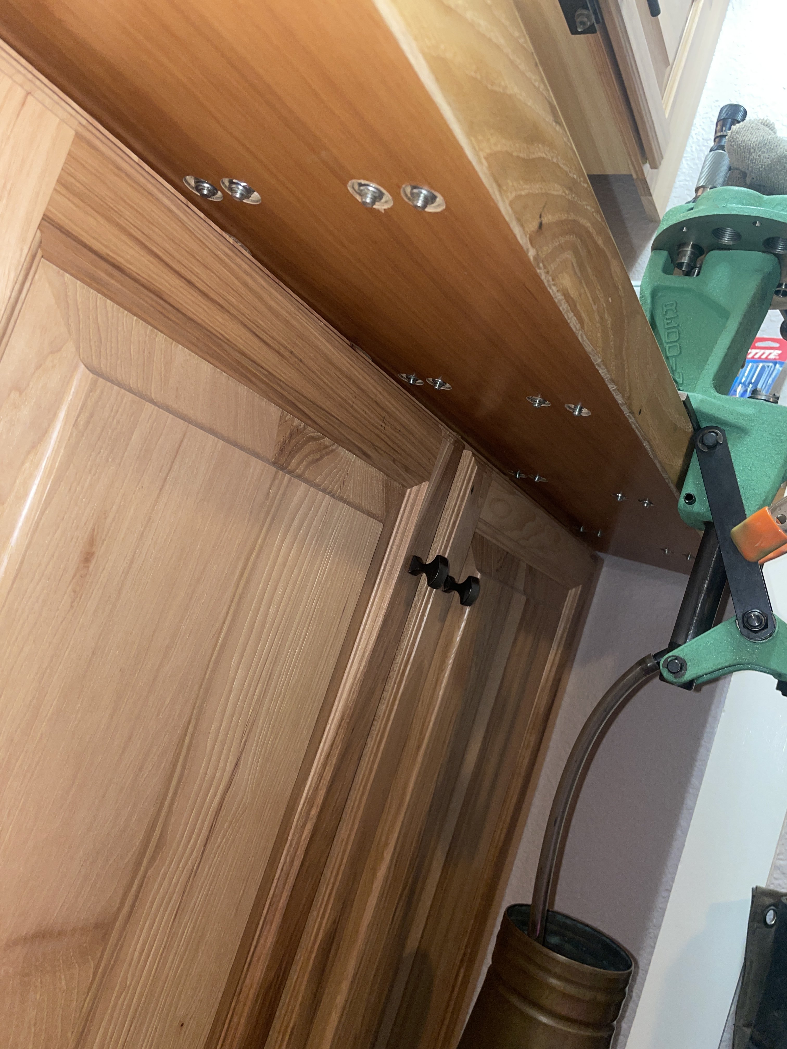

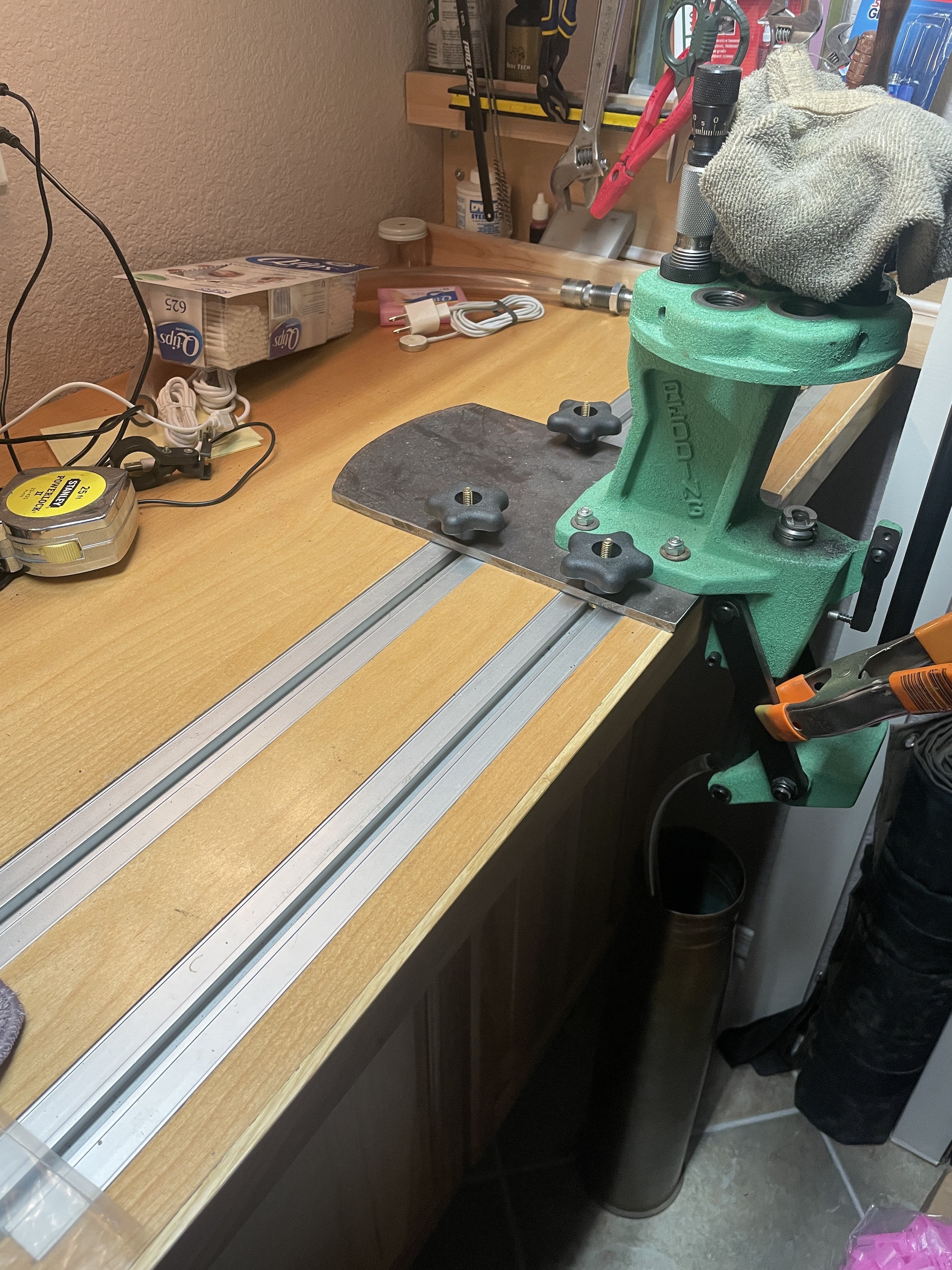

August West, SASS #45079 Posted January 27 Posted January 27 (edited) I started with a surplus, solid-core door, though the thicker, the better. Using straight edge and router, cut channels for the tracks. Have had it up and running for about 20 years. No deformation, no changes to the tracks after a lot of use. The T-Track bolts distribute the clamping force across a lot of area; and there are four bolts per press in my design. The set-up allows me to easily unmount a press without changing any settings. I can slide presses to one end, or the other of the table and have plenty of room to work on a particular process or project. The tracks allow complete flexibility for how the available space can be used -- there is still a useful table available when necessary. I used, and recommend, the 1 3/4" T-Track, 1/4" steel plates permanently attached to the presses, the T-Track bolts (absolutely), and knob-nuts for tightening. Very solid, durable, and flexible set-up. I put a space in the track at the center of the table so presses can be removed or installed at that location, also handy for clearing the track if something (primers) falls into it during the process. Edited January 27 by August West, SASS #45079 2 Quote

August West, SASS #45079 Posted January 27 Posted January 27 54 minutes ago, Eyesa Horg said: How is that track secured? I don't see any fasteners. There are two T-Tracks on the bottom side of the track. 1 2 Quote
Colorado Coffinmaker Posted January 27 Posted January 27 AUGUST!! That work space is entirely too neat and tidy. Forshame. I'v seen that gun case somewhere else. Oh yea, I've got five just like it. Oh, the original subject, I really like your Tracks. Use of the steel plates under the appliance also spreads the torque loads over a much larger area rather than concentrating on the tracks themselves. I really like it although for my circumstances, unnecessary. Still a great application!!! Quote
