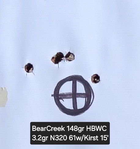

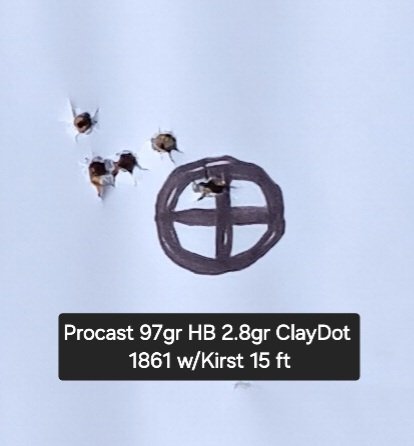

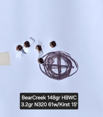

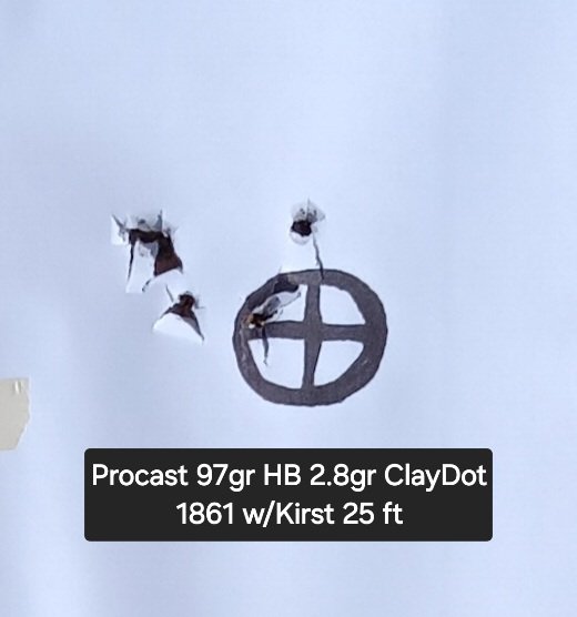

I wanted to update with my test results on these bullets in an unlined percussion barrel with a conversion. (1861 Uberti with Kirst). I'm guessing .370 bore.  Anyway, I had N320 in the powder hopper and V-V Cowboy data only goes down to a 125gr bullet - I use 3.2gr, so I upped it to 3.5gr and loaded 14 rounds (that was all the brass I had left).  Tested it at 20 ft, about a grapefruit size group a little high left, not bad but a fair amount of unburnt powder.  So next I tried 2.8gr of ClayDot - (Clays data for a 100gr bullet is 2.5-3.0gr).  This made the two pictured groups at about 15 feet, and then for comparison two groups with BearCreek 148gr HBWC and 3.2gr N320 (V-V cowboy data for 140gr is 3.2-3.8gr).   So I'm not sure how much the little bullets are expanding but apparently good enough for CAS and don't seem to be keyholing, though not sure about that one paper tear.  The next test will be whether the lower pressure of BP will expand it.
edit: oops, typo on that first picture, it was at 15' like the rest, not 25'
