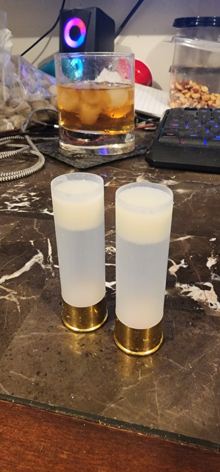

Recently I started making my own wax bullets to be able to practice and become a little faster with shooting my Ruger Vaqueros.
I started thinking that maybe I could do this for my shotgun as well. This evening I tested it out and it appears to work very well in my SXS.
Now I'm trying to figure out if this might work in my lever action as well. I have not had much luck cycling dummy rounds with plastic bullets through my lever action. I am thinking this is because they are too light with the plastic bullets and I am assuming I will have the same issue with the wax bullets. Has anyone else tried this or have experience with using wax loads?

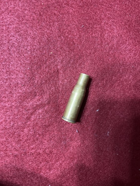

Ike, I found one of the cases from the wax shoots. It’s a Starline 5in1 blank case. It is 1.575 long and necked to take a .30 wax bullet. Ten-X ammo was the supplier to SASS for the ammo and components. They actually came to the convention and loaded the ammo on site the years I worked it.
