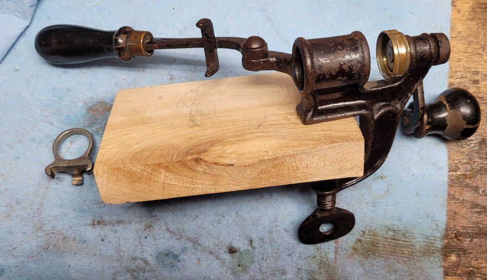

"Big Boston" Posted January 21, 2025 Author Posted January 21, 2025 This little gem followed me home today. IMO pretty decent shape for an antique. The seller said it was his dads, but that he never saw him use it. I've seen a few of these, but none ever had the little puller thingy. 30 CAD and it was mine. If I'm going to do the BP thing, suppose I need some oldie time tools. BB 6 Quote

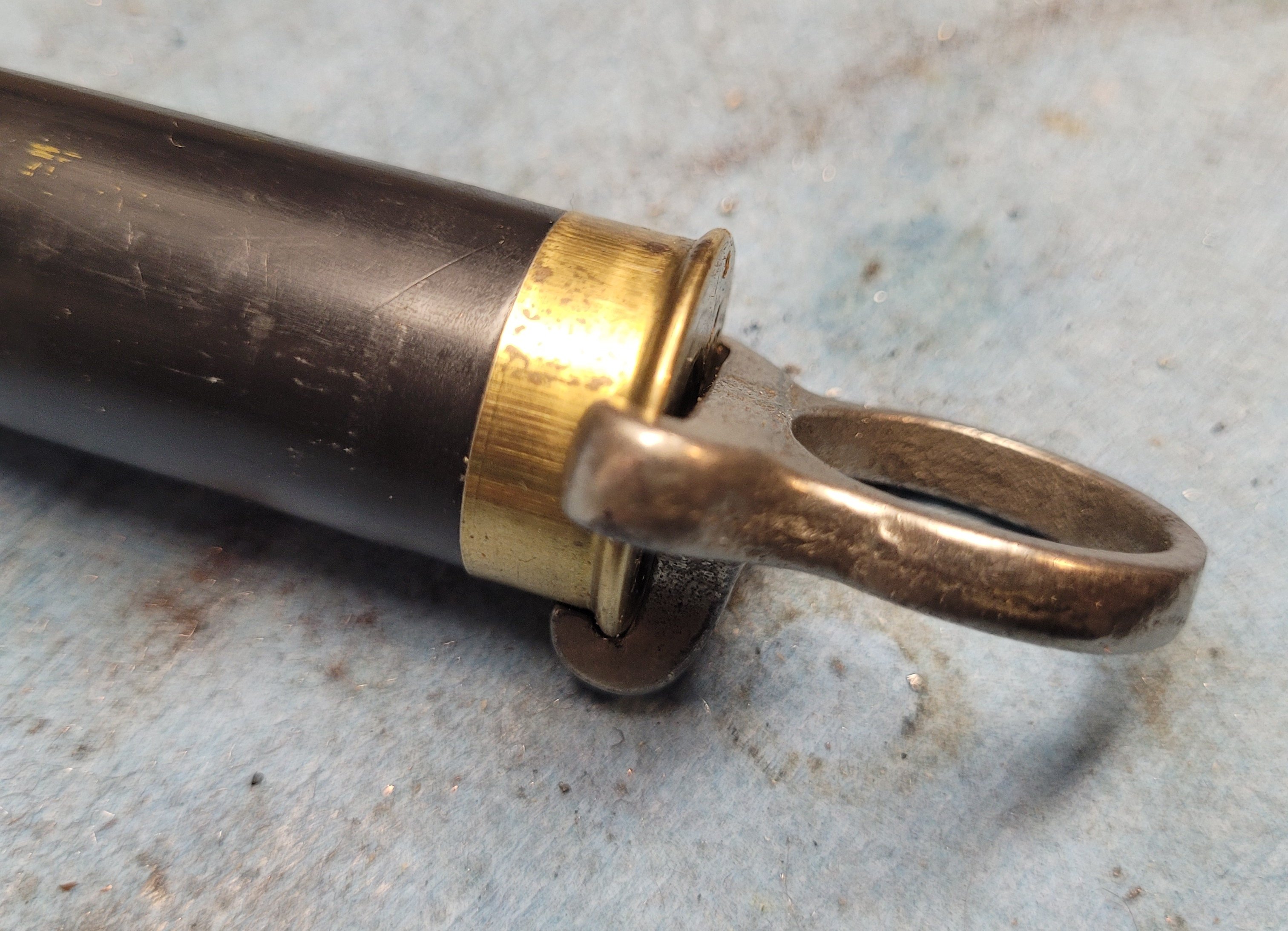

Abilene, SASS # 27489 Posted January 21, 2025 Posted January 21, 2025 11 hours ago, "Big Boston" said: ...I've seen a few of these, but none ever had the little puller thingy.... puller thingy? That piece to the left? I have one of those crimpers, works fine on plastic, but I've never seen one of those thingies and wonder what is it for? Quote
"Big Boston" Posted January 21, 2025 Author Posted January 21, 2025 It slides on the rim of a 12 gauge hull, that's intuitive enough, no mystery there. But what it was called, or what it's intended application was, IDK. It was a package deal, came with the roll crimper. However, I have no way of knowing if it is supposed to be included with the crimper, or the previous owner bundled it as it didn't belong with anything else. It is magnetic, but a bit weak. The metal has no rust and is silvery in color. It appears to be a cast piece. My Bad, derailing my own topic. BB 1 1 Quote

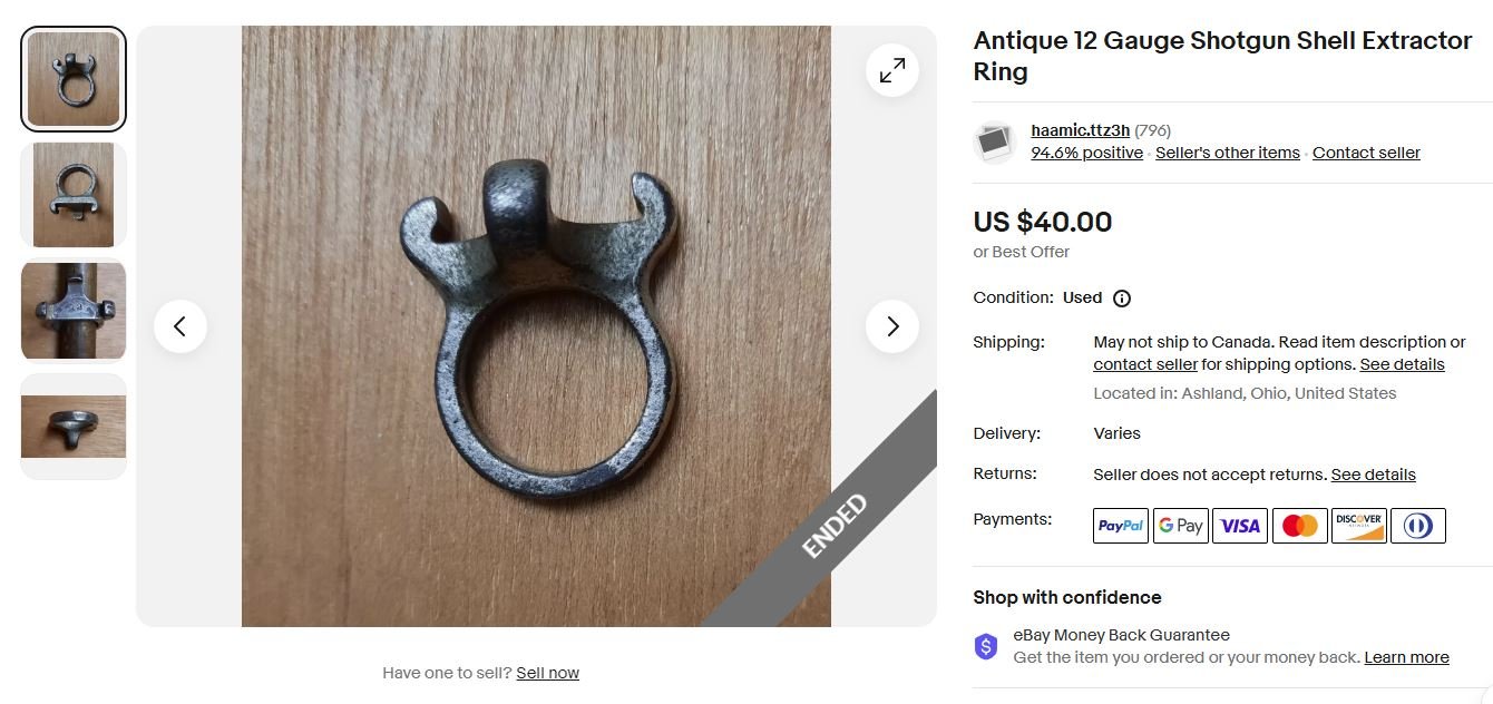

Rip Snorter Posted January 21, 2025 Posted January 21, 2025 There used to be shotguns without ejectors or extractors. To remove a fired round from a double gun. You can still find European hunters jack knives with a similar fixture as a guard. 1 Quote
Eyesa Horg Posted January 21, 2025 Posted January 21, 2025 12 hours ago, "Big Boston" said: This little gem followed me home today. IMO pretty decent shape for an antique. The seller said it was his dads, but that he never saw him use it. I've seen a few of these, but none ever had the little puller thingy. 30 CAD and it was mine. If I'm going to do the BP thing, suppose I need some oldie time tools. BB I've picked a couple sets of those here and on eBay for 20-30$ they work well for roll crimping plastic hulls. Quote
"Big Boston" Posted January 21, 2025 Author Posted January 21, 2025 Thanks rip snorter. I don't have the only one in existence, this one was on ebay, it may have sold or the seller didn't have any takers. BB 2 Quote
