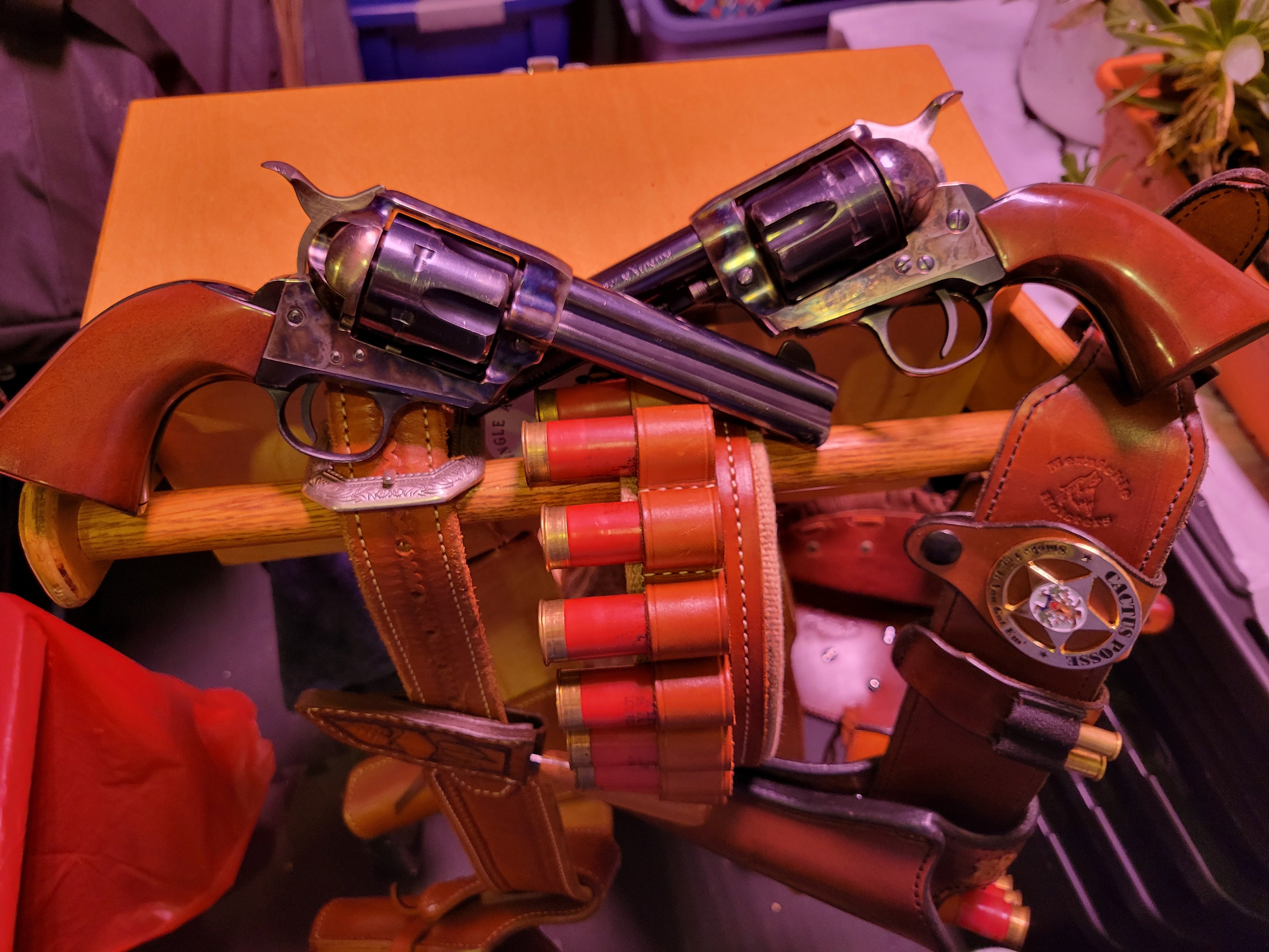

Mountain man Jim Posted October 27, 2024 Posted October 27, 2024 I have been trying to work with Cimarron and Taylors to replace a broken "hand" in my Cimarron Thunderstorm 357. Both have sent me the same part, Part number: SAA5281, which is not the correct part and significantly larger than the piece that broke. I suspect that it is for a 45lc model as I have found in my online research that the current Thunderstorm models were made for mounted cowboy action shooting. Based on more online searching it looks like my revolver was manufactured around the same time as the 357 models seem to have been discontinued in 2015. (https://www.muzzleloadingforum.com/threads/fyi-updated-italian-proof-house-date-codes-table.133886/) As evident by the Italian date code "CN". Does anyone have any spare hands laying about for this? Or know a better parts source? Where is a good spot to look for discontinued model parts? Appreciate the help. Quote

Mountain man Jim Posted October 28, 2024 Author Posted October 28, 2024 10 hours ago, Abilene, SASS # 27489 said: I never knew the Thunderstorms to have any difference in the hands or bolts. Is that a Pietta or Uberti? Cimarron had both making them. Its marked as a Pietta. Both the hands I've ordered from Cimmaron and Taylors had the same part number, but both are marked for a Pietta 1873. They were both, as you can see from the photo of the broken hand and the one I got, significantly different in size and more specifically the pin section that inserts into the hammer assembly is. The piece that broke has a pin that is 0.119" diameter and the new ones were 0.155". Quote

Brushy Creek Bill, SASS # 49466 Posted October 28, 2024 Posted October 28, 2024 What you have is a Pietta short stroked Thunderstorm. I have two, acquired back in 2016. I ordered them at the SASS convention when it was held in San Antonio. In fact, the serial numbers on mine are right next to the one of yours shown in the picture. I'm not sure how long they were offered. I had to order a new hand for one, it broke right at the pin. I have one replacement that I'm not willing to give up because my wife still uses them for practice. The one I have matched your dia. of 0.119 and has the curve in it. Unfortunately, I do not have a part number to give you. You need to contact Cimarron again and tell them the part you need is for the short stroked Thunderstorm. Maybe Abilene would be able to tell you who to talk to direct when calling. Good luck, Brushy 2 2 Quote
