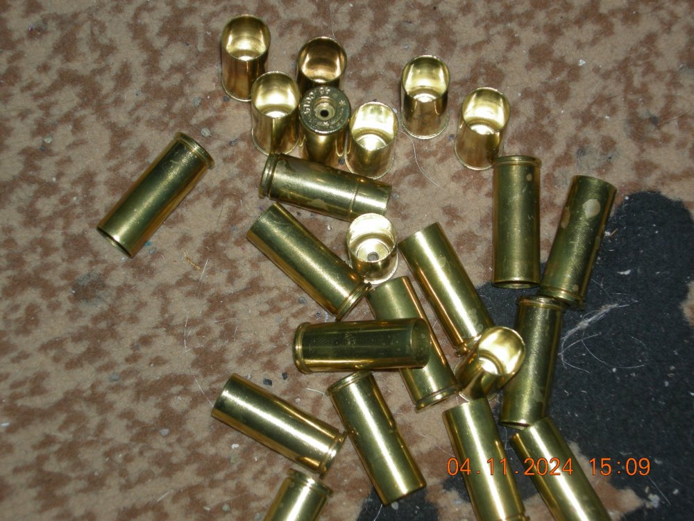

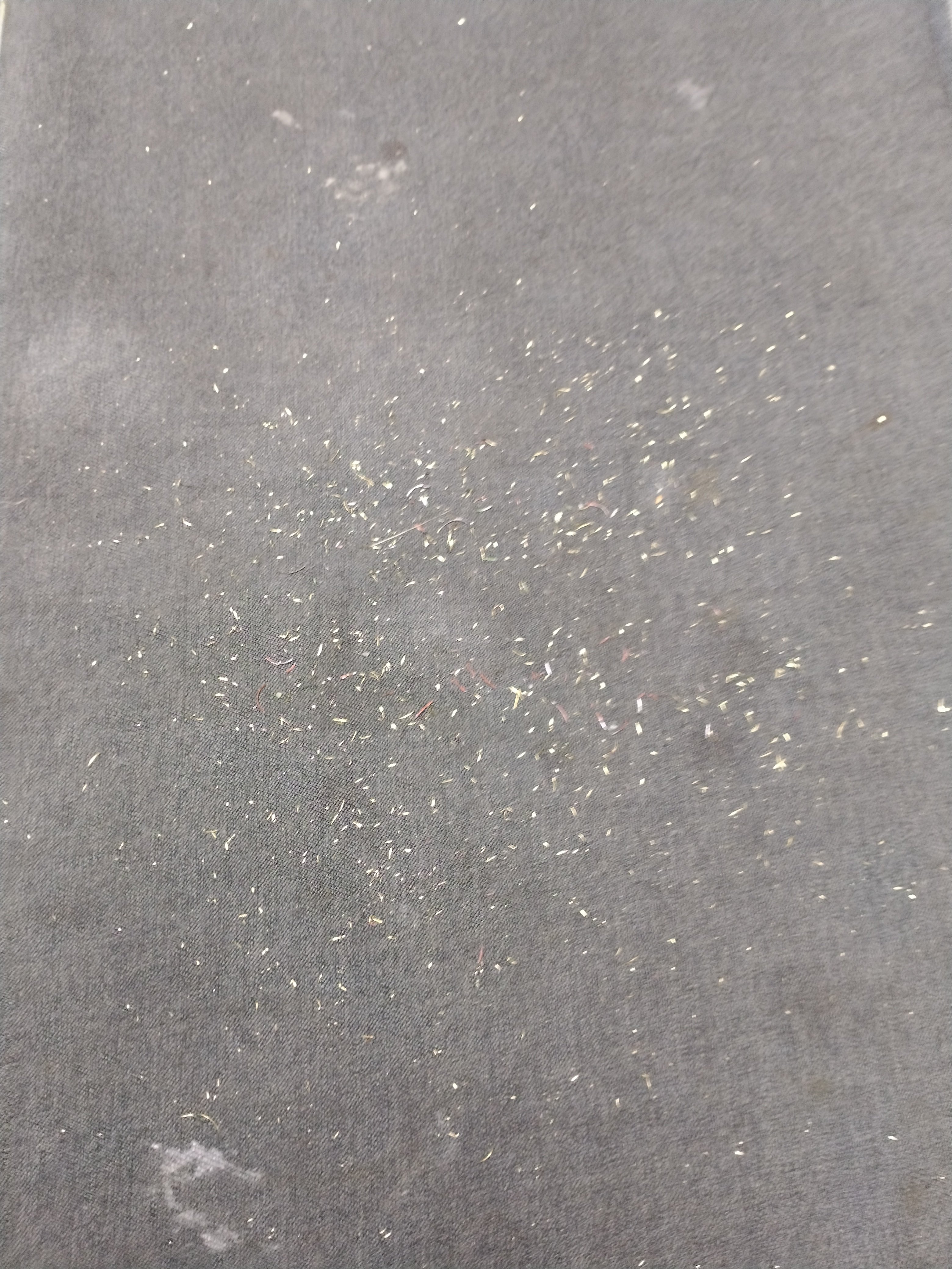

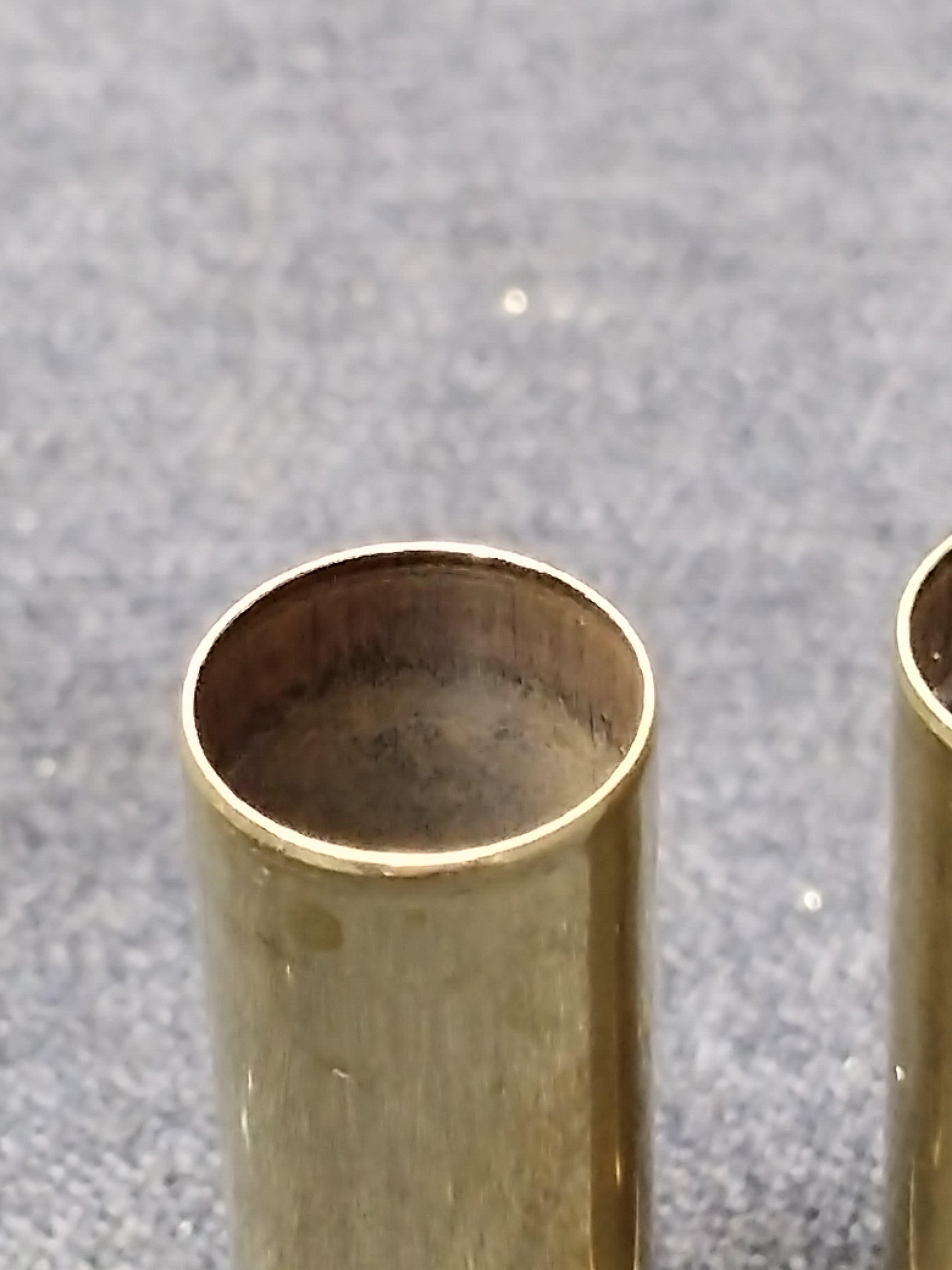

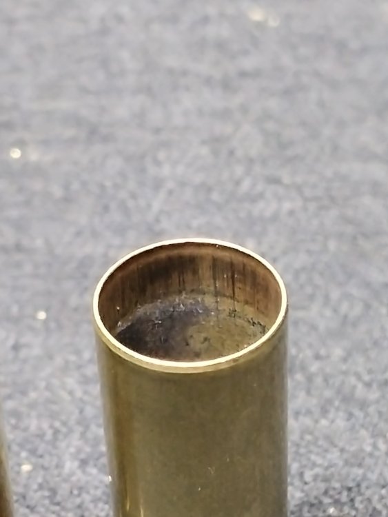

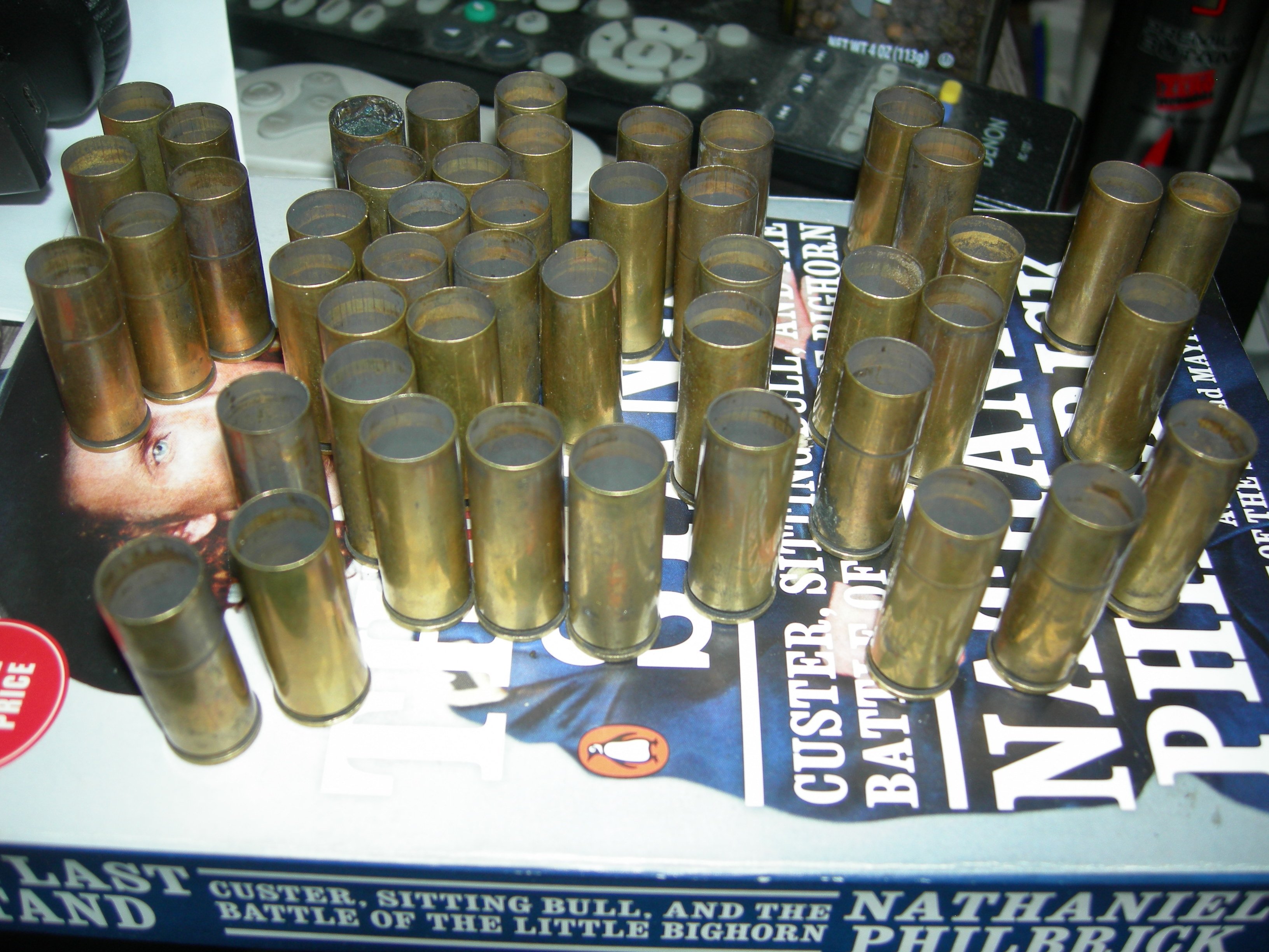

Eyesa Horg Posted 1 hour ago Author Share Posted 1 hour ago I just swiped this photo from a for sale ad here. This is what I'm talking about with the rough mouth opening. His pic is way clearer than mine! Enlarge a bit to see, especially the upper right. I'll have to get on my PC to include a pic of the brass dust they leave on everything after loading. Quote Link to comment Share on other sites More sharing options...
