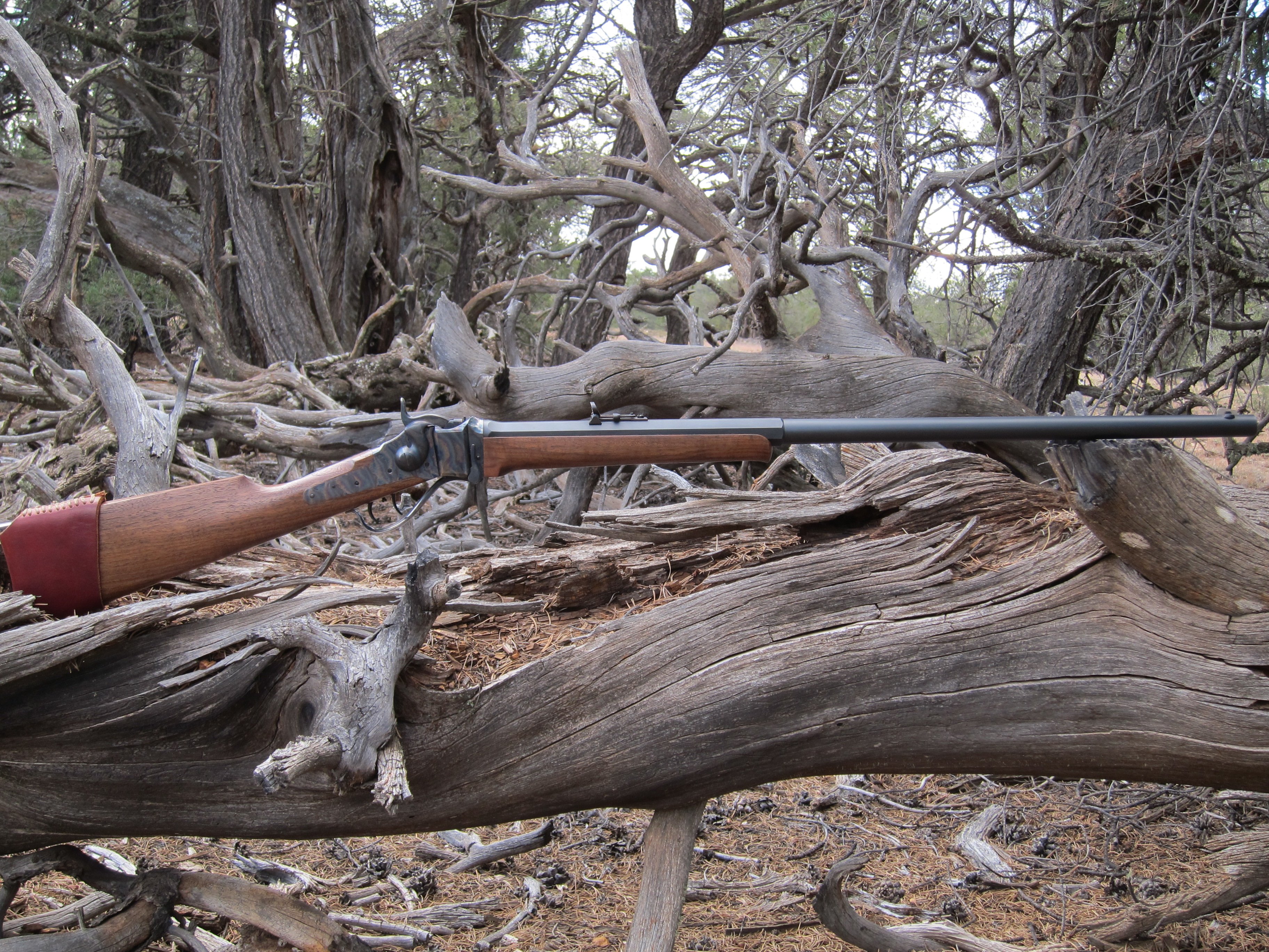

Hashknife Cowboy Posted March 20, 2024 Posted March 20, 2024 I did the reverse, I ordered the rifle for hunting and not CAS. Having used the Shiloh Sharps for big game, I an tell you that the 45-70 is more than adequate for hunting purposes. Mule deer and cow elk were relocated from the field to the freezer. Then one day I started practicing at greater distances and remember thinking, hey this is fun! So now my Shiloh Sharps 1874 Business rifle in 45-70 fills both needs and it may not be a Quigley but it is all I need with a 30 inch barrel that is round and octagon. 2 Quote
