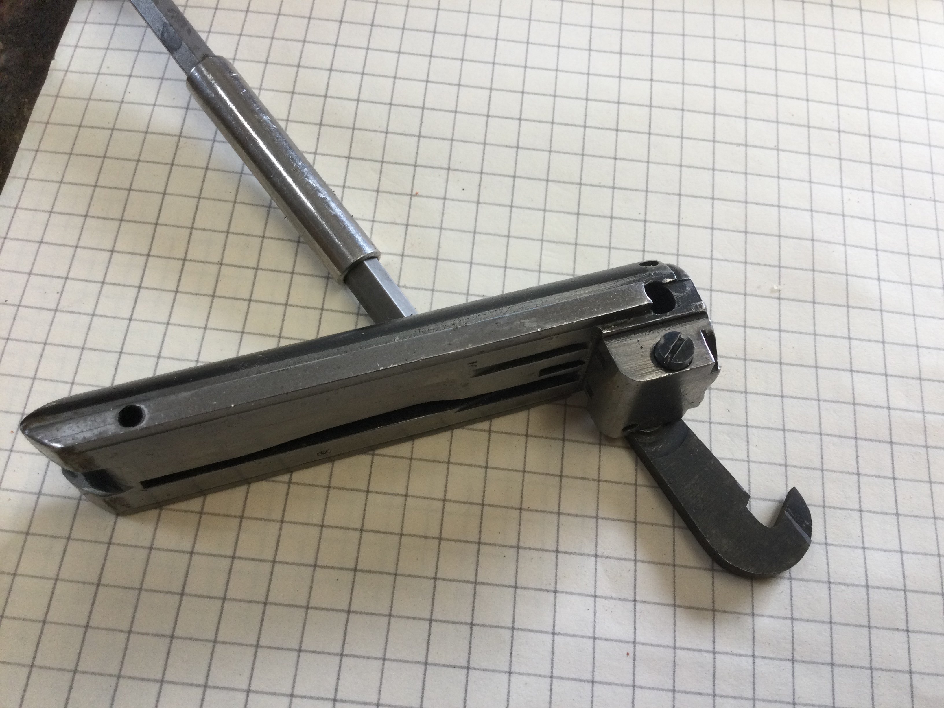

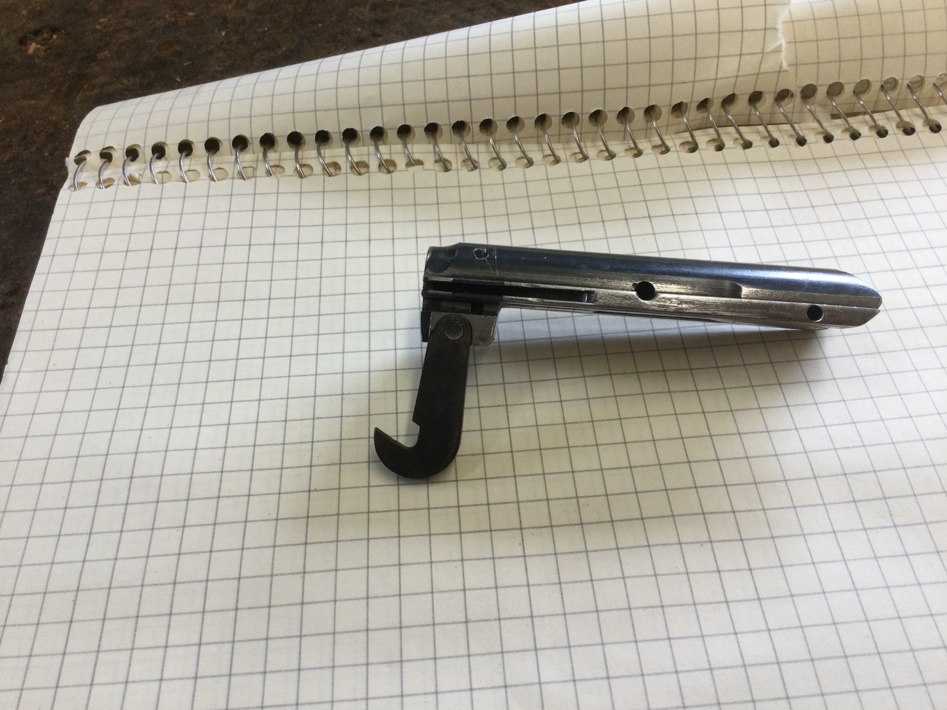

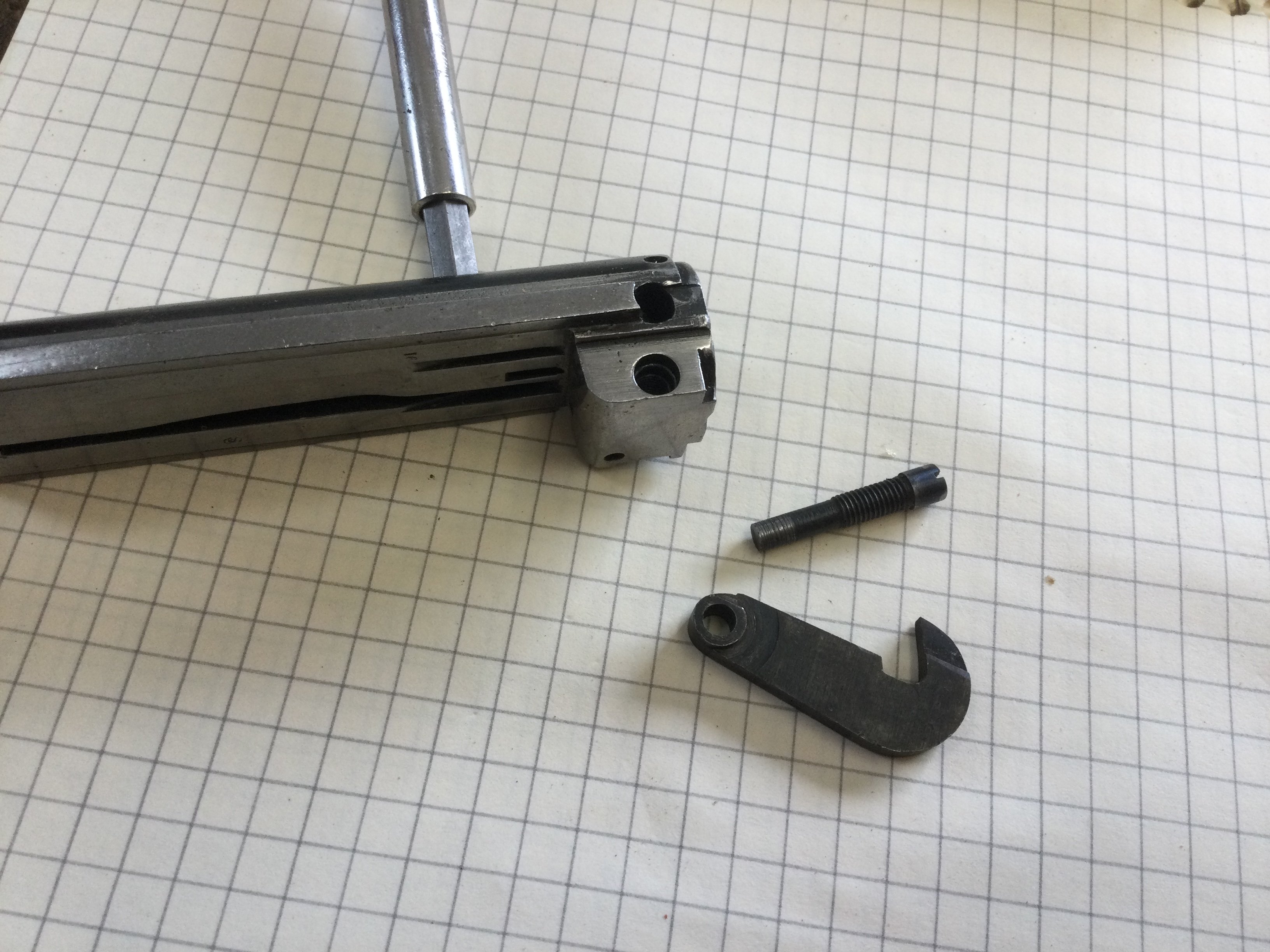

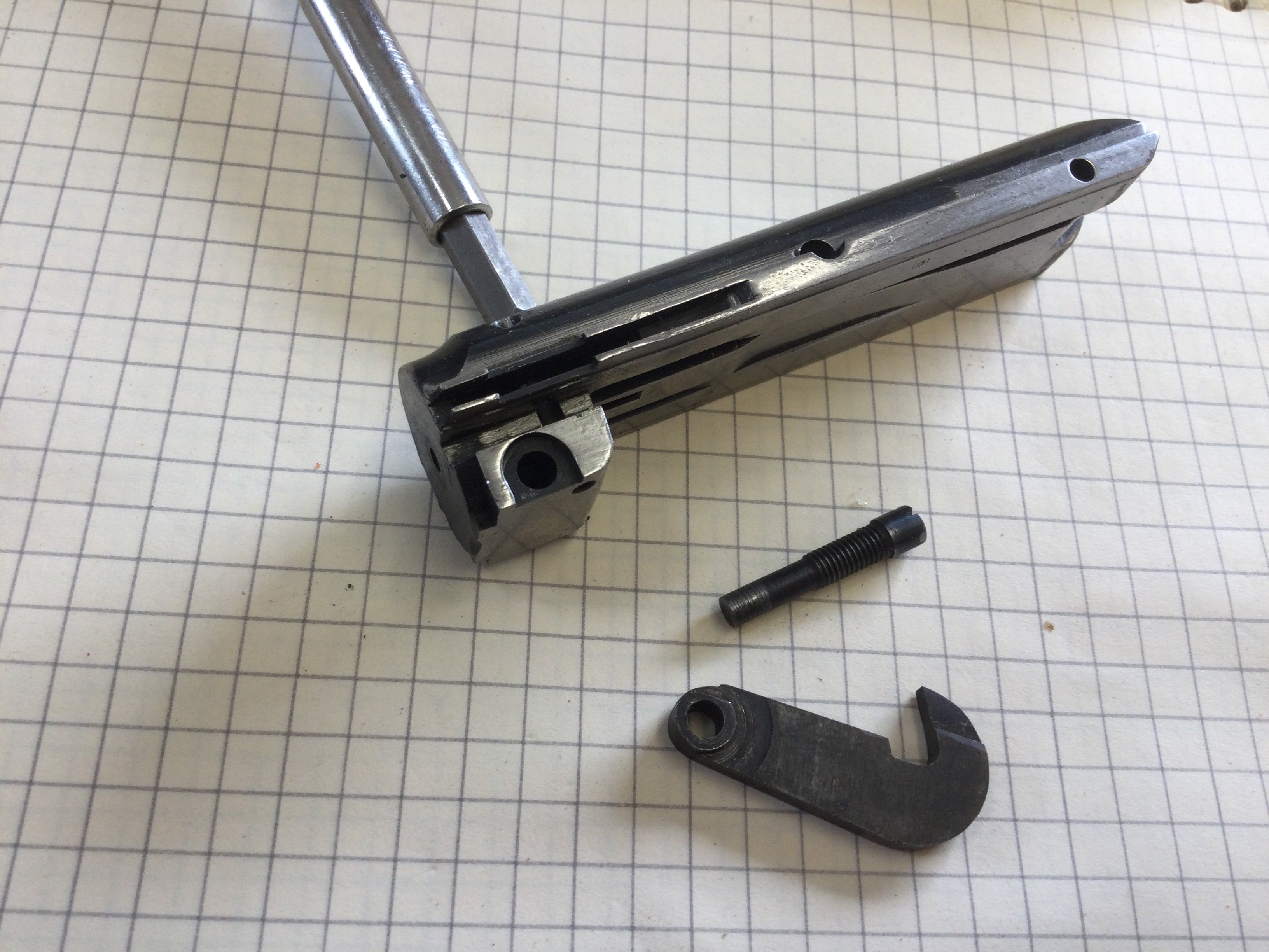

Yul Lose Posted August 21, 2023 Posted August 21, 2023 Well if it is indeed a broken hook screw and you can’t get the bolt out you may have to do as I did on one of my numerous 1897’s. After a few conversations with Jim Bowie at The Cowboys and Indians store I did as he suggested and drilled a 5/16” hole on the left side of the receiver and drove the end of the hook screw out with a punch, actually it was just a lite nudge once the hole was drilled. I had tried everything to try and get the end of that broken screw out without success. Once it was out the hook and bolt came right out. I’ve been asked about that extra hole at the loading and unloading table a few times and after explaining why it’s there they want to know where they can get a hardened hook screw. I replaced all of the hook screws in my 1897’s with the ones from the Smith Shop, that Larsen references above. In the one picture you can see the end of the hook screw through the hole. There’s also a few pictures of the bolt, hook and hook screw.

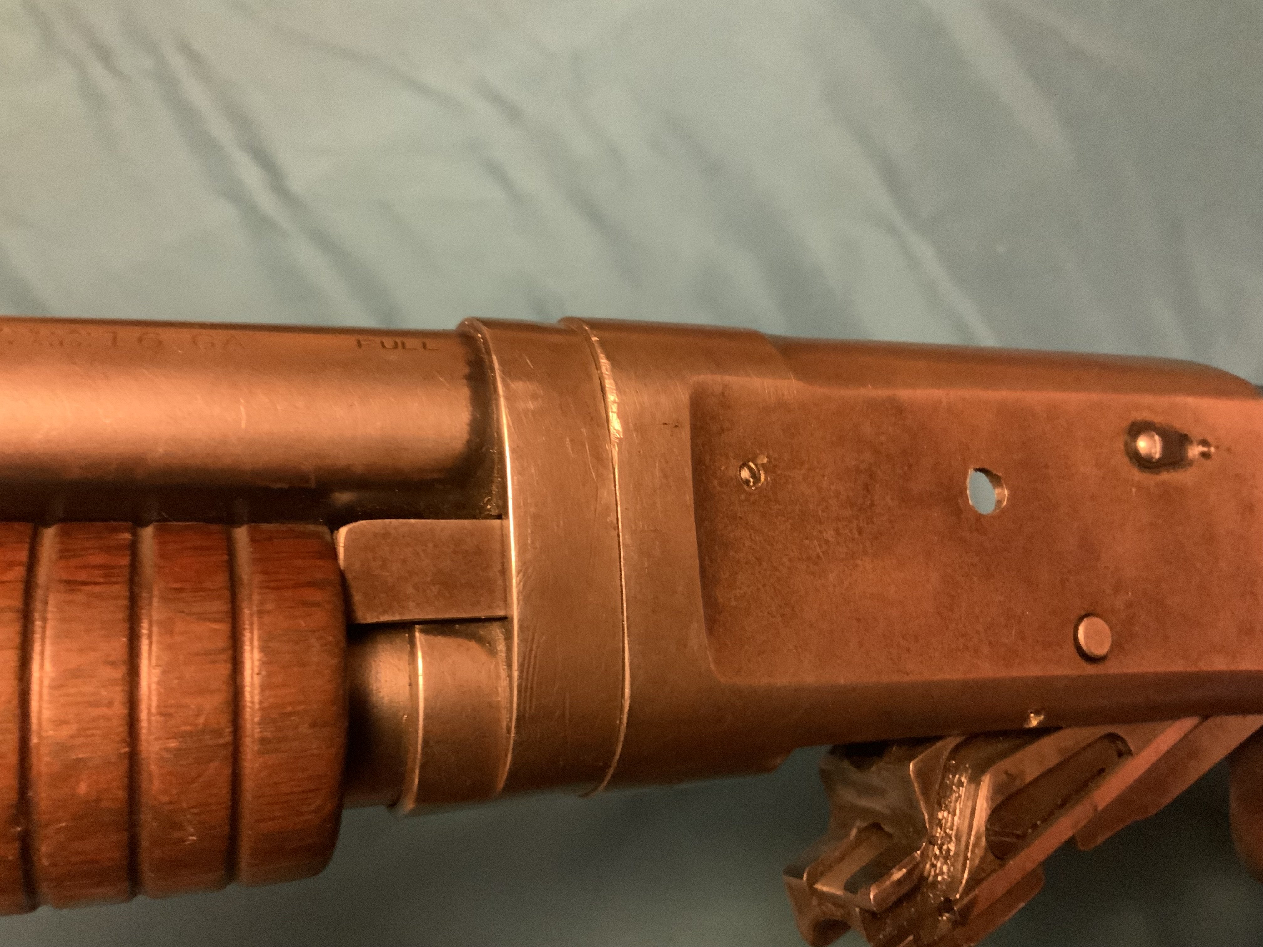

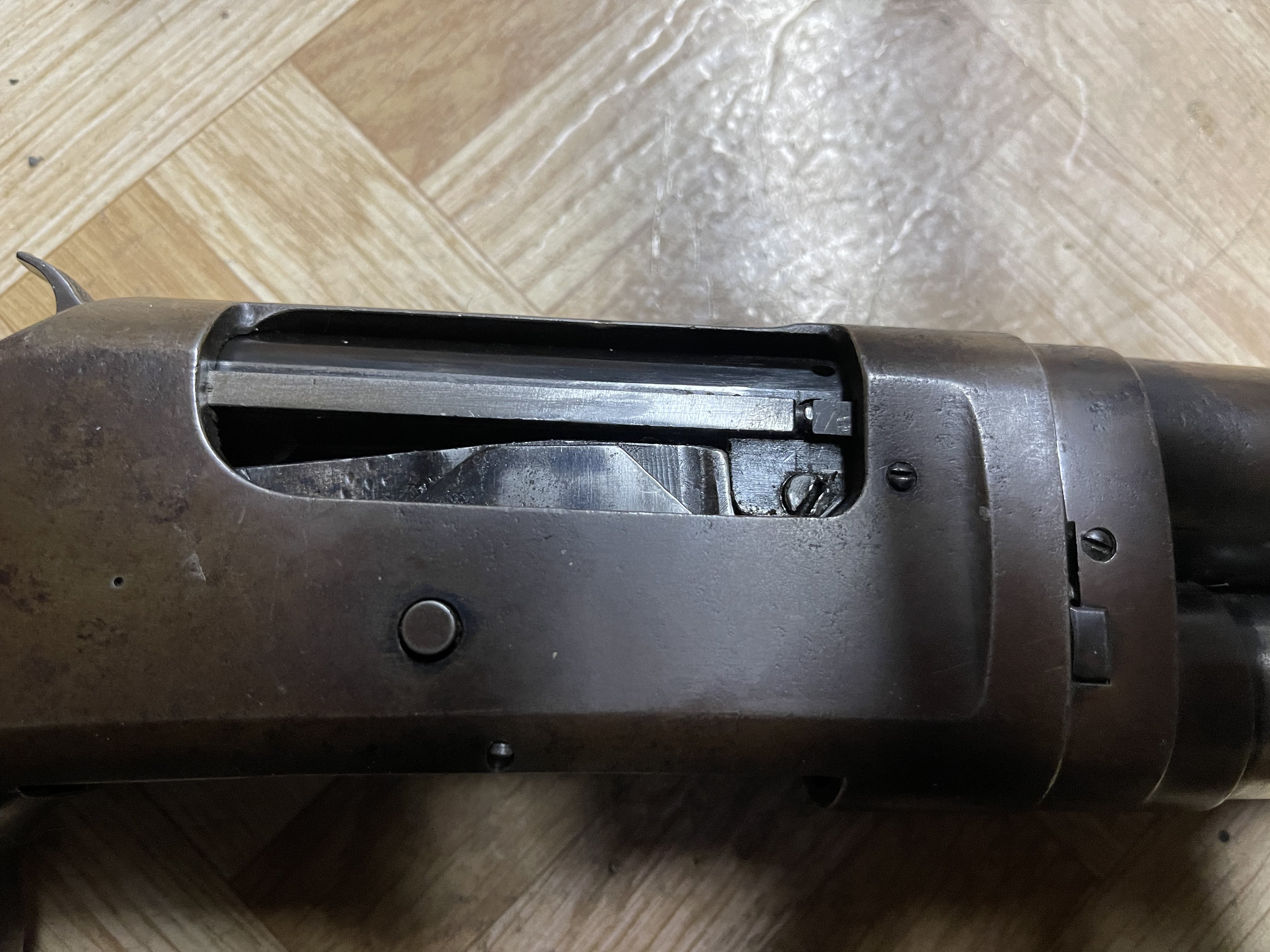

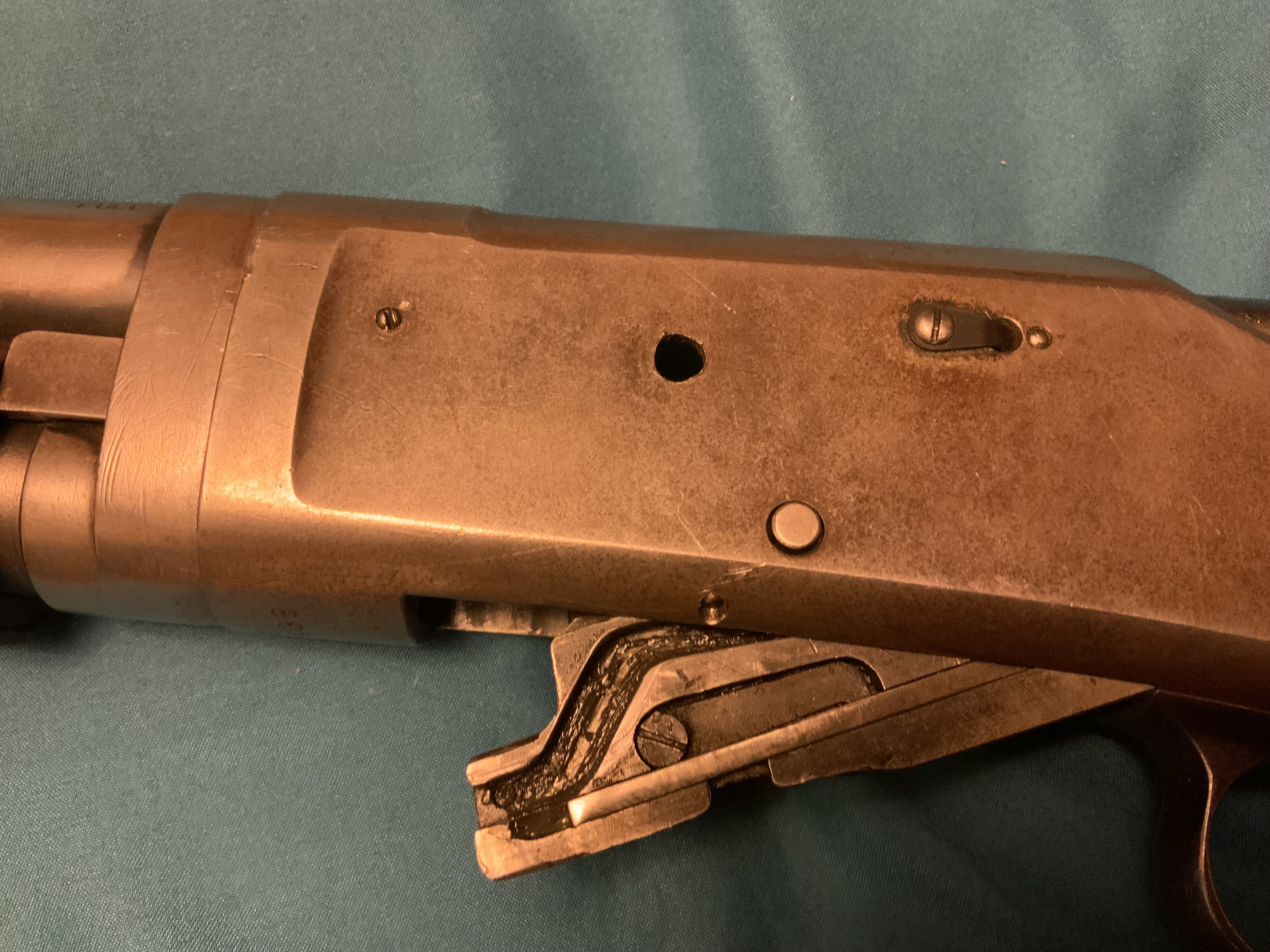

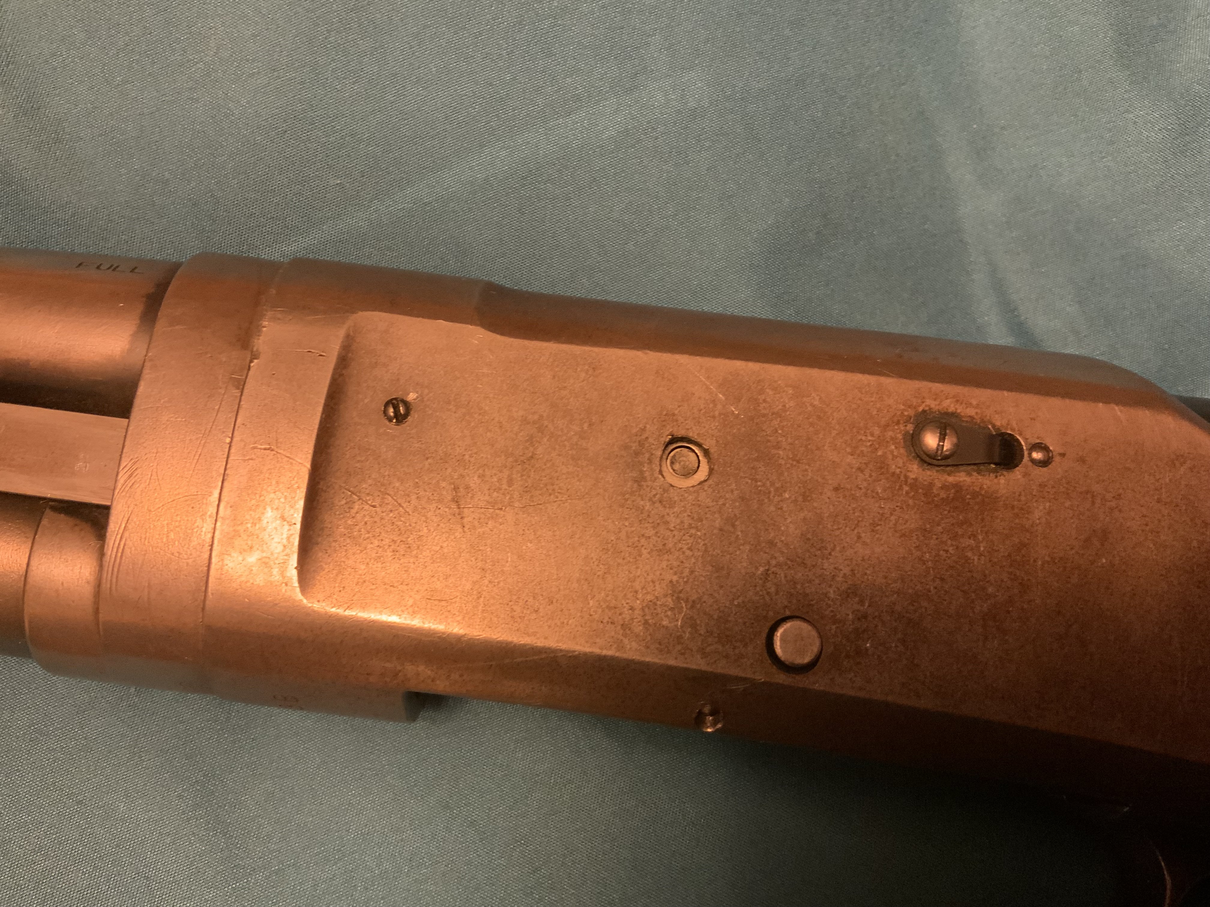

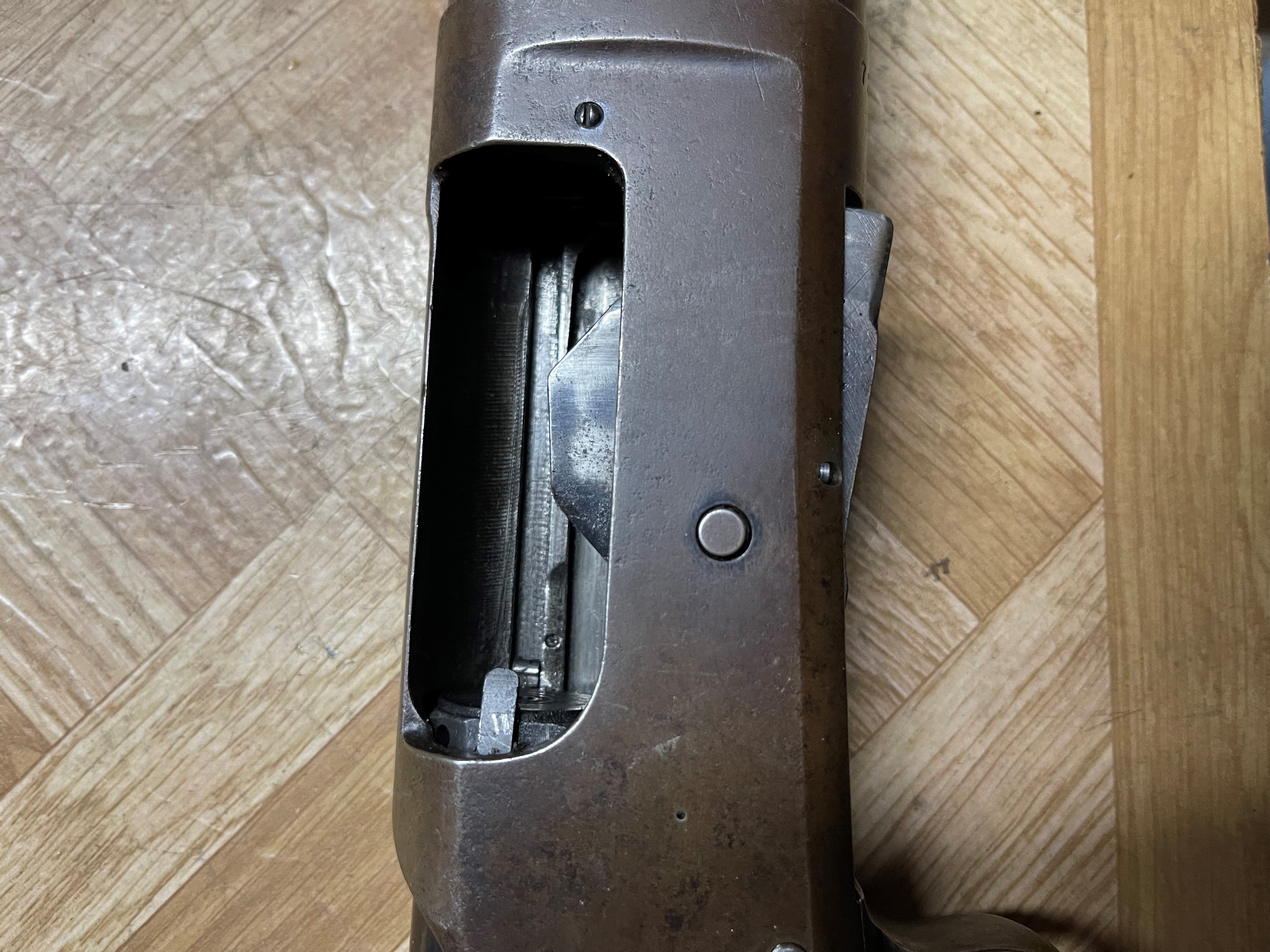

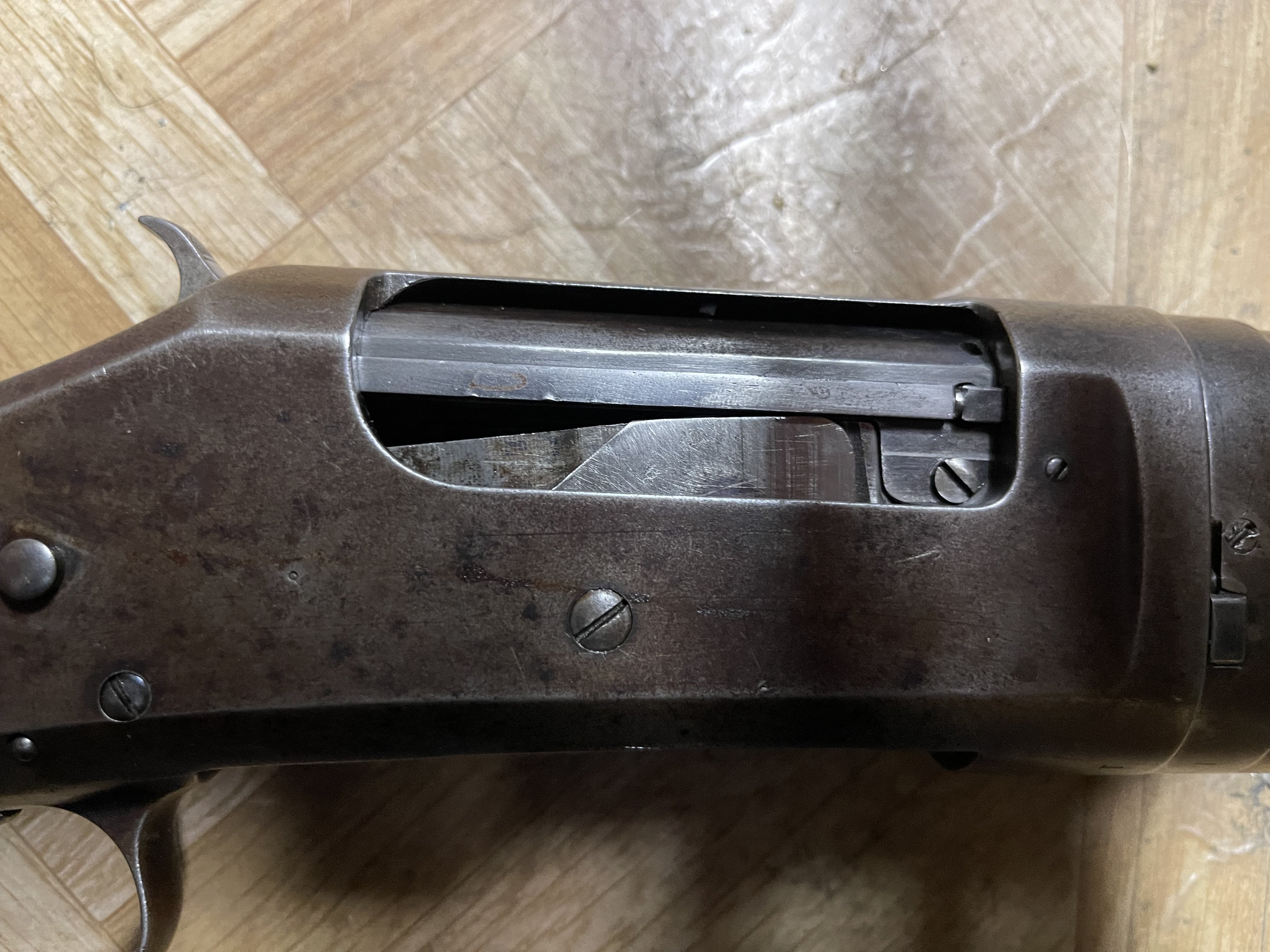

Nawlins Kid SASS #36107 Posted August 21, 2023 Author Posted August 21, 2023 Thanks. The locked up one has the push button (Bad_97) and the spare has a screw (Good_97). I am not very familiar with different styles of 97s, so is there a reason why one has a push button and the other has a screw?
Larsen E. Pettifogger, SASS #32933 Posted August 21, 2023 Posted August 21, 2023 29 minutes ago, Nawlins Kid SASS #36107 said: I am not very familiar with different styles of 97s, so is there a reason why one has a push button and the other has a screw? The Winchester Model 97 was in production for 60 years. During that time there were numerous refinements during production. Major refinements were designated by a "C", "D" or "E" stamped above the serial number. On the one with the screw its serial number should be below the one with the button as the button is a later refinement. Oh, the button allows the magazine to be emptied without cycling the action.

Renegade Plowboy Posted August 22, 2023 Posted August 22, 2023 14 hours ago, Nawlins Kid SASS #36107 said: Thanks. The locked up one has the push button (Bad_97) and the spare has a screw (Good_97). I am not very familiar with different styles of 97s, so is there a reason why one has a push button and the other has a screw? 1) The top gun the carrier is not up far enough. Compare it to the lower and you’ll see the difference. 2) make sure the bogered up flat head screw on the side of the bolt that you see through the ejection port is tight, and also is not contacting the ejection port. I have experienced this screw coming loose and it locking up the 97 a couple times, as well as a fellow shooters 97. It looks to me by the pictures that the bogered up flat head screw in the top gun is loose and backed out just enough to interfere and is what has caused your lockup.
Nawlins Kid SASS #36107 Posted August 22, 2023 Author Posted August 22, 2023 7 hours ago, Renegade Plowboy said: 1) The top gun the carrier is not up far enough. Compare it to the lower and you’ll see the difference. 2) make sure the bogered up flat head screw on the side of the bolt that you see through the ejection port is tight, and also is not contacting the ejection port. I have experienced this screw coming loose and it locking up the 87 a couple times, as well as a fellow shooters 97. It looks to me by the pictures that the bogered up flat head screw in the top gun is loose and backed out just enough to interfere and is what has caused your lockup. You were right about the screw and I tighten it. I finally got the action to open but it toke multiple tries pulling the trigger and really brute force to open the action. The other thing I noticed was the bolt did not move when the hammer hit the bolt. Now that the action is opened I would need a lot of force to try to close it. Any suggestions what to look for?
Renegade Plowboy Posted August 22, 2023 Posted August 22, 2023 2 hours ago, Nawlins Kid SASS #36107 said: You were right about the screw and I tighten it. I finally got the action to open but it toke multiple tries pulling the trigger and really brute force to open the action. The other thing I noticed was the bolt did not move when the hammer hit the bolt. Now that the action is opened I would need a lot of force to try to close it. Any suggestions what to look for? Glad you got it opened. Your posted pictures for comparison really helped. I’ll be honest on saying I’m pretty novice on the inner workings of a 97. If’n I’m not mistaken, Classic Old West Arms has some pretty good tutorials on YouTube or maybe his business page that might help you. Hickok45 has some great YouTube videos on it as well. However, if’n I was in your shoes at this point, I’d be looking up a competent gunsmith for the 97’s and let them do their thing. They work really well when they work. But we run them super hard so knowing what to maintain and when is key. Bonus, the last SASS shooting gunsmiths I had do some work on my guns they shared and showed me what they did so I could better maintain it myself. Good luck!

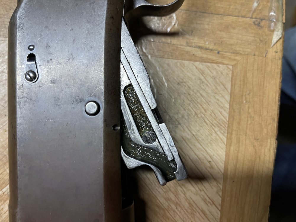

Nawlins Kid SASS #36107 Posted August 22, 2023 Author Posted August 22, 2023 The picture on the right is the action opened. The one on the left shows how far it goes it easily. From that spot up to about a 1/4 before going in full battery it starts to get harder to move the slide. If it goes in full battery I have to put it on the bench and use my full body weight on the forearm to get it to open
Yul Lose Posted August 22, 2023 Posted August 22, 2023 Work the slide enough to where you can back the screw out that holds the hook screw. Take the hook screw out and see if it is broken, it should have a smooth machined bottom surface. Compare it to the hook screw in my picture that I posted above. If it’s much shorter the hook screw is broken and the end is lodged in the hook. If it’s broken you’ll have to figure out how to get the tip out. I had one break that the tip came out rather easily and then the one on the 97 above that I posted. Both guns were hard to open as you describe.

Rough 'N Ready Rob Posted August 23, 2023 Posted August 23, 2023 Looking at your pictures it looks like the right shell stop screw is coming out allowing the shell stop to get out and stopping the carrer, be sure the shell stop is in position and tighten the screw.
