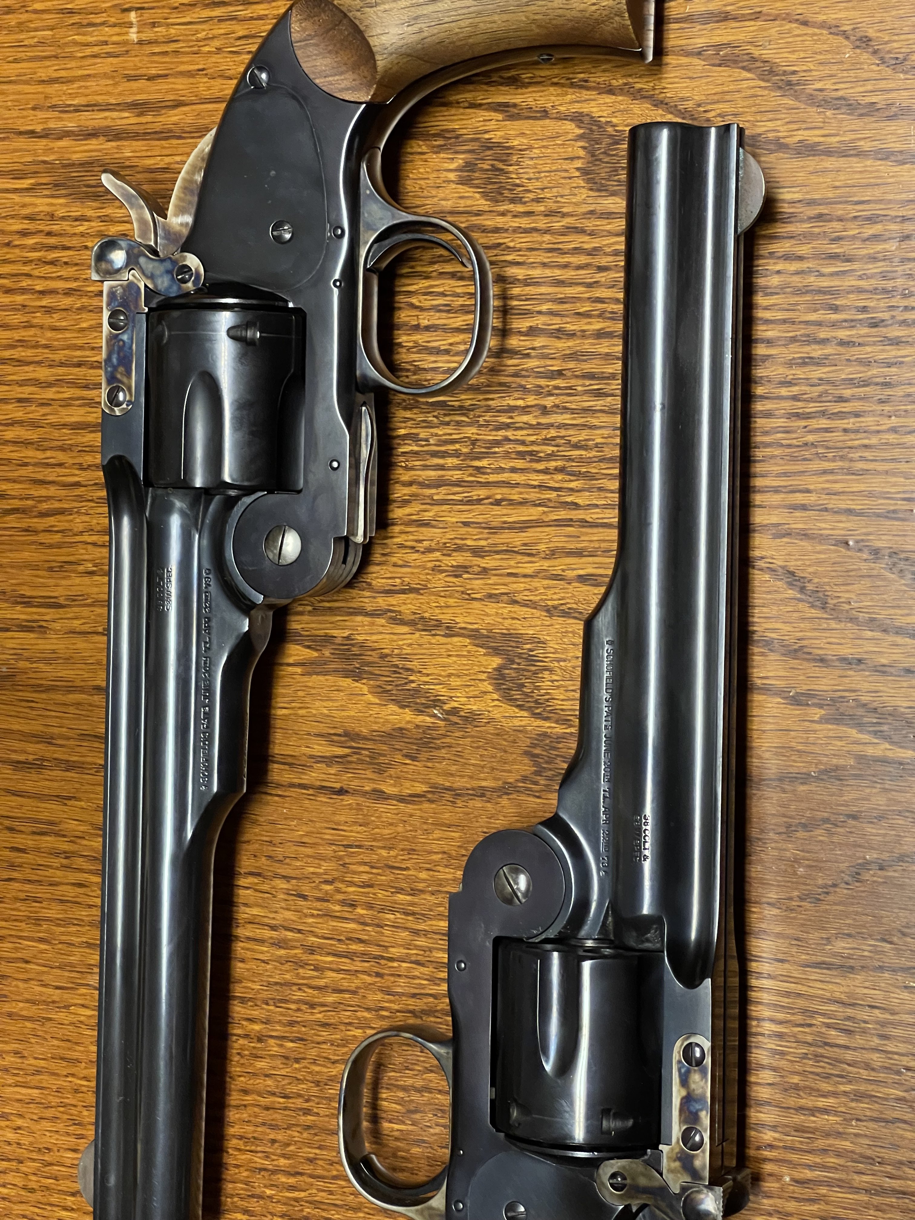

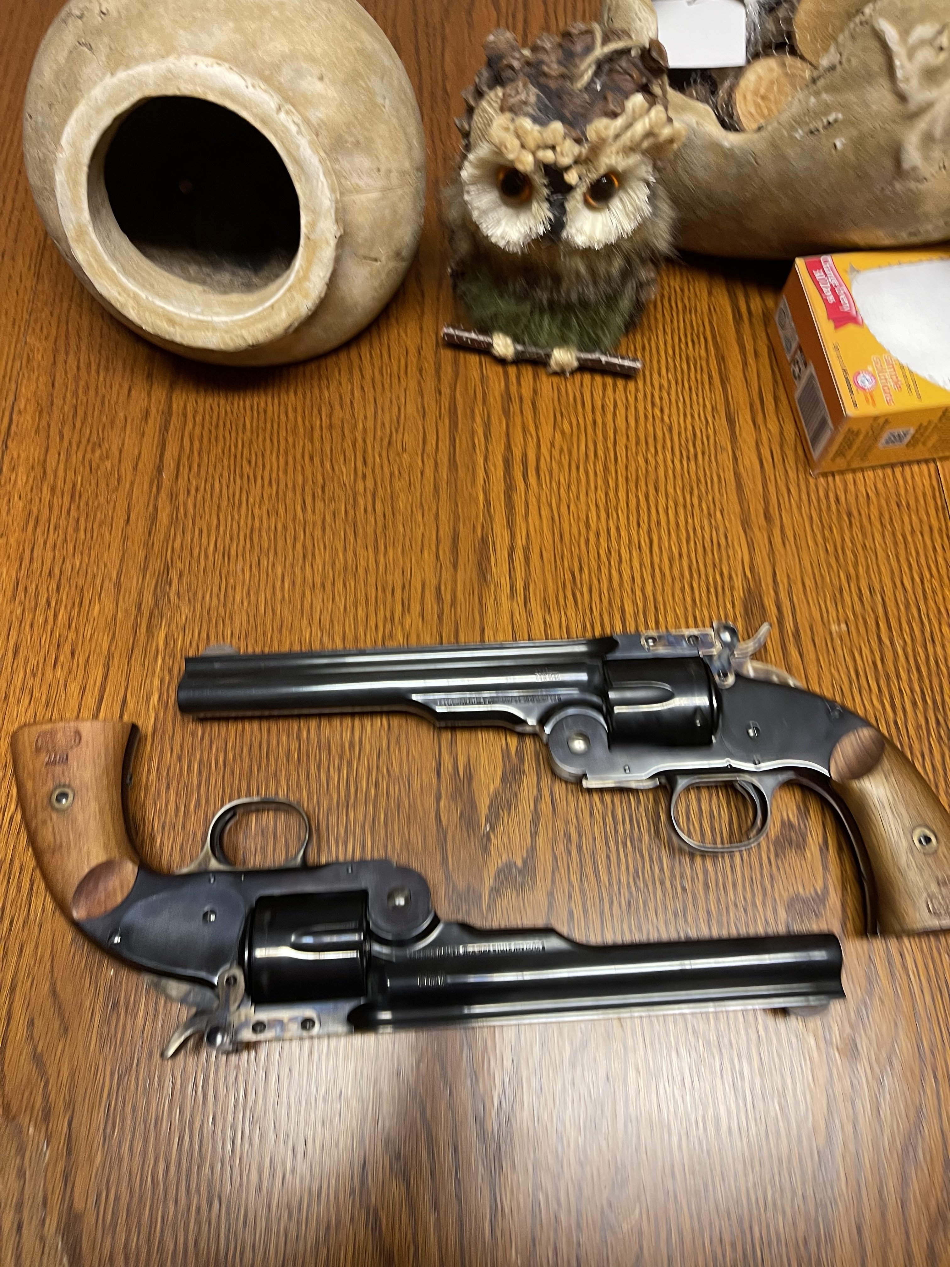

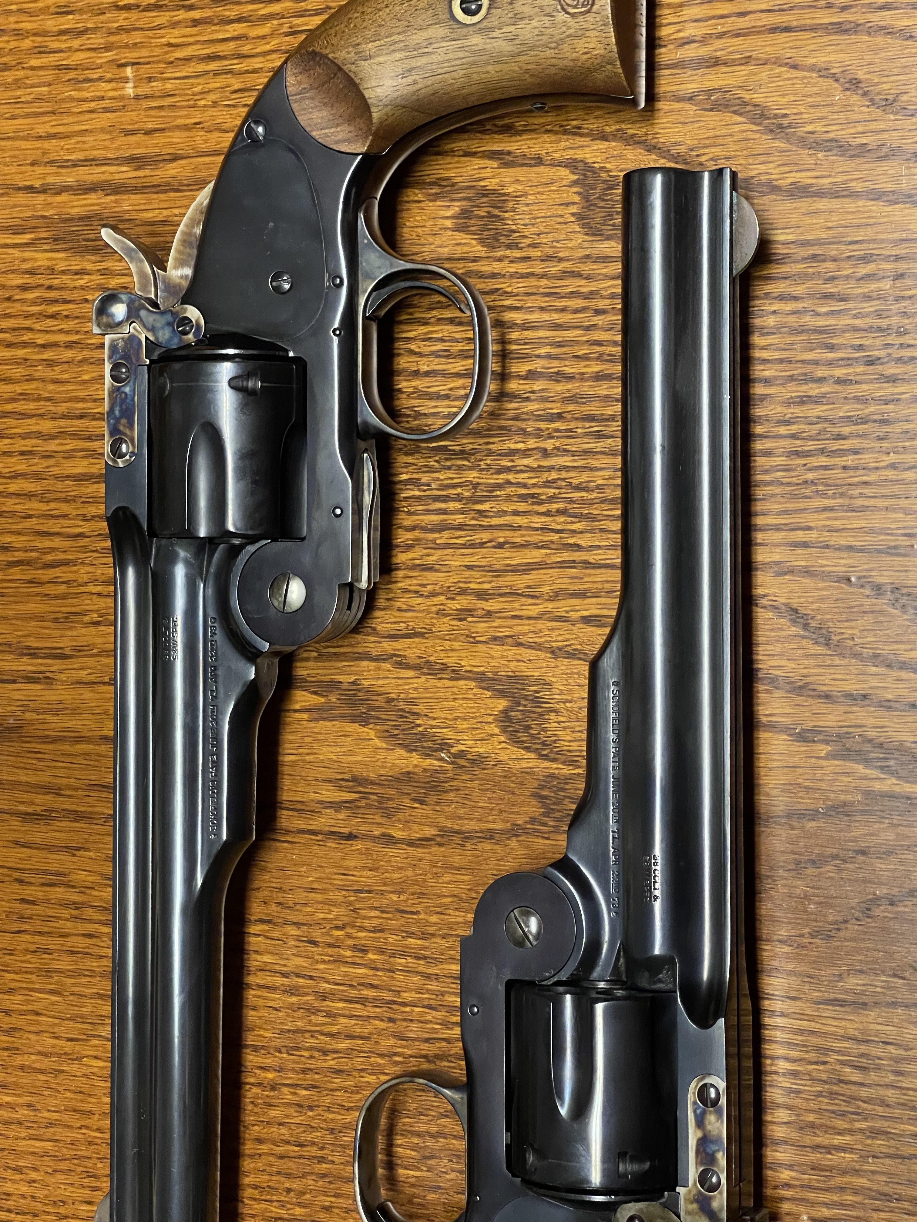

dokdoc #61722 Posted July 31 Author Share Posted July 31 Hi Rusty, Answer with pics and price, maybe….? Link to comment Share on other sites More sharing options...
Rusty Cuff Posted August 1 Share Posted August 1 Doc I’ll send you a PM Rusty Link to comment Share on other sites More sharing options...
