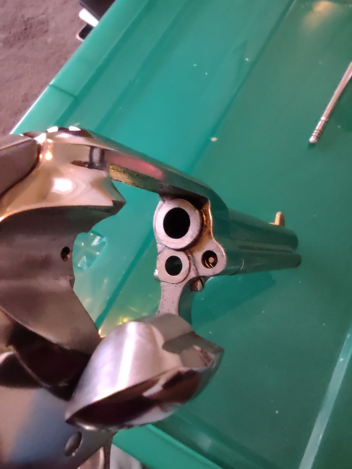

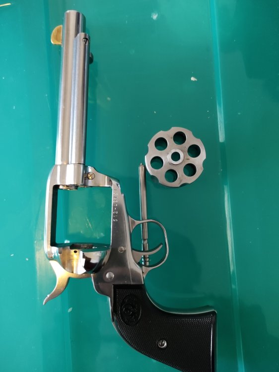

Orient Express Posted July 12 Share Posted July 12 I only started shooting (real) BP last year and shot a few matches with it. My one big concern was cleaning up afterwards. I've started liberally spraying my revolvers and SxS with Ballistol/water in between stages and below is the result at the end of a 5-stage match. At home I give it a quick wipe over with a rag. I can't complain about the results. I used to run hot water down through everything and then re-oil with Ballistol but now I won't bother. I'm not sure how the internals look though. Link to comment Share on other sites More sharing options...
Edward R S Canby, SASS#59971 Posted July 12 Share Posted July 12 Stainless steel is pretty forgiving with black powder fouling. I use household spray cleaner with vinegar. Moving parts are lubed with Ballistol. Never any rust. Bore snakes are washed and dried after every use. Link to comment Share on other sites More sharing options...
Prairie Dawg, SASS #50329 Posted July 12 Share Posted July 12 There's lots of ways to clean your guns after shooting BP, and most of them work pretty well. Find what works best for you, & go with it. Depending on the gun, I use Windex with vinegar, hot soapy water, moose milk, and a variety of patches, brushes, and q-tips. I relube the guns with Ballistol or WD-40, and it has worked for me for 40+ years --Dawg Link to comment Share on other sites More sharing options...
Erasmus Posted July 12 Share Posted July 12 I usually just use hot moose milk, or if things are particularly bad; soapy water (Dawn detergent) and THEN hot moose milk. I think that as the hot water evaporates from the moose milk it leaves behind a nice film of Ballistol. The only time I've had a rust issue was with shooting Pyrodex RS in my shotgun and cleaning with only water. Link to comment Share on other sites More sharing options...
The Original Lumpy Gritz Posted July 12 Share Posted July 12 Windex multi-surface with vinegar is the best BP cleaner made. Link to comment Share on other sites More sharing options...
Rooster Ron Wayne Posted July 12 Share Posted July 12 Looks good to me . I took all my guns apart and filled up the internals with Mobil one synthetic grease. I spray them down with Ballistol and water to keep them clean . The Mobil one synthetic grease keeps all the fouling out of the internals. I take them apart and clean the internals once a year . No problem ever found . So Saith The Rooster Link to comment Share on other sites More sharing options...
Garrison Joe, SASS #60708 Posted July 12 Share Posted July 12 I have no use for WD-40 on firearms, as it is not a lubricant. And not much of a rust preventative. Fine for breaking a nut free, though, if I can't find some PB Blaster. I clean BP with PAM mix. Hydrogen peroxide, rubbing alcohol and Murphy's Oil Soap in equal volumes. Don't have to re-oil after cleaning due to the oil soap. Very economical compared to most shooting cleaners. It's a great grease cutter on kitchen stoves and BBQ grills, too. good luck, GJ Link to comment Share on other sites More sharing options...
