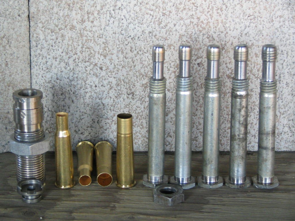

Three Foot Johnson Posted June 15 Share Posted June 15 Unless I was lucky enough to come across Bertram or Jamison .45-75 brass, I always formed mine from .348 cases, but it's kind of labor intensive. Anneal, expand, form, trim slightly long, shoot/fire form, and final trim. I found expanding with a single tapered expander would sometimes split the necks, so I turned out a 5 plug expander set to size them up incrementally - I should build new ones to replace the largest two or three due to the bolt threads on the plug, but it's never really been a problem. Larsen, at least 8% of your new brass is obviously fired... Link to comment Share on other sites More sharing options...
Pb Mark Posted June 16 Author Share Posted June 16 The multiple expanders look like a good way to get there with 348 brass. I used to have a John Linebaugh revolver built on a three screw 357 Max frame. The brass needed to be made using 348 cases. Making 45-75 will be interesting. Plan to start with 50 Alaskan Starline hoping for thicker brass than 348 but again, it's a new one to me. Very happy to be getting the Bertram brass. The couple fired cases were discussed via PM disclosure by Larson. Having this brass to inspect head space and do a bit of shooting sure takes the pressure off and allows for some playing making cases. Excellent help and thanks. Link to comment Share on other sites More sharing options...
