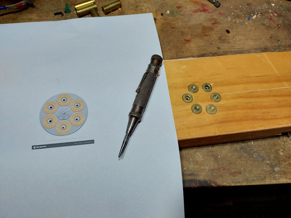

Sedalia Dave Posted April 24 Share Posted April 24 To get the spacing right you cannot eyeball the hole placement. The hole centers need to be exact. I have some software that I think I can make a template on that will give you the correct hole spacing with a precise point for the hole center. Let me try it tomorrow night and see if I can get it right. Link to comment Share on other sites More sharing options...
Buckshot Bear Posted April 24 Author Share Posted April 24 51 minutes ago, Sedalia Dave said: To get the spacing right you cannot eyeball the hole placement. The hole centers need to be exact. I have some software that I think I can make a template on that will give you the correct hole spacing with a precise point for the hole center. Let me try it tomorrow night and see if I can get it right. Thanks Dave that would be super appreciated mate! Link to comment Share on other sites More sharing options...
Oregon Ace Posted April 24 Share Posted April 24 1 hour ago, Sedalia Dave said: To get the spacing right you cannot eyeball the hole placement. The hole centers need to be exact. I have some software that I think I can make a template on that will give you the correct hole spacing with a precise point for the hole center. Let me try it tomorrow night and see if I can get it right. I sent him an accurate template Link to comment Share on other sites More sharing options...

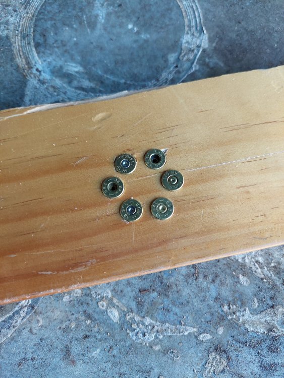

Sedalia Dave Posted April 25 Share Posted April 25 19 hours ago, Buckshot Bear said: Thanks Dave that would be super appreciated mate! Emailed a file this evening. You will need to watch the scaling when printing it. I put the correct dimension in SAE and Metric on the template. When I printed them directly from the program (VISIO) they came out exactly to scale. When I made the PDF and printed it, the scale was off. Took a a lot of experimenting with the printer settings to get the scale to come out correctly. It would be easier to print them and then use a copier's enlargement function to get the scale back to 100% I will attach it here in case someone else wants to use it. It is to scale for a Ruger Vaquero chambered in 38/357 Buckshot Bear.pdf Link to comment Share on other sites More sharing options...
Crooked River Pete, SASS 43485 Posted April 25 Share Posted April 25 On 4/21/2023 at 7:06 PM, Buckshot Bear said: Lathe fail If I had access to a lathe I would turn a mandrel just small enough to go into the case. Put the case with the mandrel in it into the chuck mouth first ( rim out ) and cut it off with a parting tool. Link to comment Share on other sites More sharing options...
