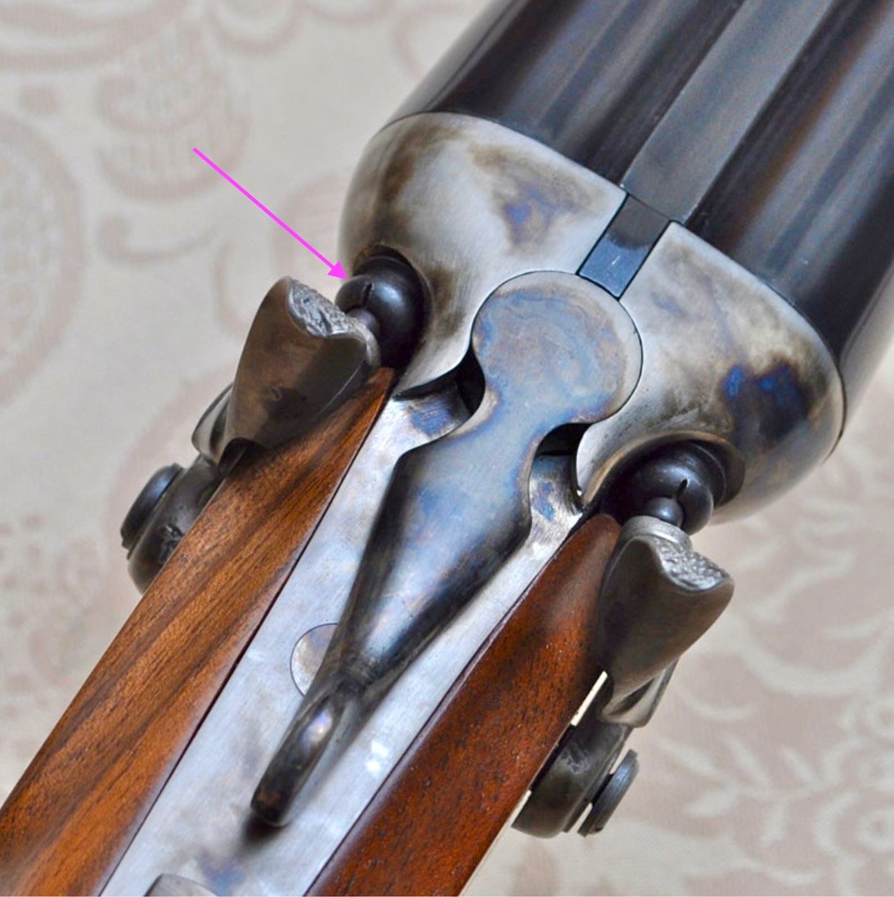

Bitterroot Jak Posted April 8 Share Posted April 8 I have the same shotgun, after several hundred blackpowder rounds I started having the same problem. I found the firing pin retained nut was coming loose. I now check it before every match. (small screwdriver) No problem since. Link to comment Share on other sites More sharing options...

Cold Lake Kid, SASS # 51474 Posted April 12 Author Share Posted April 12 On 4/7/2023 at 10:59 PM, Bitterroot Jak said: I have the same shotgun, after several hundred blackpowder rounds I started having the same problem. I found the firing pin retained nut was coming loose. I now check it before every match. (small screwdriver) No problem since. I found that issue some time ago and they are tight. (Pedersoli suggested I use Locktite on the threads) On 4/9/2023 at 11:01 AM, Garrison Joe, SASS #60708 said: JB Weld would last a couple of matches. Epoxy does not take impacts well. A drill rod sliced into a thin washer and brazed/silver-soldered/tig-tacked on the face would last forever. good luck, GJ That seems like a solution, if my G'smith can do it. We're down to one around here. I'll try to order some new hammers as well, just in case. Thanks Pards. Link to comment Share on other sites More sharing options...
