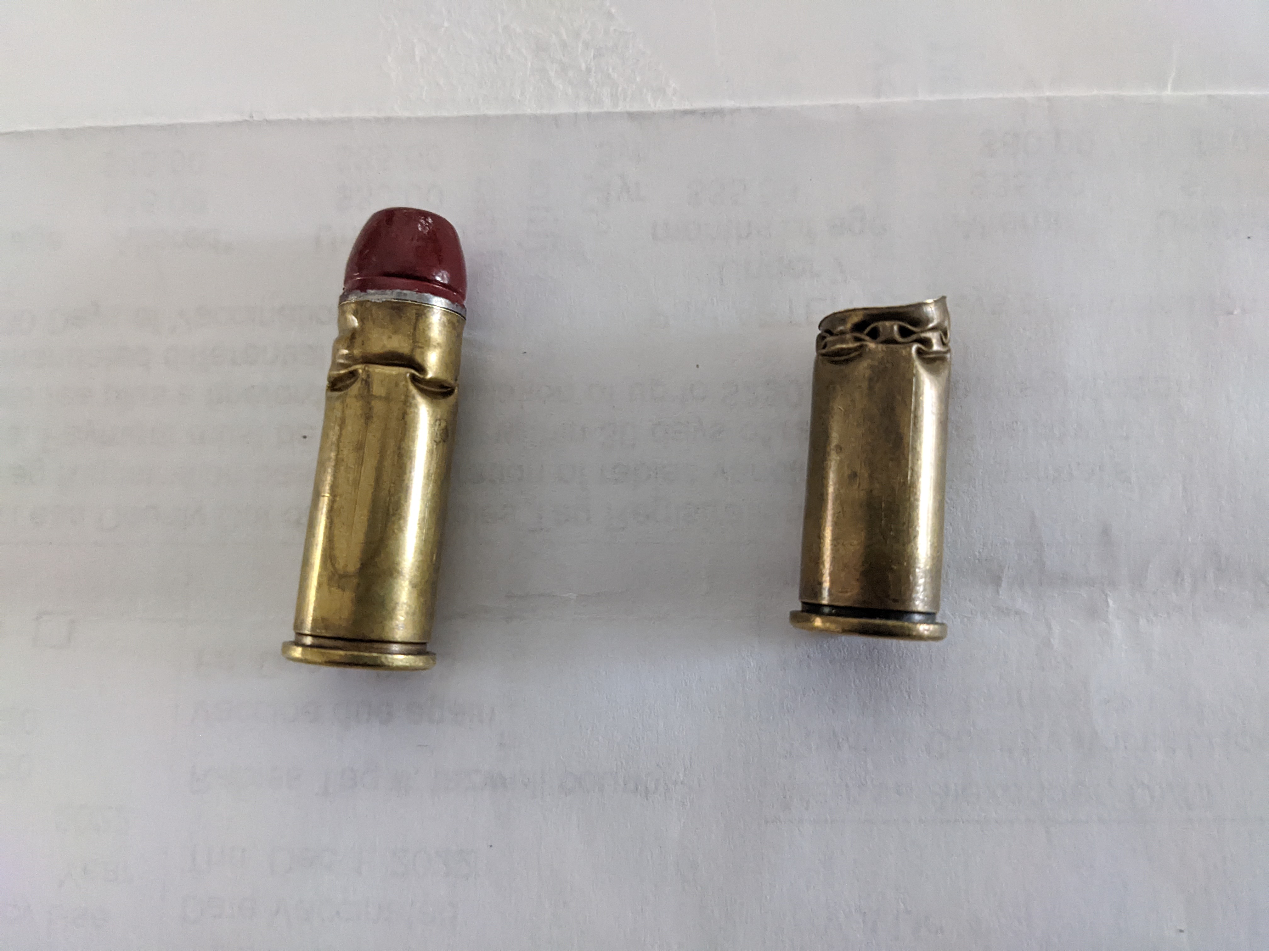

Slip Hammer Yates 8456 Posted March 4 Share Posted March 4 I recently traded a couple 450s and square deals for this new 750. The 44/40 conversion is used. I have loaded 44/40s for years with very little problems on a square deal. The Redding 44/40 dies I never used until I got the 750. I wad reloading this am and crushed several cases. The picture is an example. I tried adjusting dies, the shell plate and belling the case. So any idea what I am doing wrong? The other problem at times it seems the primers are going in at an angle sometimes causing one side of the primer to ride up and over the pocket. Link to comment Share on other sites More sharing options...

Springfield Slim SASS #24733 Posted March 4 Share Posted March 4 First thing I noticed is the coating is scraped off at the bottom of the bullet showing above the case. So it seems either your bullets are too large a diameter or your dies are too small, or both. Maybe you can still use them if you bell the cases a bit more, maybe not. Are you seating and crimping with one die or 2? Link to comment Share on other sites More sharing options...

Ya Big Tree Posted March 4 Share Posted March 4 Are the bullets .427 diameter or .430 diameter? If .430 you will need a 44 Magnum expander in the sizing die to open it up enough for the larger diameter bullets. Mainly It looks like it's trying to crimp to soon as it's seating the bullet. Will the bullet load into the case ok with the roll crimp backed off? Link to comment Share on other sites More sharing options...
"Big Boston" Posted March 4 Share Posted March 4 IIRC I had a similar issue when I was setting up my 550. A 550 is not entirely the same as a 750, but Redding dies are pretty consistent. I'm a bit fuzzy on the details but this is what I think I found. My Redding seating die was the issue. I'm guessing the seating die is designed for 0.425" or 0.426" bullets and my grooves were more like 429 - 430. So what happened was that the bullet was getting stopped before it even hit the seating plug. This is my set-up now, I use a LEE FL die, with about 050 trimmed off the bottom, (it only needed about 010, but I didn't want to have to do the grinding twice. For the powder i ended up buying a 44 mag expander to make things work correctly. Then i seated with a LEE seater as it had lots of clearance. I had to flatten the seating stem to keep from marking the bullet. Then for crimping, i used the Redding seating die. After the bullet is seated, it works ok with my bullet. But I still like the 44-40, but it is a red haired stepchild. BB Link to comment Share on other sites More sharing options...

Garrison Joe, SASS #60708 Posted March 5 Share Posted March 5 Bell with a die that lets you get at least a flare that measures 0.431" inside diameter, and that the button for expanding will make sure you can hand seat a bullet into the mouth at least 1/3 of the way to final position. MEASURE the bell with a caliper, not eyeball it. Measure the diameter of the expander button. If it is not 0.430 or .431, you need a BIGGER diameter button (or a whole new die) to expand that case neck. A .44 magnum button will be the right size! Publish us a pic of the expanded and belled case. Put in the measured ID's from your calipers for the belled mouth and the expander button. If you are using the Dillon "powder funnel" die for .44-40, that is probably the major problem. You need to have them send you a powder funnel for .44 mag. Seat with a standard seater die, and make sure the mouth is left a couple of hairs short (at least 0.010") of any bullet land above the crimp groove. This die is the LEAST critical, but make sure NOT to let it crimp! And to not let the mouth of cases jam into the lead of a land on the bullet. Post up a picture of the bullet seated in the case, getting real close like you did with the crumpled cases. This is not a place to try to use the Redding Profile Crimp die to do the seating.... it WILL NOT work well for that. Crimp in next step at next station. Now, a Redding Profile Crimp die at this station will work most easily for crimping - NOT a Redding seater die. If you have confused the two, straighten yourself out. A Lee factory crimp die can be made to work in most situations. Neither of these two dies will seat a bullet well. They are crimpers only. Only turn the crimp into the crimp groove until the brass no longer sticks out proud of the bullet. Post a picture at this step, too. Crumpled cases indicate that you are getting some crimp when seating the slug. Although heavy wall cases can stand this, a .44-40 with very thin brass will not stand up to this. All this picture posting will help us help you. Because it will make you take a closer look, and it will let us see for our own selves. Quote primers are going in at an angle If your shell plate is not traveling fully to the detent stop, you can have problems getting the primer to come up into the primer pocket. Sounds like you need to clean the shell plate area, the detent ball area, and watch real closely that you are getting the proper amount of rotation on the shell plate! good luck GJ Link to comment Share on other sites More sharing options...

Savvy Jack Posted March 5 Share Posted March 5 Looks like a chevy 350 piston trying to get pushed into a VW cylinder. My guess would be a .429 or a .430 lead bullet getting shoved into a case neck resized for .4255" jacketed bullets. Link to comment Share on other sites More sharing options...

Slip Hammer Yates 8456 Posted March 5 Author Share Posted March 5 I am loading commercial bullets that are sized .430. I bet the die is part of the problem in that they are set for a real 44/40 at .427. Although I have had these dies for awhile, I never used them as I always loaded on a square deal where I never had a problem. A number of ideas have been suggested which I will look at one by one. Thanks for the input. Link to comment Share on other sites More sharing options...
Larsen E. Pettifogger, SASS #32933 Posted March 5 Share Posted March 5 Dillon has two neck expanders for use with the .44-40. If you are using .425 - .427 you need a number 4. For .429 -.430 you should be using the G expander. Link to comment Share on other sites More sharing options...

Cypress Sam, SASS #10915 Posted March 5 Share Posted March 5 As others have noted, 44 mag bullets are larger Han than 44-40. Try using a 44 mag powder funnel/expander die. (And a little more case bell). Link to comment Share on other sites More sharing options...

Slip Hammer Yates 8456 Posted March 13 Author Share Posted March 13 I want to thank everyone for their suggestions. I got it figured out. I was not flaring the case mouth enough. I measured and it was only .425 or six. Flared it to .431 using a 44 mag g powder funnel. I load 44mag/sp on this machine too. I used the 44 mag seating die to seat the bullet and then used the 44/40 seating die to crimp. At this point this seems to be working although I was advised not to use this die for crimping. We will see if I change this later. In addition as suggested I got a slight hitch in my giddy up between the down and up stroke which smoothed the operation out. I also adjusted the shell plate and took some of the wiggle out of the cases. Finally I adjusted the plate so it would line up better with the primer pocket. It didn't seem to be off much at all but evidently enough. So I finished reloading my 44/40 and broke the machine down to set it up for 9mm. We will see how that goes. Link to comment Share on other sites More sharing options...
