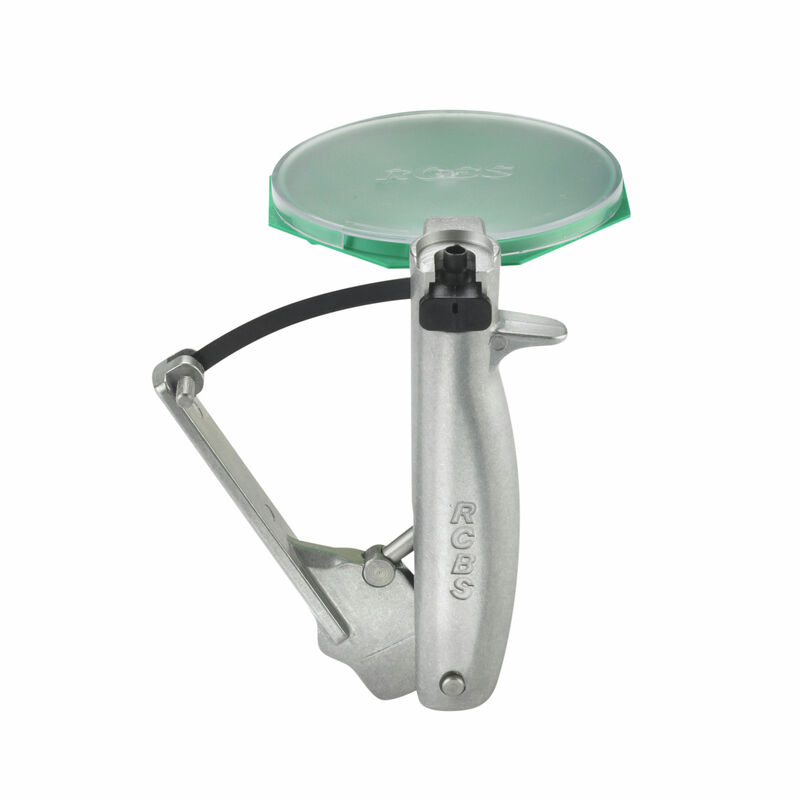

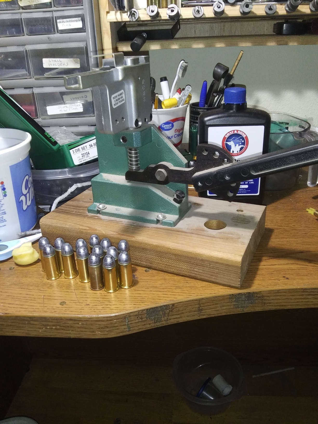

Fallon Kid Posted February 19, 2023 Posted February 19, 2023 Just maybe some helpful info for anyone getting into CF 56-50 Spenser. I have/had the hots to get a Spenser Carbine and I got one from Dixie. (Great Folks) It is an Armi Sports. I chose to go with the near original cartridge because I can and there is nobody to tell me NO. I got the Lyman 515139 340 mold but casts drops at 350gn and .515 dia. I’m using a blended lead at 12BHN. I slugged the gun (mfg states rifling at .512) and a .515 un-sized bullet tapped through quite easy. I had to finger lube bullets as my lube/sizer die is being made by Buffalo. I went with a custom .513 sizer for my Lyman lube/sizer but after slugging I might should have went with a .515. More later to be told. I found out I did not have anything to install primer. The shell holder is too big to fit into the RCBS hand primer and I’m not springing for a Red or Blue shell plate. God has been good to me but I have not been that good. LOL Fortunately I have an RCBS APP Primer which I never thought I would ever use again. Here is the point to get across if you are getting into 56-50 or 50-70. Make sure you got a way to primer. Anyway I just did 14 rounds with 40gn of 2FF and I seated 1.580 OAL. Anyway just a few tid-bits I wish I knew going into this. I don’t regret one thing as I love getting any new caliber in my sea bag. You can never have enough guns. Thanks, Jerry 7 Quote

Sedalia Dave Posted February 19, 2023 Posted February 19, 2023 I have the RCBS 90200 hand primer and it will prime 56-50 Spencer as well as 59-90 Sharps brass. I use the #31 shell holder. Both RCBS and Lyman make 56-50 dies. The RCBS dies are what you want for the Taylor's 56-50 cartridge. The Lyman Dies are made from cut down 50-70 Govt. dies and will not properly crimp the brass unless you are using bullets over .515 in diameter. I use the RCBS dies for my Spencer reproduction and a combination of RCBS 50-90 Sharps and the Lyman 56-50 dies for my original Spencer. 1 Quote
Fallon Kid Posted February 19, 2023 Author Posted February 19, 2023 Thanks for reply. Right now I only have a Lyman x22 shell holder but have an RCBS 31 on order. Again thank you. I feel a bit more comfortable. That's why the Pros are on this site. You guys know everything. Quote

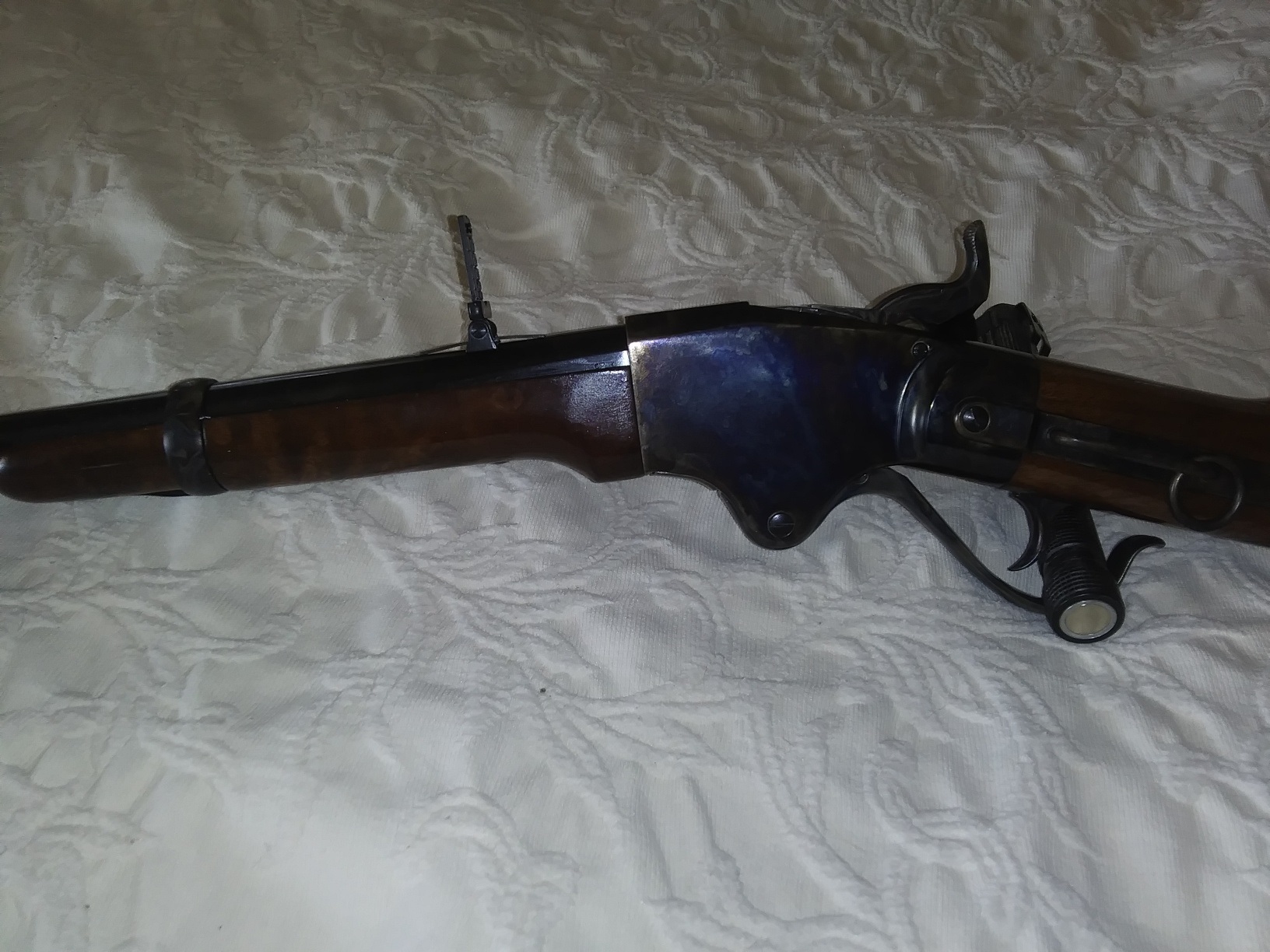

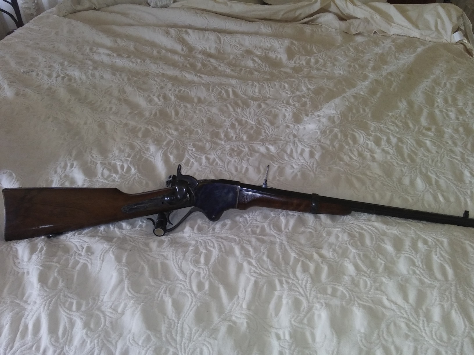

Fallon Kid Posted February 19, 2023 Author Posted February 19, 2023 Pics. You got it. Rifle seems really small but think it will be great for big bore option. As bad as I shoot I should have been looking for an 88mm. LOL Life is good. 1 1 Quote
