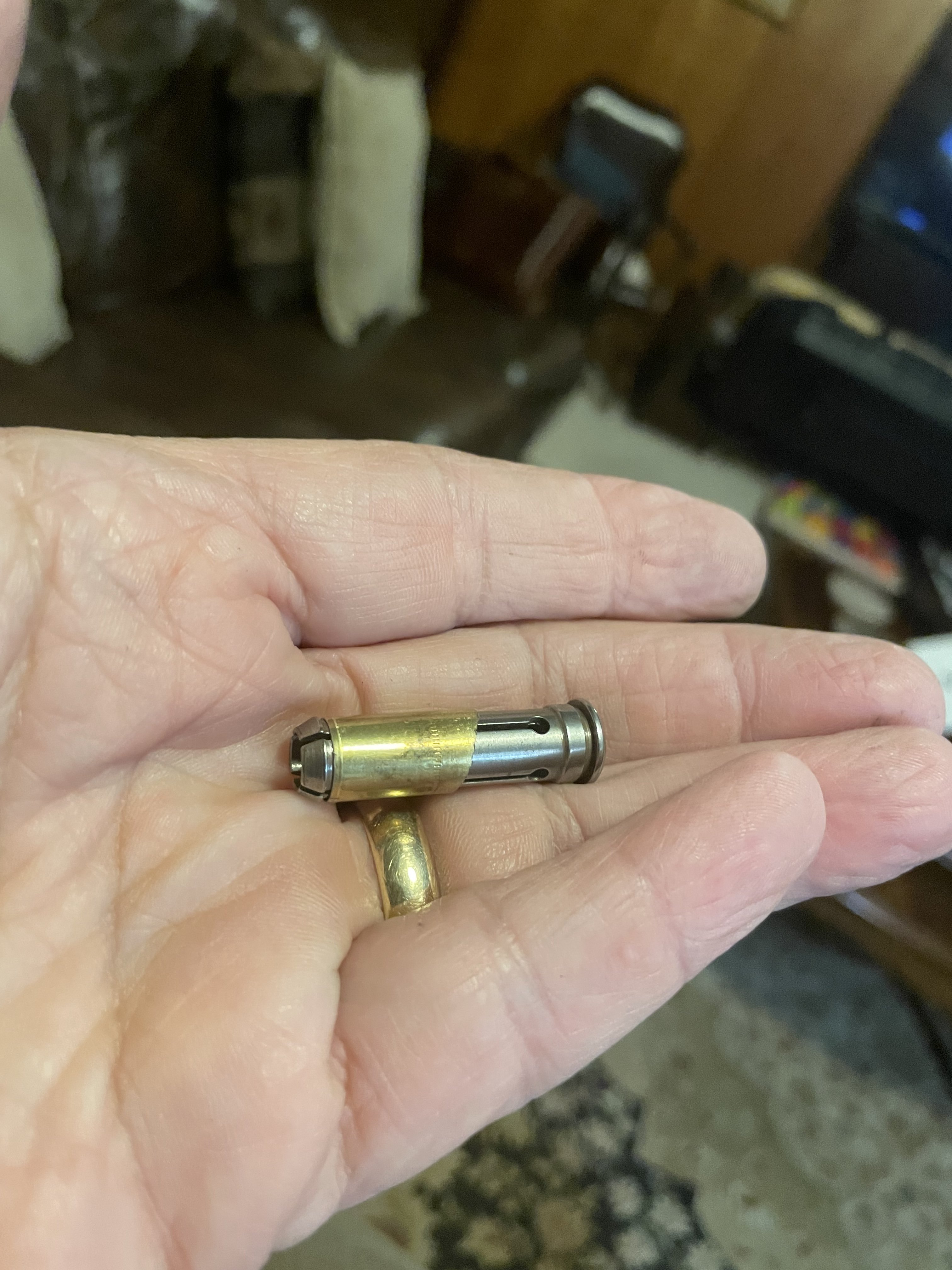

Hoss Posted February 17 Share Posted February 17 I had one last week in 38sp. This handy tool worked! Link to comment Share on other sites More sharing options...
DeaconKC Posted February 17 Share Posted February 17 I think this was a stuck case, not a separated one. Link to comment Share on other sites More sharing options...
Sedalia Dave Posted February 17 Share Posted February 17 1 hour ago, Hoss said: I had one last week in 38sp. This handy tool worked! They don't make one of those for dash calibers. Link to comment Share on other sites More sharing options...

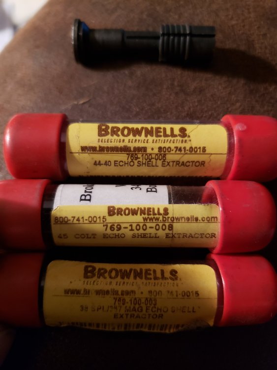

El Mulo Vaquero, SASS #55942 Posted February 18 Share Posted February 18 I have 44-40, 45 colt, 38/357 Echo Broken shell extractors, W J Riebe Co. Though not made anymore. Would be nice if they were still available. They have saved many a rifle over the years at matches, I carry them in my gun cart. Link to comment Share on other sites More sharing options...
