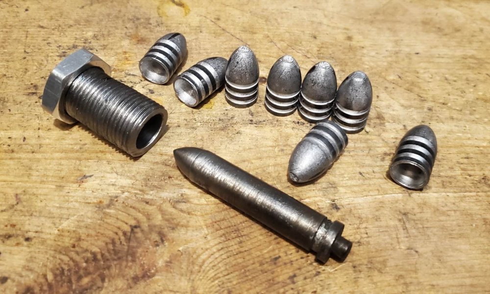

Three Foot Johnson Posted January 31 Share Posted January 31 I bought a repro 1861 Springfield some years back, and a 500 grain cast Lyman 58 cal Minie (575213), plus another no-name brass 450 grain mold, are too large to push down the bore without a ramrod and a small rawhide or plastic hammer, so I turned out a sizer and pushrod to fit my RockChucker press. The die came out just a tad large, and after a couple shots w/o swabbing, the bullet takes a little encouragement to get down the barrel. A machinist I'm not, but stuff like this isn't that hard, so maybe I'll make another one a couple thousandths, smaller... maybe .005"... whatever works. In my experience with two different hollow base Minie designs, they are a royal PITA to cast. Link to comment Share on other sites More sharing options...
