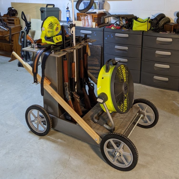

Mister Badly Posted January 31 Share Posted January 31 This is my fan wagon. Tennessee summers make it a very popular place to stand by. 3 Quote Link to comment Share on other sites More sharing options...
