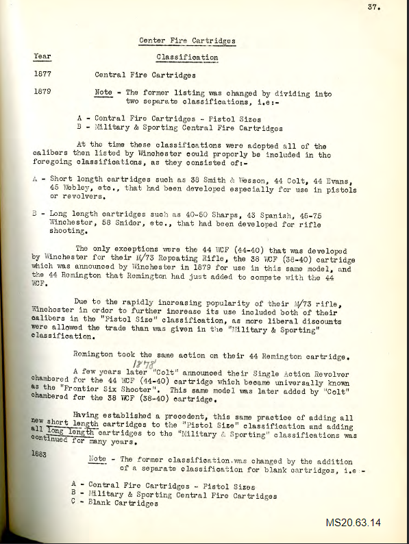

Warden Callaway Posted January 19 Share Posted January 19 I always considered the 44WCF a rifle cartridge because it was introduced in the Winchester 1873 rifle. Then in many other rifles. A buddy that collects antique Winchester guns gave me a handful of very old 44WCF and 38WCF cartridges. The primers are small and seated below the base. My reloads in Starline with large pistol primers seat below flush with base because I want my primers to be seated on the bottom of the pocket. The only reason I can think of for setting the primers deeper is so the bullet of the next cartridge does not hit against the primer in front on a tube magazine. 2 2 Quote Link to comment Share on other sites More sharing options...
H. K. Uriah, SASS #74619 Posted January 19 Share Posted January 19 Hmm... .44-40 revolvers. (antiques) 1 1st Gen Colt 1 Merwin & Hulbert 1 S&W Model 3 DA 1 S&W New Model 3 1 Colt 1878 (modern) 1 Uberti Clone 1 3rd Gen Colt 1 3rd Gen Buntline, .44 Special with .44-40 Cylinder 2 3rd Gen Sheriff's Model, .44 Special with .44-40 Cylinders I use Winchester primers, the ones labeled "For use in standard or magnum loads." They always go bang in all of the above. Don't know what that means, if anything. Quote Link to comment Share on other sites More sharing options...
Garrison Joe, SASS #60708 Posted January 19 Share Posted January 19 (edited) Well, you got me interested enough to check the SAAMI standards/guides. All the "dash-caliber" cartridges are considered by SAAMI to be rifle cartridges. That of course was the original usage. The only centerfire cartridge that I find which has a dual-purpose use, showing up in both the Pistol guide and the Rifle guide, is the .44 Rem Magnum. If what Starline has in mind is that loaders ought to load .44 WCF (aka .44-40) with rifle primers, then perhaps it makes sense that they recommend the primer that is commonly recognized as being the easiest to fire (Federal) when using the cartridge in revolvers, where firing pin strike force is much less than in rifles. And maybe this general information SHOULD be included in the other "Dash" cartridges when used in revolvers. But if that is what they are advising (and how they are making brass), it would be better if they clearly stated that! Looking through loading manuals, several of them that specify the type of primer used (at least for their load testing), call out large pistol primers in .their .44-40 section found in the rifle pages. Interestingly, the .44 Rem Magnum also calls for Large Pistol primers when it is listed in pistol or rifle pages. The SAAMI standards seem to leave open a loophole for proper size of primer to use in cartridges that have common use in both rifle and handguns. Seems Starline may be "bucking the trend" of forming .44-40 brass with pistol length primer pockets and doing their own thing (rifle size pockets). Does anyone want to measure primer pocket depths in all those "Dash" cases to see what they run both in Starline and some of the other manufacturers' brass? good luck, GJ Edited January 19 by Garrison Joe, SASS #60708 1 Quote Link to comment Share on other sites More sharing options...
