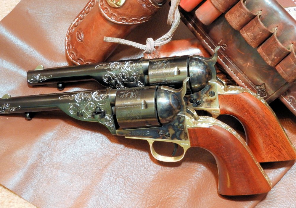

Redleg Reilly, SASS #46372 Posted November 1, 2022 Share Posted November 1, 2022 I've been shooting these two open tops for almost 2 years now. Great guns! Mine wouldn't reseat the primers everytime when I first got them. Raised the power charge a bit and they are cured. Best pointing revolvers I own. Link to comment Share on other sites More sharing options...
