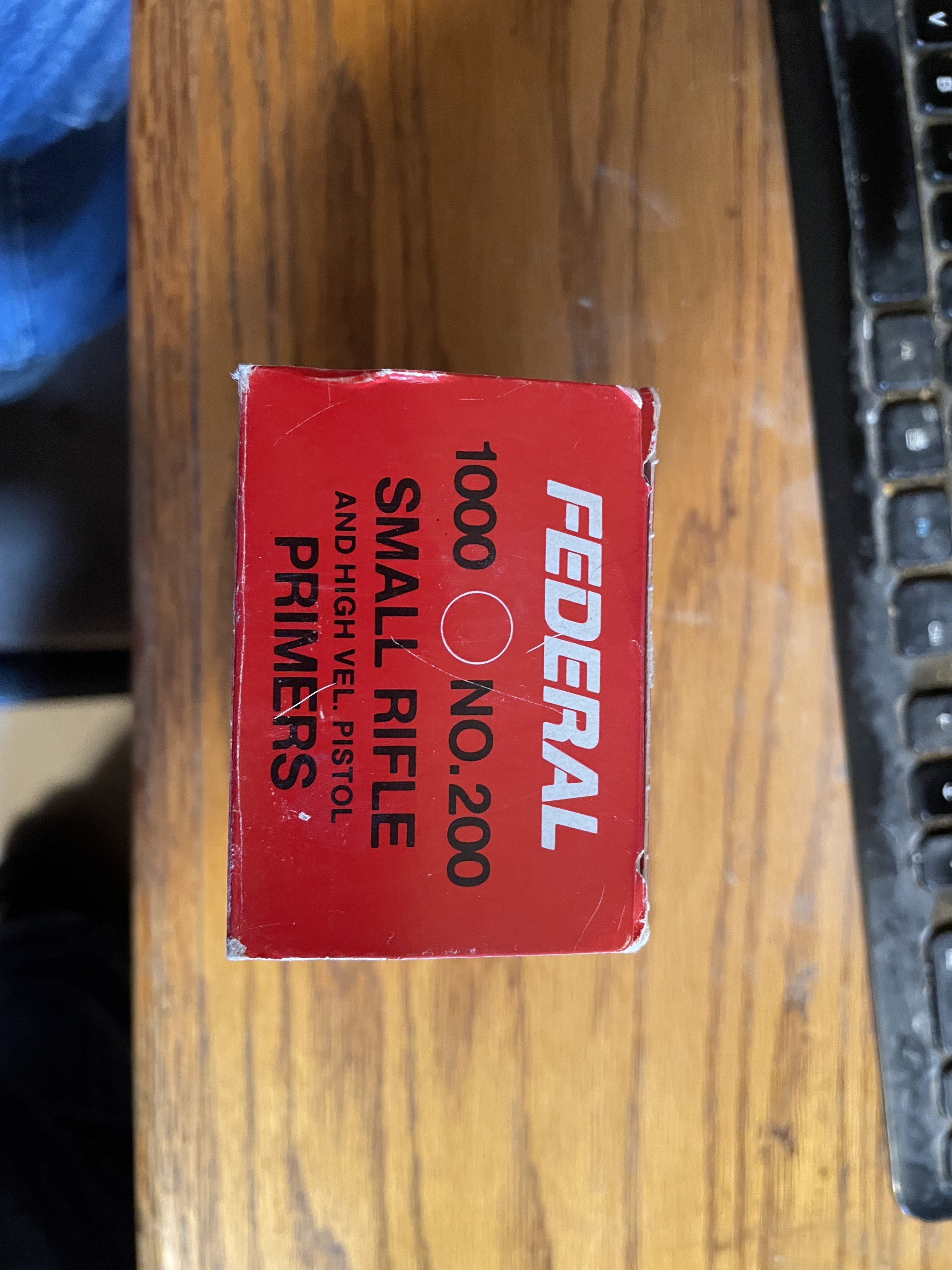

Skullbone Willie Posted October 23, 2022 Share Posted October 23, 2022 I’ve seen no difference in standard or magnum primers, large or small. I’m mostly using small rifle primers in my 38’s because that was all I could get when I started this adventure this time last year. Quote Link to comment Share on other sites More sharing options...

Cliff Hanger #3720LR Posted October 24, 2022 Share Posted October 24, 2022 2 hours ago, Tulsey, SASS#11236 said: One poster on this thread mentioned using small rifle primers in 38 pistol cartridges. Small rifle and pistol are about the same size with different hardness and flash potential. Large pistol and Large rifle are not the same size Having reloaded commercially for more than 18 years for cas shooters, this perceived difference in small magnum pistol primers and small rifle primers (non magnum) needs to be addressed. Read the manufacturer primer specs. These two primers are exactly the same from each manufacturer. Only the box labels are different. Small Magnum pistol primers and small Rifle primers use the same cup so there is no difference in cup hardness. The harder cup is for the higher pressures produced at magnum velocities. 38 special maximum pressures is listed at 17,500 psi. The magnum (that would be 357) maximum pressure is listed at 35,000 psi. 3 3 Quote Link to comment Share on other sites More sharing options...
The Original Lumpy Gritz Posted October 24, 2022 Share Posted October 24, 2022 (edited) 9 hours ago, Tulsey, SASS#11236 said: One poster on this thread mentioned using small rifle primers in 38 pistol cartridges. Small rifle and pistol are about the same size with different hardness and flash potential. Large pistol and Large rifle are not the same size SP and SR are the exactly the same size. LR is taller than LP. Edited October 24, 2022 by The Original Lumpy Gritz 1 Quote Link to comment Share on other sites More sharing options...
