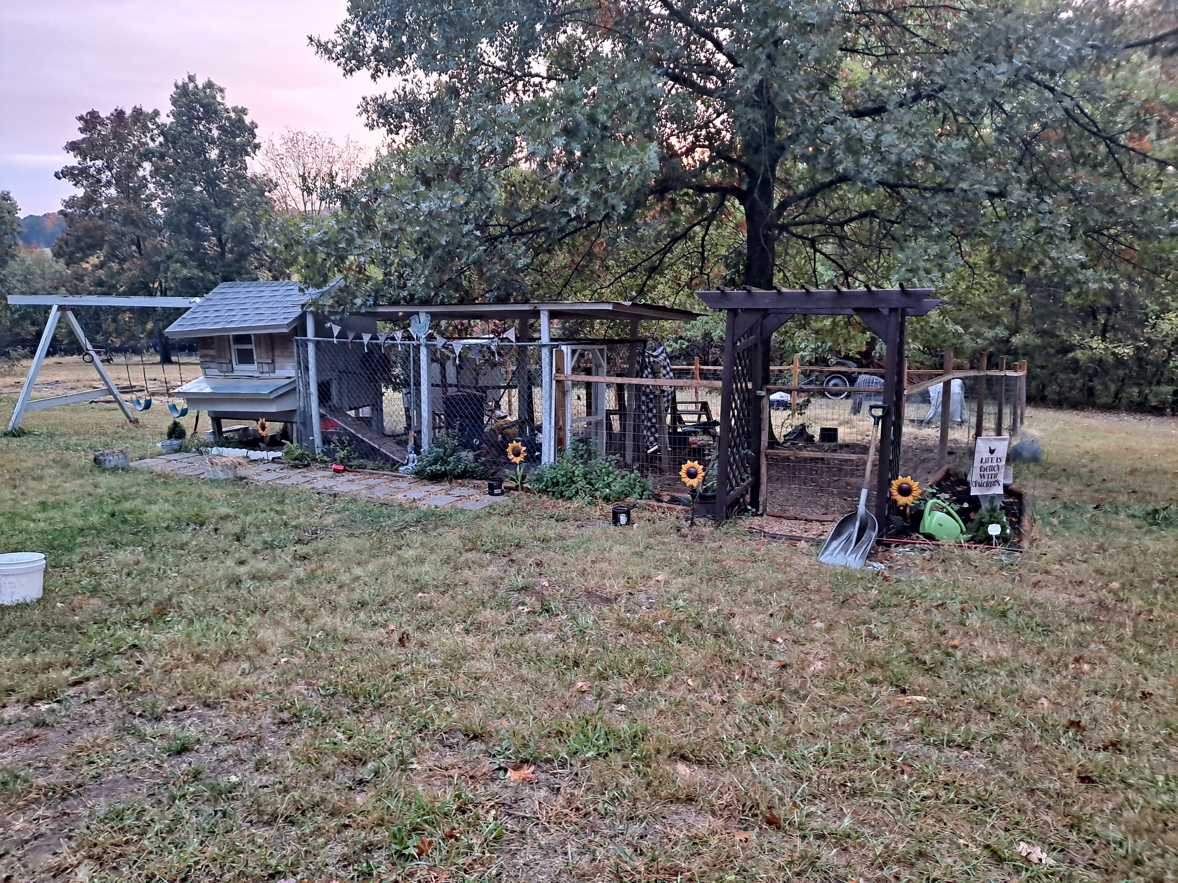

Chief Rick Posted October 11, 2022 Posted October 11, 2022 Starting to re-build and reinforce the run and coop. Does anyone have any firsthand experience with solar-powered electric fences? Our run is about 50 yards from the nearest power source. While I could run a dedicated power line from an outside power panel, I'd rather not.

Chief Rick Posted October 11, 2022 Author Posted October 11, 2022 6 hours ago, Texas Joker said: I use one. I found it cheaper to buy a 12v charger/zapper and use a pwm charge controller and 20 watt ebay panel with a spare 12v battery. I assume this is for your chicken coop? Since my min run fence is dug in I used that as a ground and a knee wire as the positive. Yes, gonna set a wire around the coop and run. Probably looking at 75-100 ft total.
