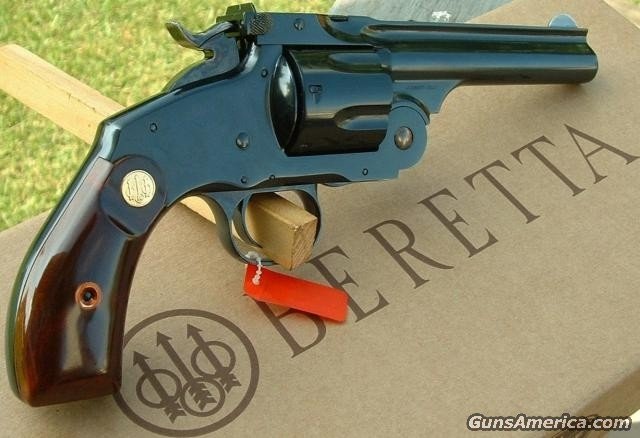

Long Gun Preacher Posted February 12, 2022 Posted February 12, 2022 (edited) Although I wasn't looking, I came across one of my "unicorns"-a Beretta Laramie in 45lc. In 5 inches. I've never owned a top break and would appreciate any advice from fellow shooters as to holsters, shooting, etc. With thanks (the pic is of a stock gun. Not mine) . Edited February 12, 2022 by Long Gun Preacher 1 Quote

Driftwood Johnson, SASS #38283 Posted February 12, 2022 Posted February 12, 2022 (edited) Howdy The Laramie is a replica of the Smith and Wesson New Model Number Three. S&W cataloged this model from 1878 until 1913, although all frames had been made prior to 1899, so as far as the BATF is concerned they are all antiques. In my very humble opinion the NM#3 was the best of the five separate Top Break models that S&W made on the large, #3 frame. The grip frame is much easier to deal with than the awkward grip of the Russian Model, and the originals had a rebounding hammer. The New Model #3 was chambered for 17 different cartridges, 44 Russian being the most common. It was never chambered for 45 Colt. I have two of them, the blued one left the factory in 1896, the nickel plated one shipped in 1882 and was refinished at the factory in 1965. Both are chambered for 44 Russian. Interestingly enough, the Laramie has a windage adjustable rear sight, but the standard half moon shaped front sight. I'm still kicking myself over this New Model Number Three Target Model that I passed up buying a few years ago. Notice the target rear sight as well as the target front sight. I had a pair of Slim Jim holsters made by El Paso Saddlery. Obviously, I have had this holster for quite a while. I had El Paso line the insides of the holsters and spent a little more money on border stamping. El Paso is not cheap, their holsters are top quality. You have the choice of left or right, belt width, russet or black, and cross draw or straight hang. One thing I learned a long time ago shooting any S&W Model 3 revolver, they all tend to shoot high. This is because the front sight is so low. I have to remember to hold on the bottom half of a CAS target or the shot may go over the target. I only shoot my #3 Top Breaks with Black Powder. They were designed for Black Powder and I can shoot them all day long without them binding. Most shooters report that because Uberti (yes, the Laramie was made by Uberti, but marketed by parent company Beretta) messed with the design of the cylinder bushing at the front of the cylinder, all of the replicas of the #3 Top Breaks tend to bind up quickly when shot with Black Powder cartridges. Edited February 12, 2022 by Driftwood Johnson, SASS #38283 4 Quote

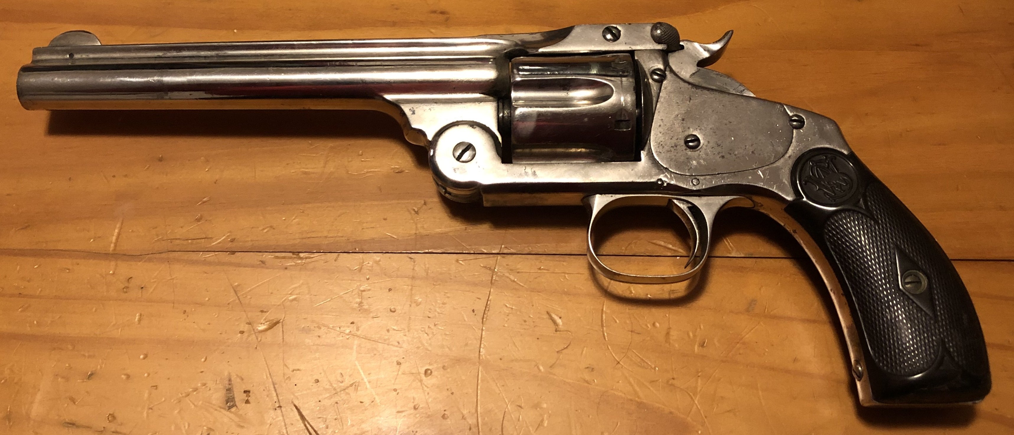

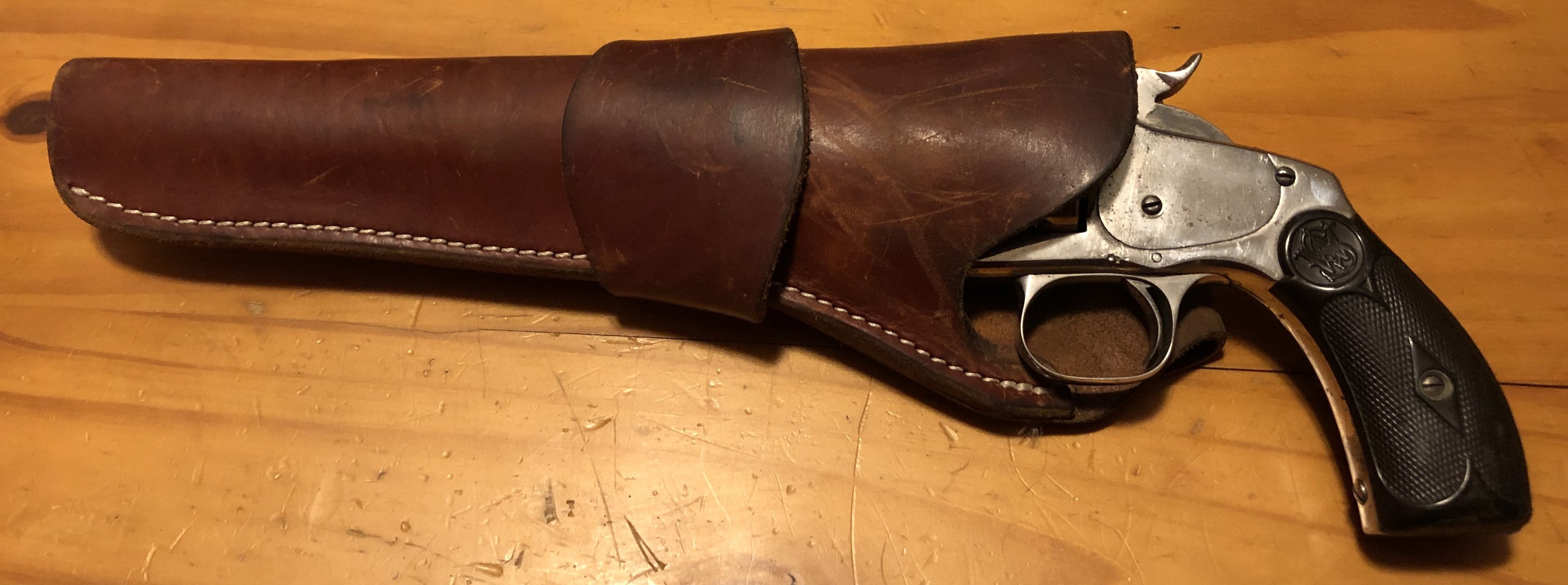

H. K. Uriah, SASS #74619 Posted February 12, 2022 Posted February 12, 2022 As Driftwood pointed out, the Laramie is a reproduction of the S&W New Model 3. I have two of them, one with standard sights in .44-40 an and a target sight model in .38-44, which basically a .38 S&W case made as long as the cylinder. This is the .44-40 with standard sights. This is the generic holster I got at Cabelas for 10 bucks. Pretty much everything fits in it, including my 7.5" Colts, and as you can see, the S&W. As far as Model 3's go, I have a (reproduction) American, a (reproduction) Schofield, two original New Model 3's, and one original Model 3 DA. I don't yet have a Russian. Of the different types, I actually find the DA to be to be easier to operate in SA mode than the ones that are designed as SA guns, but let that go. Of the real SA's I find the New Model to be the best of the bunch, and also the easiest to work the latch in case of a needed reload. (Never happened yet!) Shooting the S&Ws is very different from a Colt style gun, but they are a lot of fun to shoot. I wish you well with yours, and think you will enjoy it a lot. This, by the way, has the two real Smiths pointing right, and the reproductions pointing left. You can see the different sights on the lower New Model 3. On the right, the American is on top, the Schofield on the bottom. Quote

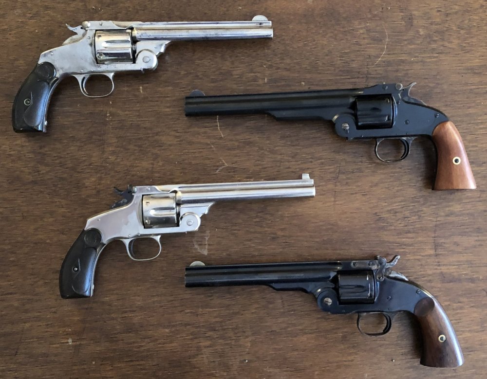

H. K. Uriah, SASS #74619 Posted July 20 Posted July 20 1 hour ago, Rooster Ron Wayne said: I have several number threes but. I'm still looking for a Beretta Laramie. Ditto, Wow, talk about an old thread resurfacing. Just for kicks, I have more Model 3's than I did 4 years ago when I posted what I have. Here's the updated collection... From top to bottom... Cimarron Uberti American, 45 Colt. S&W New Model 3, .38-44 Cimarron Uberti American .44 Special S&W New Model 3, .44-40 Navy Arms Uberti Schofield, .45 Colt. S&W Third Model Schofield .45 S&W. S&W Model 3 DA, .44-40. Still no Laramie or Russian. Would love to find one of each in .45 Colt, then I'll have all the replicas in the same caliber. I'd love to have a New Model 3 in .32-20. But, S&W never made them, and none of the reproduction makers do either. Oh well. I also have this... Looks like a New Model 3, right? Well, it isn't. This is a Model 1891 in 38 S&W. It's about 3/4 the size of a NM3, and is only a 5 shooter. There's also this.... This sorta looks like the model 3 DA, but is only about half the size, and is a .32 S&W. They called it the Double Action Fourth Model. They really got a lot of mileage out of this basic design. Quote
