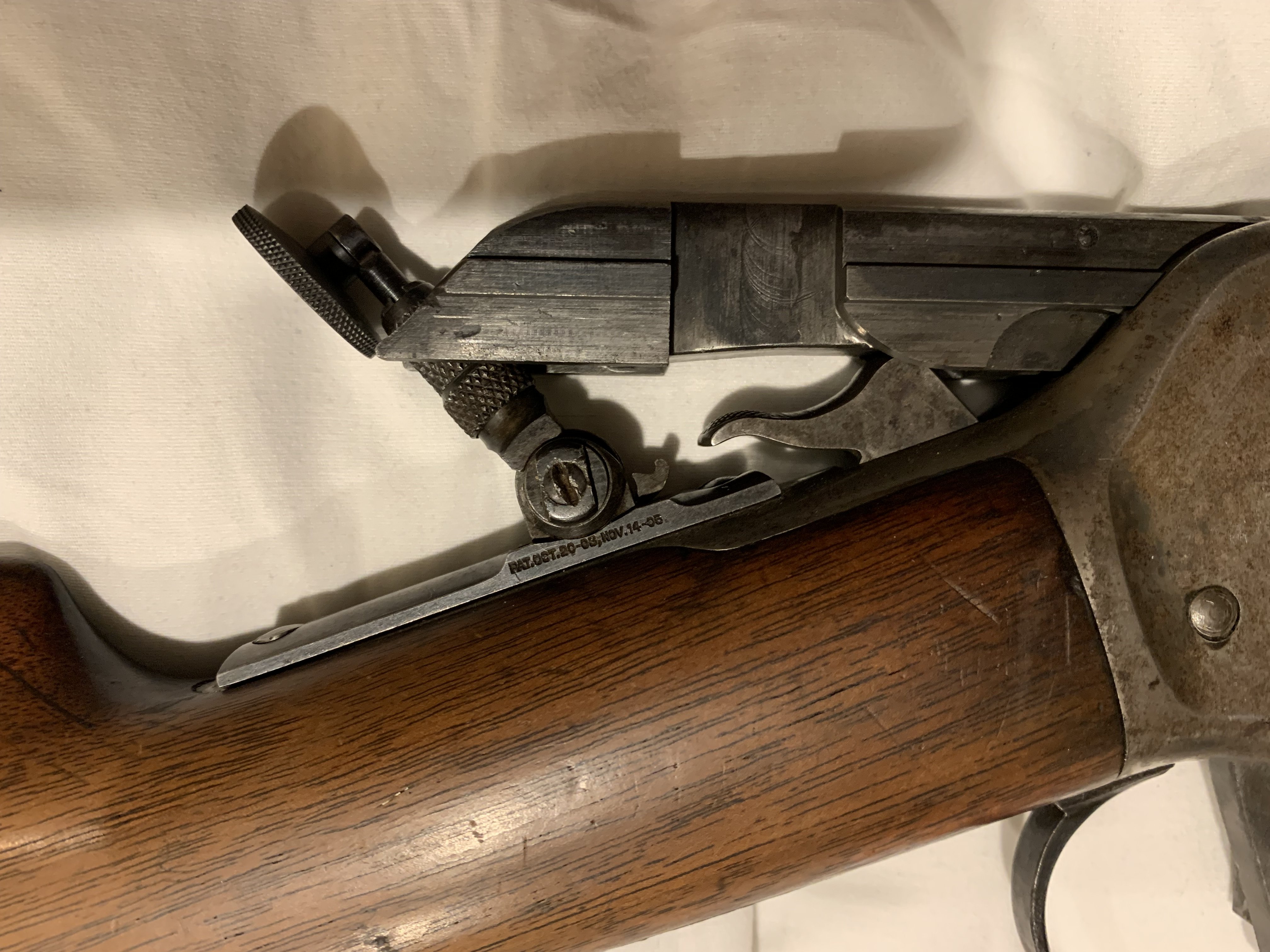

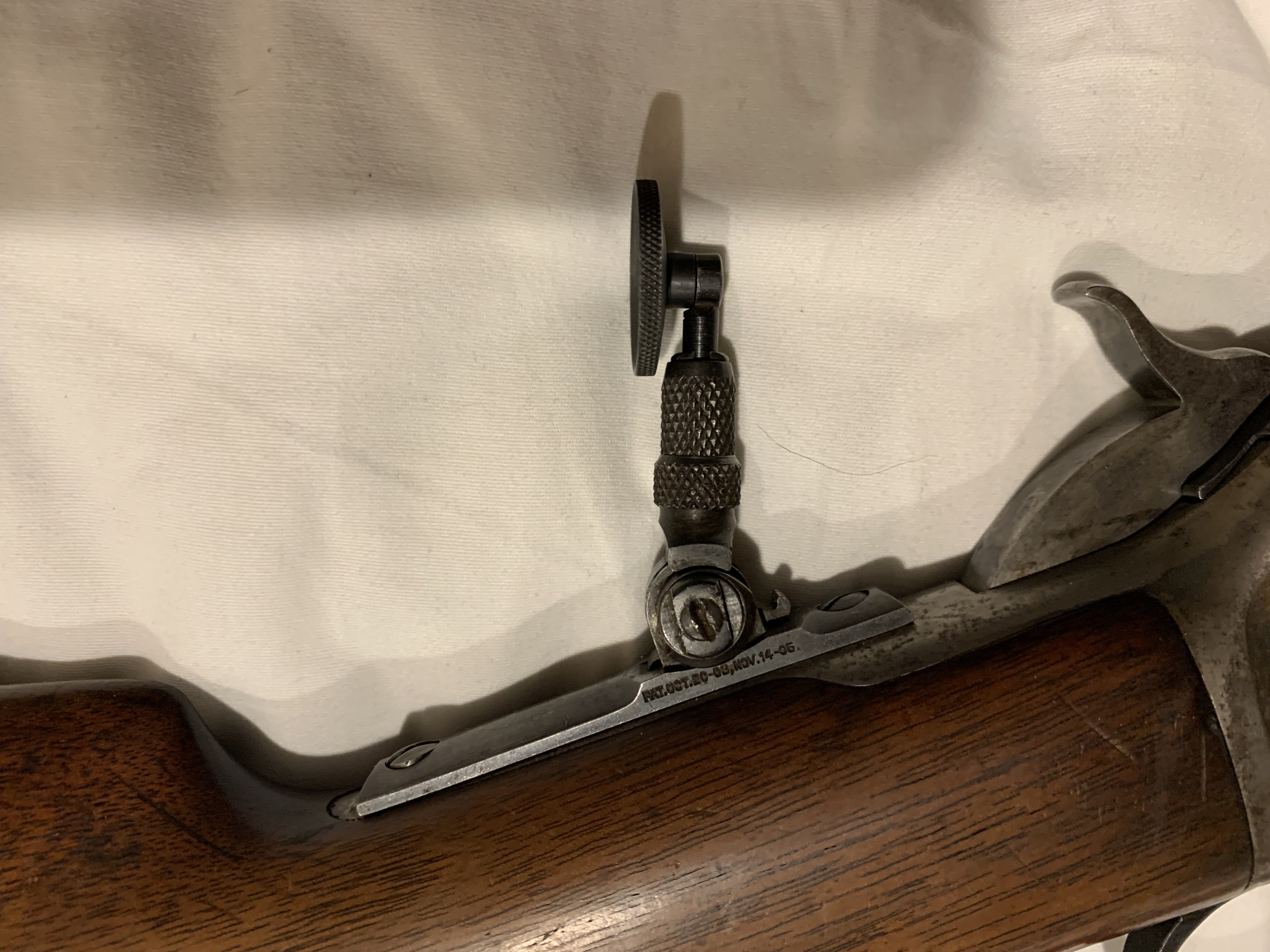

The Original Lumpy Gritz Posted December 27, 2021 Posted December 27, 2021 Might be the wrong base. Can you post pictures of this setup? OLG 1 Quote
Cholla Posted December 27, 2021 Author Posted December 27, 2021 Pictures added. I wonder if I could dis-assemble the sight and turn it around? It will need to be taller. Having never used one like this before I have a bit of a learning curve. Quote
Hoss Posted December 27, 2021 Posted December 27, 2021 (edited) 2 minutes ago, Cholla said: Pictures added. I wonder if I could dis-assemble the sight and turn it around? It will need to be taller. Having never used one like this before I have a bit of a learning curve. Does it only contact the eyecup? Maybe a smaller diameter eyecup, or none at all. Just use it without any aperture, just the ghost ring. Works well out to 150 or so. Edited December 27, 2021 by Hoss 1 Quote
Sedalia Dave Posted December 27, 2021 Posted December 27, 2021 43 minutes ago, Cholla said: Pictures added. I wonder if I could dis-assemble the sight and turn it around? It will need to be taller. Having never used one like this before I have a bit of a learning curve. Sight base is either backwards or the wrong one. The correct Lyman or Marbles sight would sit on the tang such that it would not be hit by the bolt. On my 92 it firs into the notch in the rear of the bolt. 2 1 Quote

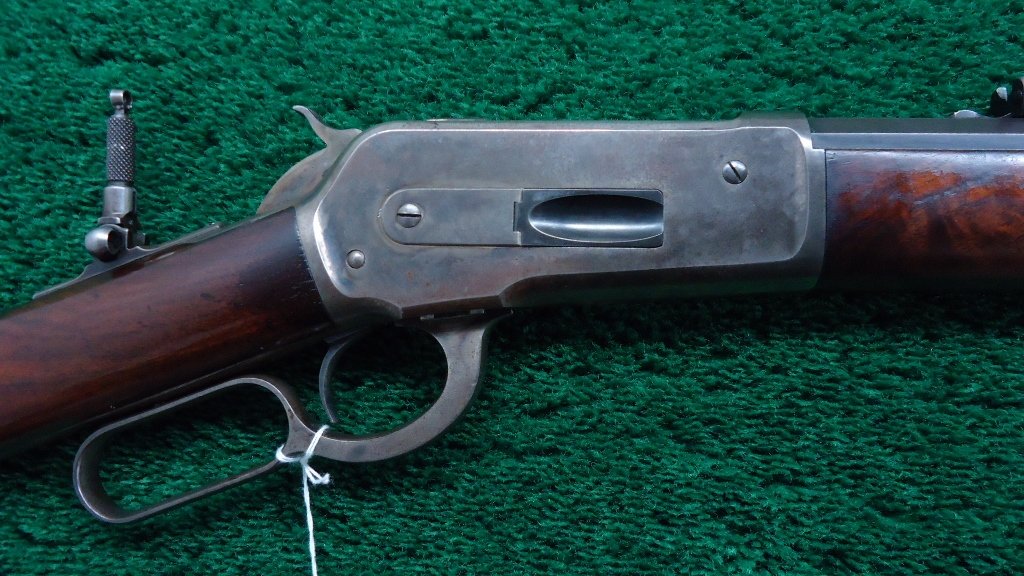

Sedalia Dave Posted December 27, 2021 Posted December 27, 2021 (edited) 9 minutes ago, Sedalia Dave said: Sight base is either backwards or the wrong one. The correct Lyman or Marbles sight would sit on the tang such that it would not be hit by the bolt. On my 92 it firs into the notch in the rear of the bolt. Blew up the picture and I'm betting it is the wrong sight for that rifle. IIRC disassembling a lyman sight base is not easy and I don't think they can be reversed. Here is a picture of what a correct base on an 86 looks like. Edited December 27, 2021 by Sedalia Dave 1 1 Quote
Cholla Posted December 27, 2021 Author Posted December 27, 2021 5 minutes ago, Sedalia Dave said: Blew up the picture and I'm betting it is the wrong sight for that rifle. IIRC disassembling a lyman sight base is not easy and I don't think they can be reversed. Here is a picture of what a correct base on an 86 looks like. http://images58.fotki.com/v279/photos/2/36012/10301736/P1030209-vi.jpg I am going to say you are correct. If I turned it around the screw holes would not be correct as one is smaller that the other. 1 Quote

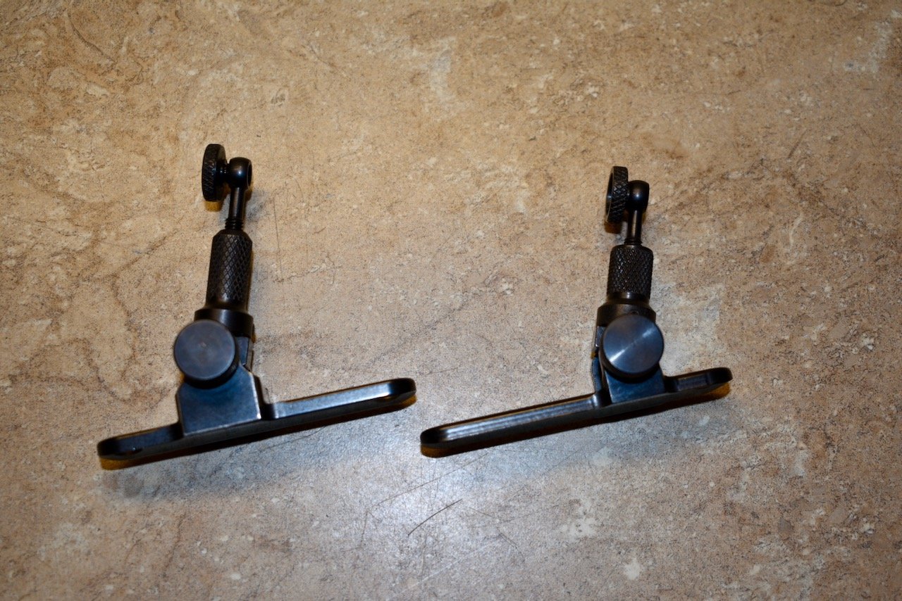

Larsen E. Pettifogger, SASS #32933 Posted December 27, 2021 Posted December 27, 2021 Wrong sight. You need one like on the left. 1 Quote
Gateway Kid SASS# 70038 Life Posted December 27, 2021 Posted December 27, 2021 Just saying pard but if you are going to get a Marbles sight before you decide which one I have a longer sight post (brand new) that you can have. (just have to find it) Pretty sure most of their tang sights are interchangeable but one of the LR guys could be more definitive. Regards Gateway Kid 1 Quote

Bailey Creek,5759 Posted December 30, 2021 Posted December 30, 2021 Take Sight of base. Turn Base around . See if Sight will work that way . In your picture looks like it should work . Quote
Sedalia Dave Posted December 30, 2021 Posted December 30, 2021 2 hours ago, Bailey Creek,5759 said: Take Sight of base. Turn Base around . See if Sight will work that way . In your picture looks like it should work . AFAIN the detent for the sight is not adjustable. So turning it around is not an option. Also it will put the sight too far rearward and make it too short. 1 1 Quote
Cholla Posted December 30, 2021 Author Posted December 30, 2021 I have a new sight coming from Buffalo Arms that is supposed to be the appropriate height for the 1886 and the cartridges they were built for. The posts are supposedly not interchangeable. 1 Quote
