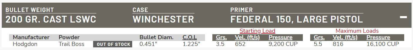

Chief Rick Posted December 25, 2021 Posted December 25, 2021 The Hodgdon Reloading Center website shows a max of 5.5 grains of Trail Boss with a 200 gr cast LSWC. 1 Quote
Abilene, SASS # 27489 Posted December 25, 2021 Posted December 25, 2021 1 hour ago, Chief Rick said: The Hodgdon Reloading Center website shows a max of 5.5 grains of Trail Boss with a 200 gr cast LSWC. Exactly. M.D. Smith pages pretty much mirror what the manufacturers data says. Quote

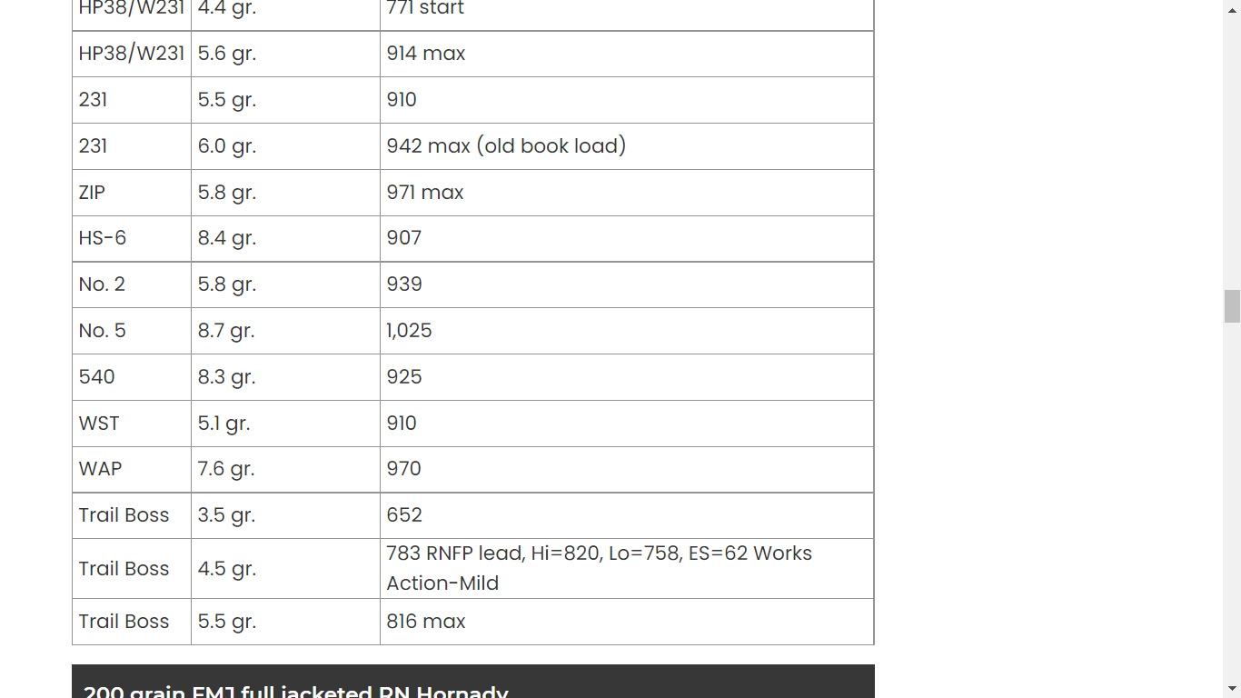

H. K. Uriah, SASS #74619 Posted December 26, 2021 Posted December 26, 2021 With a 200 grain bullet, I use 3.5 grains of Trail Boss. This will not cycle a 1911, but works great in shaved Webleys and other revolvers. Quote
