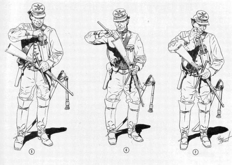

Rancho Roy Posted November 17, 2021 Posted November 17, 2021 I have an Armi 44-40....And a Blakeslee Box...Love shooting it at matches.....Hint: Barrel pointing slightly down to load....Barrel pointing slightly up to eject/unload....Won't jam if you do this.....I have a book on the Spencer with excerpts from soldiers that used it in battle.....This was their advise.
Sedalia Dave Posted November 17, 2021 Posted November 17, 2021 How a Blakeslee box is was intended to be worn.
