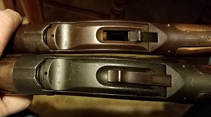

I have a very early 1901,shoot it now and then ,curious why they made the finger lever 2 piece ?
wiki intimates that it and the lever safety have something to do with each other, Not that I can tell unless it's after the safety 'button' goes into it's hole in the lever,and magic occurs in there ?
f..AHA,further examination reveals that the tip of the safety is broken off. mystery solved.

    The 2 piece lever was added to keep the lever up and closed until the shooter wanted to open it. The 1 piece 87 lever can pop open once the gun has some wear on it and the action gets a little loose.  The safety on an 87 is what looks like a fishhook barb on the back side at the bottom of the trigger. That goes into a small hole when the lever is closed. A properly tuned 87 will not fire until the lever is completely closed. ( Talking about real 87s and the Chiappa and Cimarron copies not the IAC or CAI copies.)
