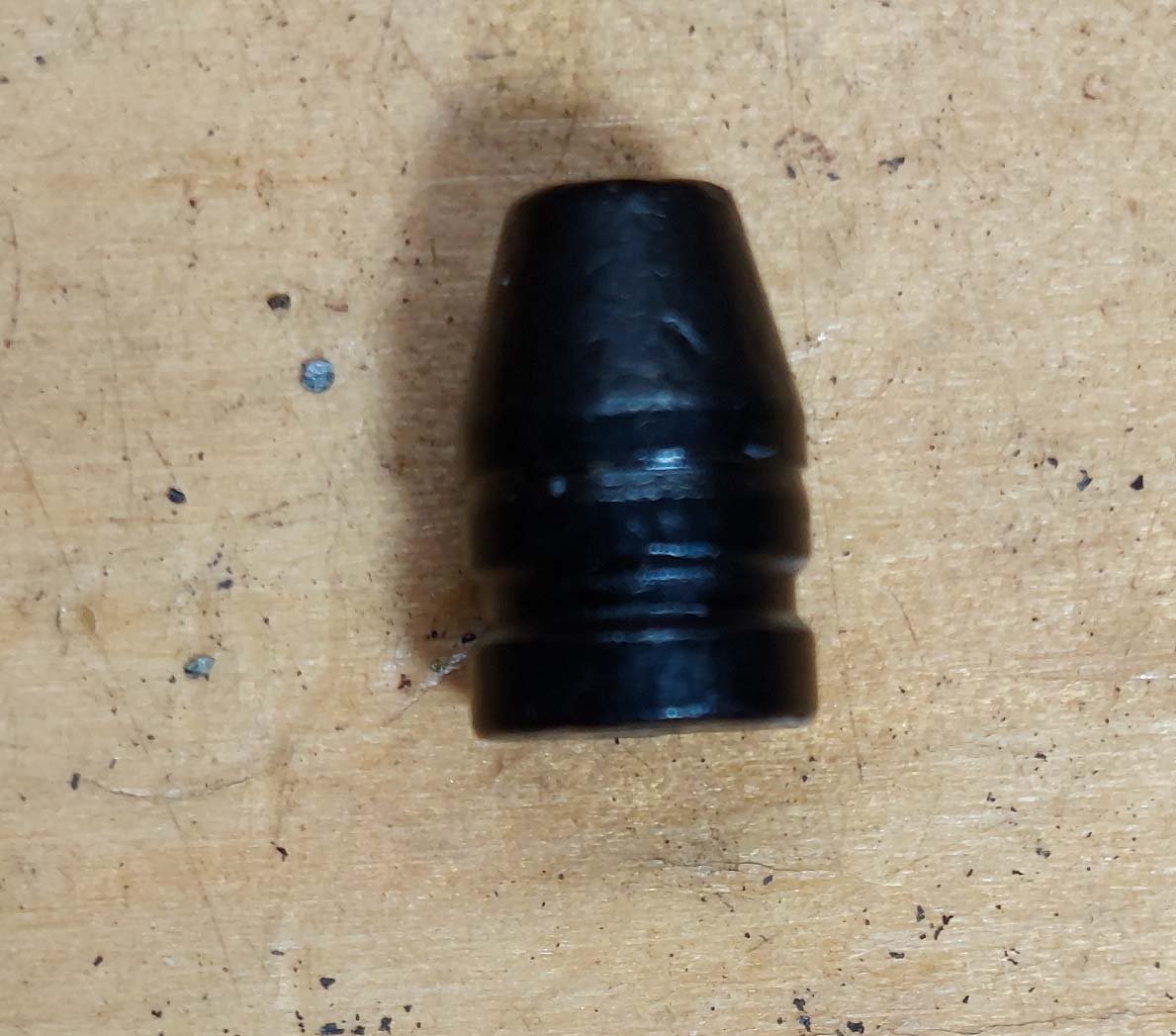

Sorry to ask mate, but is there any chance you can post a photo of the 125gr pill you use and a photo of a loaded round?
I'll get pics up tomorrow

Left to right
140 gr .357, OAL = 1.555", 39.5 mm
125 gr 38 Spcl, OAL  = 1.519", 38.58 mm
158 gr 38 special, OAL = 1.508", 38.30 mm
125 gr Hy-Tek OAL = 0.556", 14.12 mm

17 minutes ago, Sedalia Dave said:
Left to right
@Sedalia Dave Thanks so much for going to that trouble mate.....super appreciated thank you!!!!
