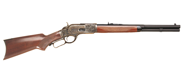

Abilene, SASS # 27489 Posted April 20, 2021 Share Posted April 20, 2021 Have you thought of a Texas Brush Popper? 18.5" half round pistol grip. Close enough? Link to comment Share on other sites More sharing options...
Captain Clark Posted April 20, 2021 Share Posted April 20, 2021 1 hour ago, Abilene, SASS # 27489 said: Have you thought of a Texas Brush Popper? 18.5" half round pistol grip. Close enough? Heck, I want one of those now Link to comment Share on other sites More sharing options...
Yohan Posted April 21, 2021 Share Posted April 21, 2021 that is the same rifle both my wife and I shoot. awesome little rifle Link to comment Share on other sites More sharing options...
