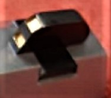

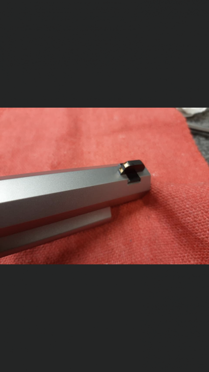

Doc Hurd #12379 Posted November 6, 2020 Posted November 6, 2020 Is a front sight like below approved for use in SASS matches?
Goody, SASS #26190 Posted November 6, 2020 Posted November 6, 2020 Yes, if the white portion on the rear of the sight is just a glare, the sight would be legal in any category that allows adjustable sights.
PaleWolf Brunelle, #2495L Posted November 6, 2020 Posted November 6, 2020 (edited) Not if those are colored inlays. Edited November 6, 2020 by PaleWolf Brunelle, #2495L edit txt
Three Foot Johnson Posted November 6, 2020 Posted November 6, 2020 Huh... I thought it was glare. Looks like a "dual elevation" sight. 1
Abilene, SASS # 27489 Posted November 6, 2020 Posted November 6, 2020 Dovetailed sights are also legal on Cap'n'ball or opentop/conversion revolvers in fixed sight categories. (Also page 37 SHB) 1
Doc Hurd #12379 Posted November 6, 2020 Author Posted November 6, 2020 Thanks everyone! The information I was reading about these sites stated the inlays were gold.
McCandless Posted November 6, 2020 Posted November 6, 2020 10 hours ago, PaleWolf Brunelle, #2495L said: Not if those are colored inlays. I would ask for an external modification approval before I invested a lot of time (and/or money), into these sights; and for what category. Getting an opinion from some folks on the Wire has no bearing if the modified sights are challenged.
PaleWolf Brunelle, #2495L Posted November 6, 2020 Posted November 6, 2020 (edited) Quote Rear and front sights may be “blacked,” painted, or plated in the colors of the previously listed materials. If blacking, paint, or plating is applied to a revolver front sight, it must cover the entire rear surface of the sight to give the appearance of a solid material. SHB p.36 Quote Beaded post front sights or inserts are not allowed. SHB p.37 (2x) Edited November 6, 2020 by PaleWolf Brunelle, #2495L 1
