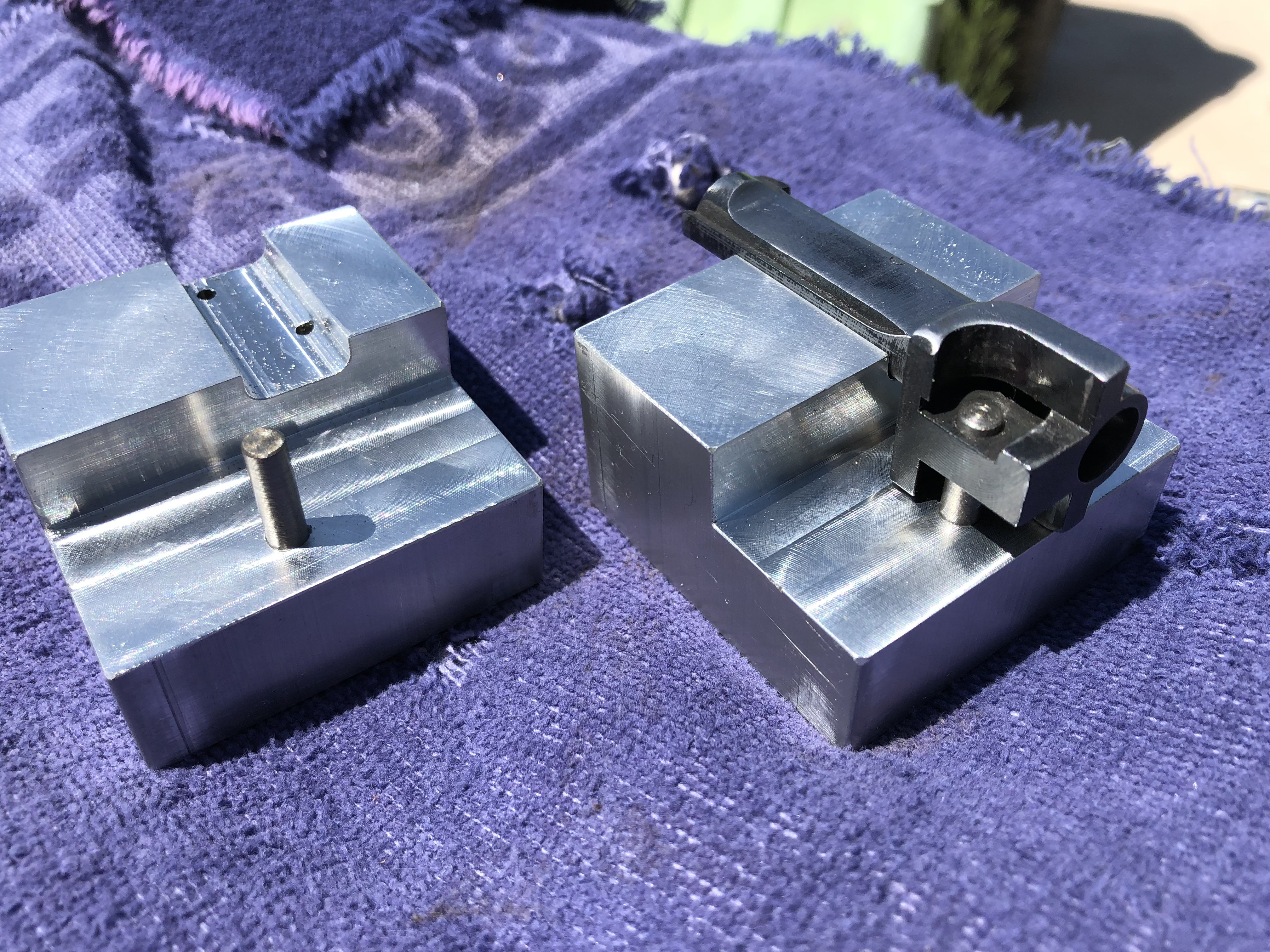

I use a Bolt Bench Block to hold the bolt for removal of pins.
VERY nice fixture.  And great picture.  I'll be making one shortly.
OK, ya got me. Where do you get them bad boys at?
Sent you a PM
