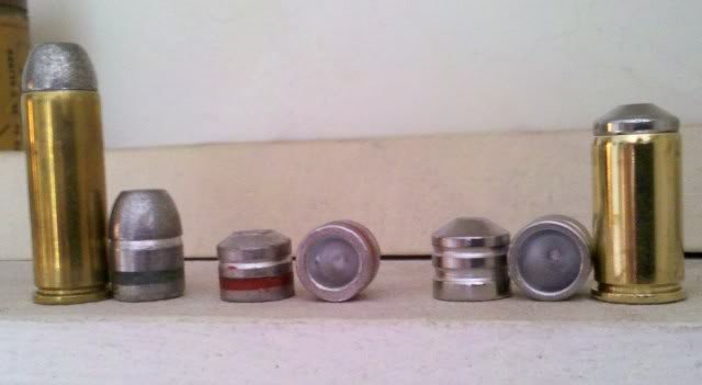

Navy Davey Posted February 7, 2020 Posted February 7, 2020 4 hours ago, Roscoe Regulator said: What bullet weight is that? p.s. So I calculated that you are referring to 200gr bullets, which is heavy for 45CS but would contain the velocity while likely offering more recoil than some are experiencing with 180 or 160. I see data in Lyman for a 160 that with a minimum load of W231/HP38 the power factor would be about 152. I have it loaded to test 15 rounds but expect that it is more power than SASS shooters are typically using in this cartridge. I already tried 3 grains of Trailboss with 160 bullets and thought that was just too much of a pop gun load. I also realized that Trailboss has no justification in this case size. Correct 200 gr sorry I did not state that. I would cast lighter as soon as Lee makes. 6 round mold (I'm spoiled) Quote
Four Eyes Henry Posted February 7, 2020 Posted February 7, 2020 like these ?... http://www.biglube.com/BulletMolds.aspx?ItemID=8ea1b8fc-d133-4c8d-83d9-20b3e2959d21 Quote
Roscoe Regulator Posted February 7, 2020 Author Posted February 7, 2020 (edited) 7 hours ago, Four Eyes Henry said: like these ?... http://www.biglube.com/BulletMolds.aspx?ItemID=8ea1b8fc-d133-4c8d-83d9-20b3e2959d21 http://www.biglube.com works but not with the rest. Could you suggest which mold to select on that page? Maybe this, that works with 45CS smokeless cartridges. Edited February 7, 2020 by Roscoe Regulator Quote
Four Eyes Henry Posted February 7, 2020 Posted February 7, 2020 (edited) I've only used roundball in cartridges to get POA/POI with my Pietta 1858 conversion like with the percussion cilinder, that, more or less, worked. For a long time now I'm using the J/P 200 in my 45 CS and 45 Colt with 18 grains blackpowder (cous cous as a filler for 45 Colt) I have a Lyman sizer and Pacific 45 ACP dies for the 45 CS. The sizer die is a litlle bit bigger then standard, so I get straight wall cartridges. Edited February 7, 2020 by Four Eyes Henry Quote
Garrison Joe, SASS #60708 Posted February 7, 2020 Posted February 7, 2020 (edited) 13 hours ago, David Richert said: 200 gr sorry I did not state that. I would cast lighter as soon as Lee makes. 6 round mold Tom at Accurate Molds will make a mold for you in a week that drops a 175 grain .452 bullet that I designed specifically for the Cowboy .45 Special. It has a big enough lube groove to work with BP, and I have shot a few hundred like that, but normally I cast an 8 Brinnell slug with that mold for smokeless loads. That mold design (45-175B) is a truncated cone with no crimp groove. If you cast soft, you can roll crimp easily right into the broad driving band anywhere you want the length (cartridge OAL) to come out. I know they will make a 3 cavity aluminum mold, and perhaps even a 4 cavity one. And the Accurate mold will cast more accurately and last MUCH longer than the Lee mold - from my several tests. And, no, I get no royality or kickback if you buy a mold. Tom is just a great mold maker and wonderful resource for casters! Good luck, GJ Edited February 7, 2020 by Garrison Joe, SASS #60708 1 Quote
