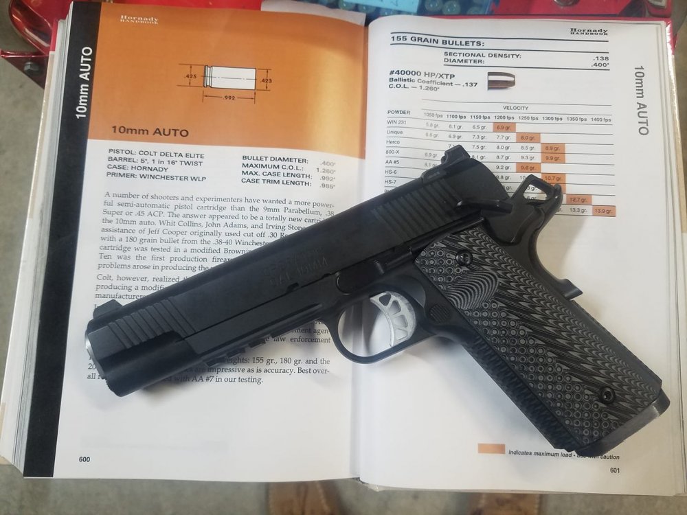

Thanks for the update.  I found a box of 165 grain FMJ under a bench this weekend.  I think a few will get loaded this week.
Love my TRP 10mm.
