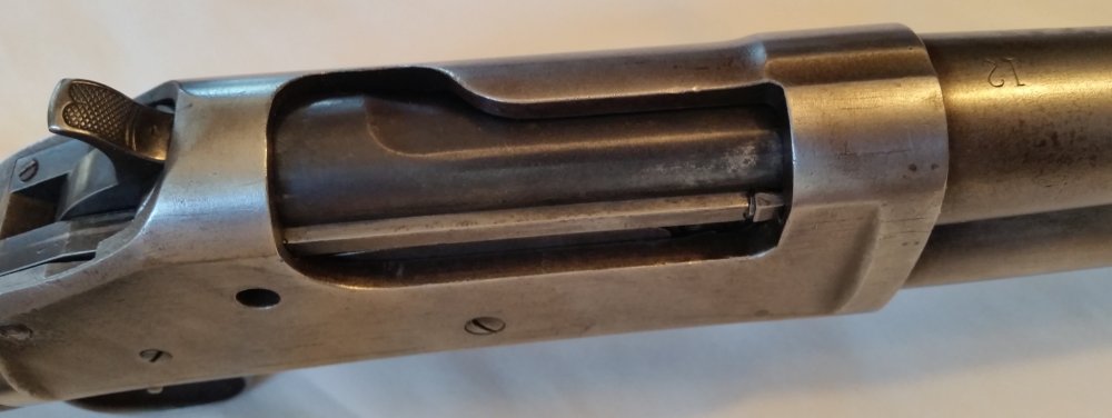

Just Bill SASS# 16394 Posted April 30, 2019 Posted April 30, 2019 Here is a view of the ejection port of the Winchester 1893 shotgun. It is the large cutout which contributed to the weakness of the action. One of the other improvements with the 97 was a button on the side to release the action to work the slide without the hammer being let down.
