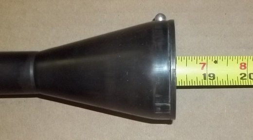

Three Foot Johnson Posted March 2, 2019 Posted March 2, 2019 I had an old single shot Davenport shotgun with a damaged barrel, so I got creative and made a blunderbuss out of it. External mod, so not legal for CAS, but they let me shoot it at the occasional monthly. Bonus points if you can guess what the cone is made from.
Tyrel Cody Posted March 2, 2019 Posted March 2, 2019 6 minutes ago, J Bar Binks, #47015 said: I had an old single shot Davenport shotgun with a damaged barrel, so I got creative and made a blunderbuss out of it. External mod, so not legal for CAS, but they let me shoot it at the occasional monthly. Bonus points if you can guess what the cone is made from. Neat! Nozzle off a fire extinguisher?

Sedalia Dave Posted March 3, 2019 Posted March 3, 2019 21 hours ago, J Bar Binks, #47015 said: Bonus points if you can guess what the cone is made from. Objective from an old rifle scope.
Charlie Harley, #14153 Posted March 3, 2019 Posted March 3, 2019 On 3/1/2019 at 11:53 PM, J Bar Binks, #47015 said: I had an old single shot Davenport shotgun with a damaged barrel, so I got creative and made a blunderbuss out of it. External mod, so not legal for CAS, but they let me shoot it at the occasional monthly. Bonus points if you can guess what the cone is made from. No guess, but that’s a cool piece right there.
grey ghost Posted March 3, 2019 Posted March 3, 2019 My original thought was a mag light I think it might be that mortar now though
