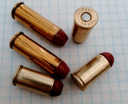

Patagonia Pete Posted April 23, 2019 Posted April 23, 2019 2 minutes ago, Tequila Chase said: Is that in a .45 Colt? Do you worry about squibs with that amount of powder? I'm asking because I just loaded 5.0 gr. of TB with 200 gr RNFP but was leery about going lower. 45 Cowboy Special is the same size as a 45ACP but w/ a rim. Here is a photo of 45 Colt beside 45 Cowboy Special ... Quote
Tequila Shooter Posted April 23, 2019 Posted April 23, 2019 I'm sorry I didn't realize he was talking about the Cowboy Special round. I'm nervous about getting below 5.0 gr. I don't want to get a squib, I'd rather deal with a little more recoil. Quote
Patagonia Pete Posted April 23, 2019 Posted April 23, 2019 1 minute ago, Tequila Chase said: I'm sorry I didn't realize he was talking about the Cowboy Special round. I'm nervous about getting below 5.0 gr. I don't want to get a squib, I'd rather deal with a little more recoil. Figured that was what you were thinking ... don't blame you. But ... (IMHO) these things are pretty cool in revolvers ... Every time I used to push the limits (low limits) for the regular 45 Colts in the revolvers I would pay ... These guys seem to stay consistent/reliable even w/ lightly loaded. Makes 45 caliber revolvers "really" viable if that's what you already have. The first time I tried them I laughed and had to sit down ... Quote
Tequila Shooter Posted April 23, 2019 Posted April 23, 2019 11 minutes ago, Patagonia Pete said: Figured that was what you were thinking ... don't blame you. But ... (IMHO) these things are pretty cool in revolvers ... Every time I used to push the limits (low limits) for the regular 45 Colts in the revolvers I would pay ... These guys seem to stay consistent/reliable even w/ lightly loaded. Makes 45 caliber revolvers "really" viable if that's what you already have. The first time I tried them I laughed and had to sit down ... I thought about using them but then I'd have to load and carry different rounds for pistol and rifle. Not only am I slightly lazy, I don't trust myself to make sure that I have enough for an extended shoot. Think I'll just stick with the LC and be happy. Quote
