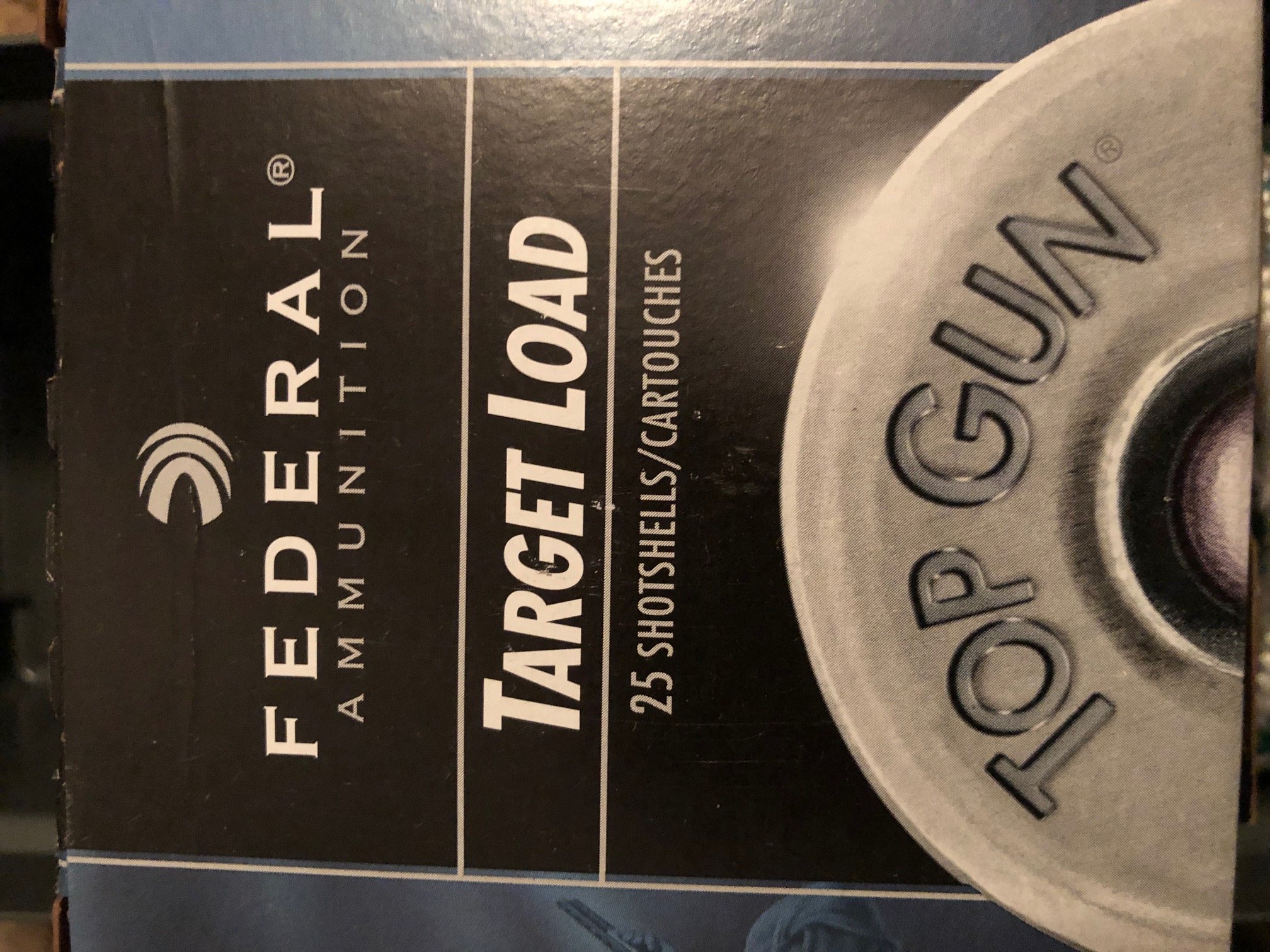

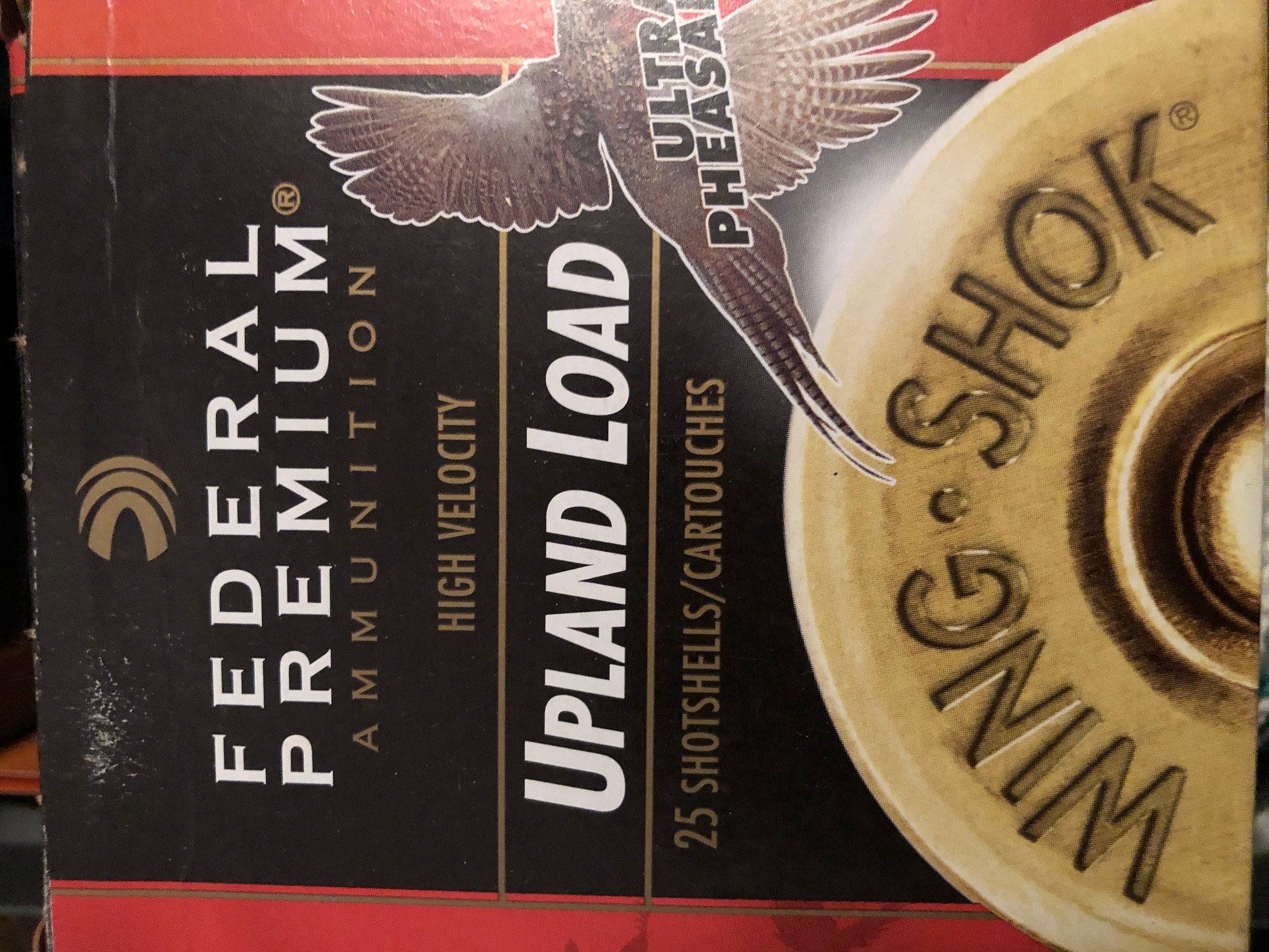

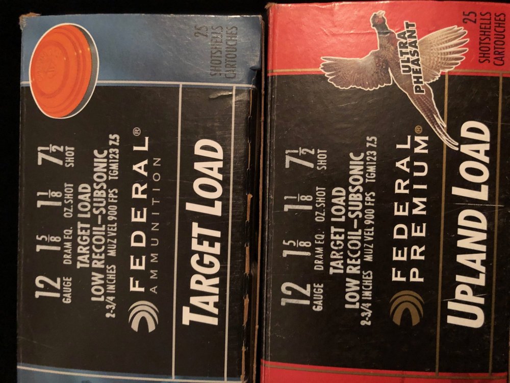

Chuck Steak Posted December 18, 2018 Posted December 18, 2018 I put my hands on a couple of boxes of Federal Low Recoil-Subsonic 12guage Target Loads. I am wondering if there are any shooters out there that have used this ammo for CAS. Did you like it? Could you tell a difference? As you can tell from the pictures, it is an 'odd-duck' of sorts. One box is marked as Target Loads and the other box is marked as High Velocity, Upland Load, Ultra-Pheasant. They are high-brass shells and the specs on BOTH boxes show a muzzle velocity of 900 FPS so I dont know why Federal would label one of them as "High Velocity" just because they had a bird on the box. . Quote

Tex Jones, SASS 2263 Posted December 18, 2018 Posted December 18, 2018 They used to be called Metro loads, presumably because they could be used in indoor ranges in or near built up areas. I have shot them in a '97 and they are OK. Packaging is a little confusing, but the description on the cartridge is correct. Quote

Dusty Boddems Posted December 19, 2018 Posted December 19, 2018 (edited) The 1 1/8 is a great load for WB, runs excellent out of mod 12 and 97’s. Dusty B you know looking at this a little more I think they just used the wrong box with the pheasant on it. Edited December 19, 2018 by Dusty Boddems Quote
