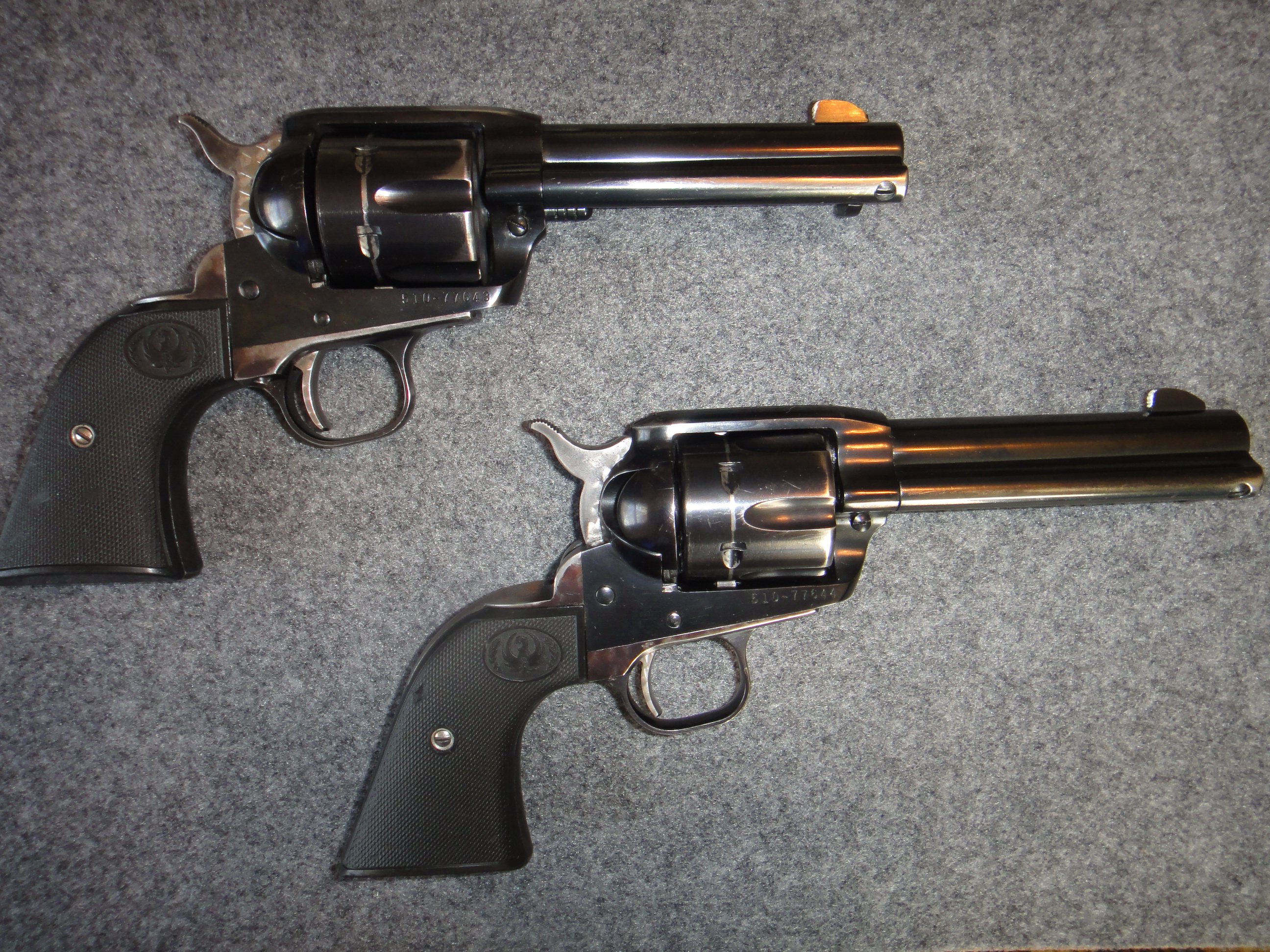

Driftwood Johnson, SASS #38283 Posted November 25, 2018 Posted November 25, 2018 Howdy It took me a little bit to understand what you were asking about. Yes. The bolt is designed to pop up on a Ruger a bit earlier than on a Colt or clone. This means it will leave a partial ring. Ruger designed them this way on purpose to make sure the cylinder did not throw by. It never bothered me much. This New Vaquero has only been shot a little, but it is developing a ring. This stainless 'original model' Vaquero has been shot quite a lot. The partial ring never bothered me. I bought this Blackhawk brand-spanky new in 1975. The ring has never bothered me much. A ring was common on the Three Screws too.

Bramble Mountain Buzzard Posted November 27, 2018 Posted November 27, 2018 I have Old Model Rugers that have NO ring on them. I have a pair of 1950's Flattops that are my main match guns and have almost no ring with thousands of round thru them. The secret is to ALWAYS take to full cock before letting the hammer down. The 50's and early 60's Rugers were timed correctly. Because the transfer bars in the New Models and Old Models with the "safety conversion" required a lot more work at the factory to time correctly, Ruger opted to have the cylinder lock drop early. Hence the Ruger ring.
