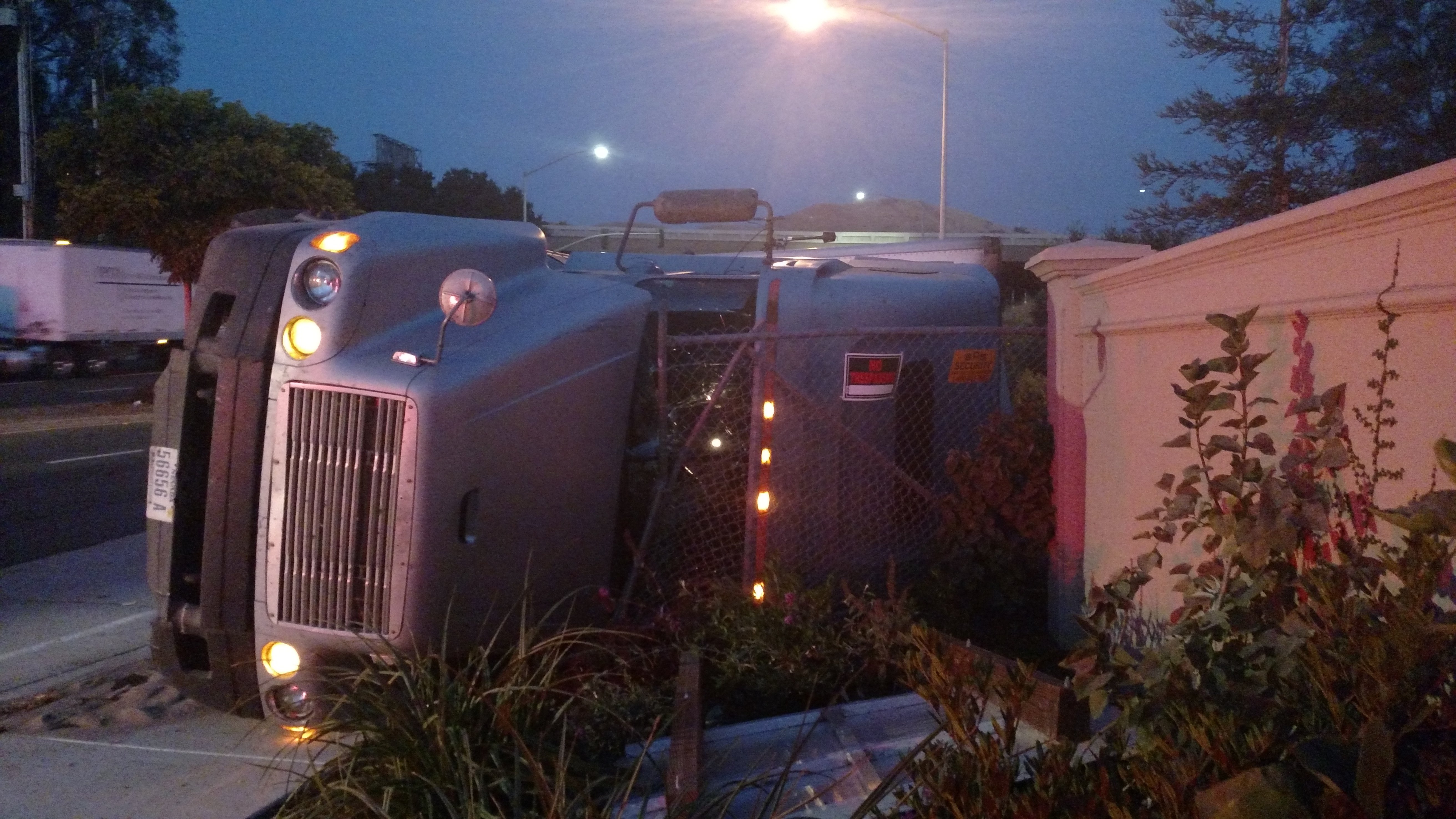

The Shoer 27979 Posted May 26, 2018 Posted May 26, 2018 17 hours ago, Noz said: I currently am driving a F250 V10. The only reason I own it is for the occasional venture with my 38 foot 5800 travel trailer. I can't affor two trucks and I am getting real tired of muscling the beast around. I am well aware of the idea that most pickups with any kind of V8 can pull the trailer but it takes a 3/4 ton to stop one. Is this indeed true if the trailer has working brakes? Noz Remember this picture when you start thinking about brakes. This was a mechanical failure of my brakes on that truck. I had a choice to ether make a hard right that I was going to fast for(because of mechanical failure ) or taking out 5 occupied cars Quote
