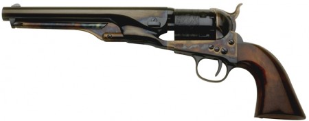

Goody, SASS #26190 Posted January 11, 2018 Posted January 11, 2018 The best of both worlds. The sleek lines of the 60 Army, the grip and 36 caliber of the 51 Navy. http://www.taylorsfirearms.com/hand-guns/blackpowder-revolvers/1851-1861-navy-collection/1861-navy-steel-4767.html Quote
