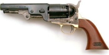

Sgt. Saywut Posted January 8, 2018 Posted January 8, 2018 My next pair of pistols will likely be Bisley Vaqueros, but I’m digging the appearance of the 1851 Navy Sheriff’s Model: I understand this is a BP pistol, and there are conversion cylinders available for centerfire cartridges. If I understand correctly also, such a conversion needs to take into consideration the barrel being sized for .36 caliber (or .44 caliber) bullets. Is there a pistol in this configuration that’s available from the factory ready to go, in smokeless 38 Special?

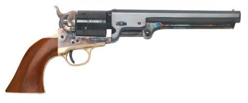

John Henry Quick Posted January 8, 2018 Posted January 8, 2018 29 minutes ago, Sgt. Saywut said: My next pair of pistols will likely be Bisley Vaqueros, but I’m digging the appearance of the 1851 Navy Sheriff’s Model: I understand this is a BP pistol, and there are conversion cylinders available for centerfire cartridges. If I understand correctly also, such a conversion needs to take into consideration the barrel being sized for .36 caliber (or .44 caliber) bullets. Is there a pistol in this configuration that’s available from the factory ready to go, in smokeless 38 Special? Blasphemy! Taylor's will sell you a conversion cylinder for the Pietta .36 to fire 38 LC, but there is no conversion for the .44.
Goody, SASS #26190 Posted January 8, 2018 Posted January 8, 2018 There are factory conversions with hex barrels and the proper bore dimensions for 38sp. http://www.taylorsfirearms.com/hand-guns/cartridge-revolvers/c-mason-revolver/c-mason-revolver-1851-navy.html
Abilene, SASS # 27489 Posted January 8, 2018 Posted January 8, 2018 33 minutes ago, Sgt. Saywut said: ...Is there a pistol in this configuration that’s available from the factory ready to go, in smokeless 38 Special? Yes. Uberti 1851 Richards-Mason conversion. Available with 7 1/2", 5 1/2", and 4 3/4" barrels. .38 Special smokeless or BP.
Tyrel Cody Posted January 8, 2018 Posted January 8, 2018 1 minute ago, Abilene, SASS # 27489 said: Yes. Uberti 1851 Richards-Mason conversion. Available with 7 1/2", 5 1/2", and 4 3/4" barrels. .38 Special smokeless or BP. Octagon barrels?
Abilene, SASS # 27489 Posted January 8, 2018 Posted January 8, 2018 1 minute ago, Tyrel Cody said: Octagon barrels? Yes. Cimarron calls them 1851 Richards-Mason conversions, Taylors calls it C.Mason conversions.

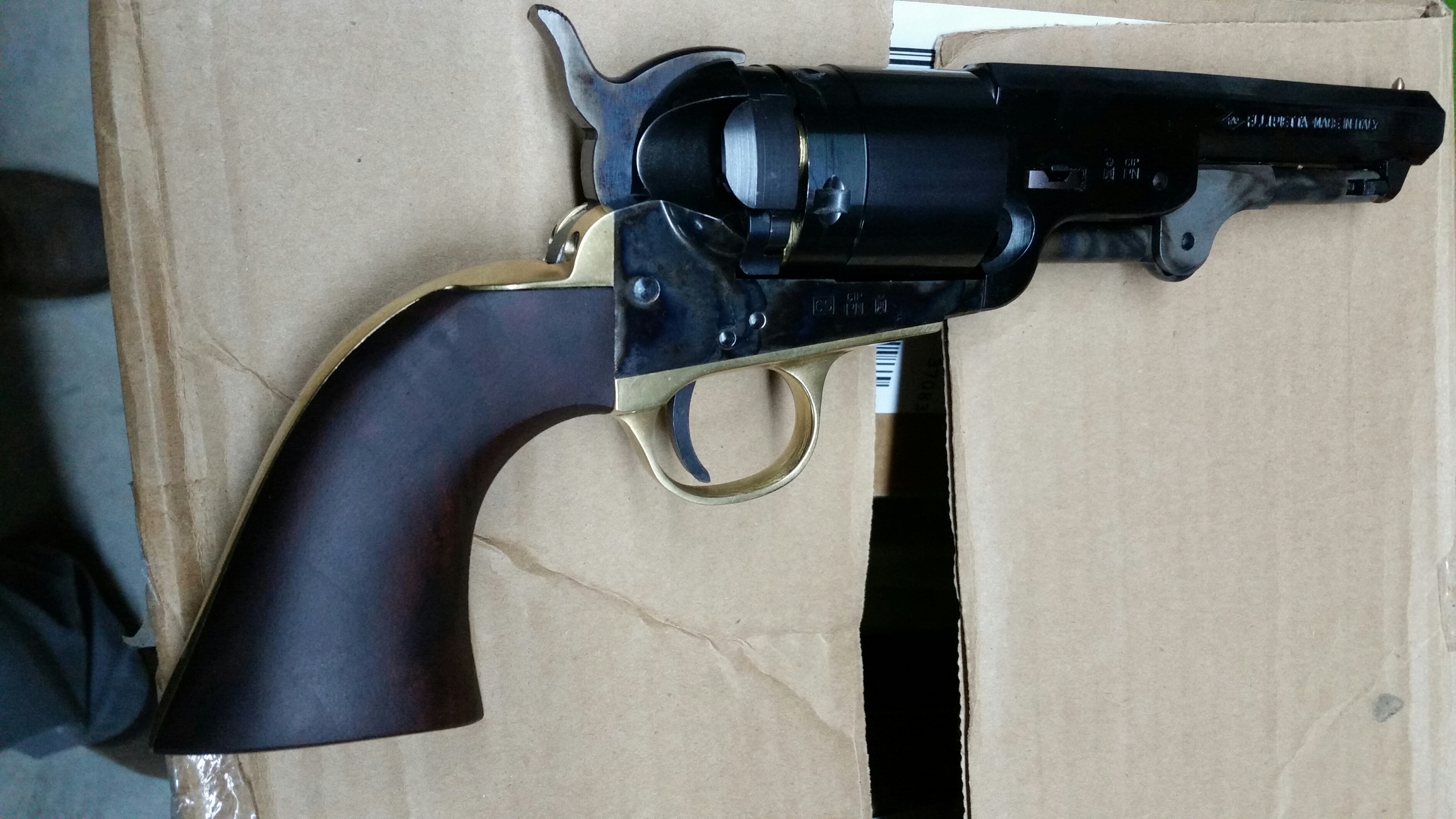

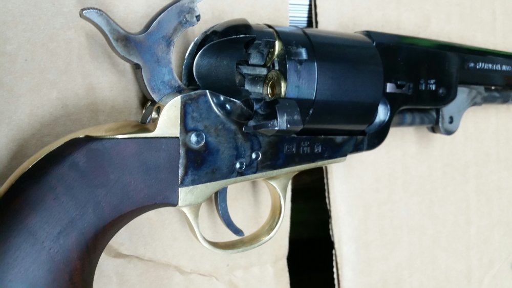

Rancho Roy Posted January 8, 2018 Posted January 8, 2018 Very easy to do your own conversion. Here is a pair I've been shooting for a few years now. These have the longer, blued "london" grip which really fill your hand... Here is an article I wrote for a black powder magazine a while ago: http://rvbprecision.com/shooting/1860-colt-army-sheriff-models.html These are set up for 45ACP or 45 Cowboy Special...... The loading ram has now been removed and ejector rod installed. Need to update the picture.
Tyrel Cody Posted January 8, 2018 Posted January 8, 2018 13 minutes ago, Rancho Roy said: Very easy to do your own conversion. Here is a pair I've been shooting for a few years now. These have the longer, blued "london" grip which really fill your hand... Here is an article I wrote for a black powder magazine a while ago: http://rvbprecision.com/shooting/1860-colt-army-sheriff-models.html These are set up for 45ACP or 45 Cowboy Special...... The loading ram has now been removed and ejector rod installed. Need to update the picture. You need to make and sell hammers with the fix you did in one of those blog posts
Rancho Roy Posted January 8, 2018 Posted January 8, 2018 Quote You need to make and sell hammers with the fix you did in one of those blog posts Yes, one of the problems with the Pietta is they are made out of " hard cheese "...... VERY soft metals.

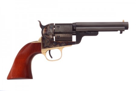

Sgt. Saywut Posted January 9, 2018 Author Posted January 9, 2018 4 hours ago, John Henry Quick said: Blasphemy! Taylor's will sell you a conversion cylinder for the Pietta .36 to fire 38 LC, but there is no conversion for the .44. Yeah yeah The 5” version of this one actually looks the closest to the Sheriff’s Model I posted, so it’s definitely promising. On a related note, are there any lowered hammers readily available for the 1851 Navy to facilitate one-handed shooting? Or will that have to be done by a gunsmith with TIG equipment? Also, with the conversion cylinder, is loading / unloading similar to that in a SAA Colt / Vaquero?
