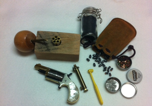

Abilene Slim SASS 81783 Posted December 30, 2017 Posted December 30, 2017 (edited) Well I'll be! I never knew my reloading stand was a display stand. Note that it will hold your pistol muzzle up for easy storage. https://www.midwayusa.com/product/784675/traditions-black-powder-revolver-display-stand Edited December 30, 2017 by Abilene Slim SASS 81783 Quote
