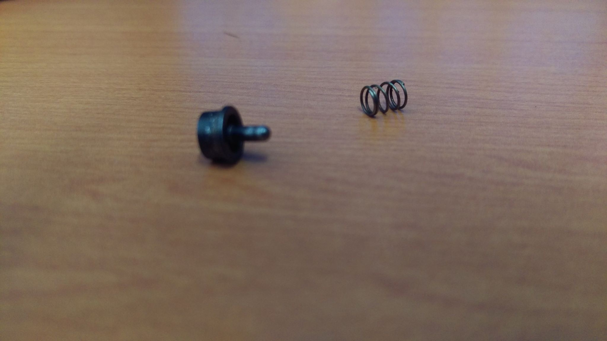

Jackaroo, # 29989 Posted November 23, 2017 Posted November 23, 2017 Anyone know who supplies or makes Baikel sxs firing pins? Model 43

LQ Jones Posted November 23, 2017 Posted November 23, 2017 They are part of the hammer assembly(integral) and non replaceable. LQ
Hoss Posted November 24, 2017 Posted November 24, 2017 Jackaroo, I had an issue with my Bakail, left barrel would not fire about 1/2 of the time. I cleaned it, no help. Was thinking it may be a firing pin problem, but discovered no pins available. I had the reciever off and put the whole thing in my sonic cleaner. Big cloud of crud came out. Ran it thru couple of cycles, oiled it up, and presto, problem fixed! Unless you just know it’s a broken pin try this before giving up on the Shotgun.

Johnny Meadows,SASS#28485L Posted November 25, 2017 Posted November 25, 2017 On 11/23/2017 at 4:51 PM, LQ Jones said: They are part of the hammer assembly(integral) and non replaceable. LQ In the single trigger Baikals the firing pin is separate from the hammer. The one piece hammer can be fixed by a good machinist or gunsmith. Parts for purchase are extremely hard to find. Thanks, Johnny M.
