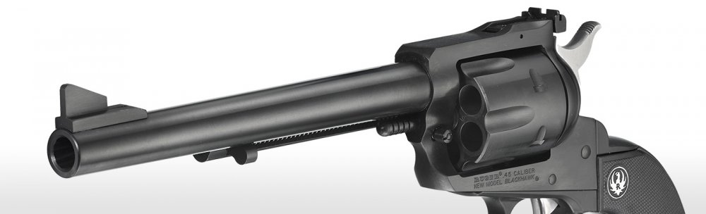

Larsen E. Pettifogger, SASS #32933 Posted September 5, 2017 Posted September 5, 2017 New Model Blackhawks have a ramped from sight. Out of curiosity why do you want to replace it? replace it with what? This is a New Model Blackhawk front sight. If it were me I would mill off the old blade, mill a slot in the base and solder in a new blade. Quote
